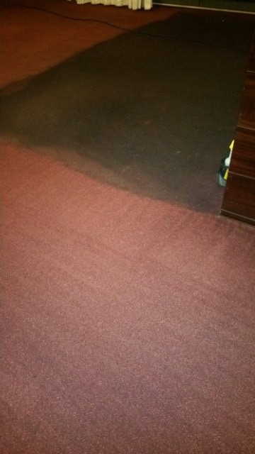

1200 psi is as high as you can go on a portable.
Chemistry and agitation will be your best friend, and makes T&G possible even without 1200 psi.
Even though you think you see a demand for T&G, there will always be a bigger demand for carpet, rugs, and upholstery, which can be a pain in the ass with a HEAVY 1200 psi unit.
Most porty operators bread'n'butta unit should be geared for carpets and other more popular services which will always be generating the most income.
Although you see the need, don't count on doing too much T&G to begin with.
It's often less than most think it will be.
1200 psi units are HEAVY, with mediocre vacuum, and susceptible to blowing circuit breakers.
Consider a 500psi adjustable unit, and a 175 rotary for scrubbing T&G.
Cleaning this Steakhouse last night was only possible because of a 175 rotary and the right chemistry.......................
Best of both worlds as a 175 rotary will always be your best friend whether T&G or carpet.
