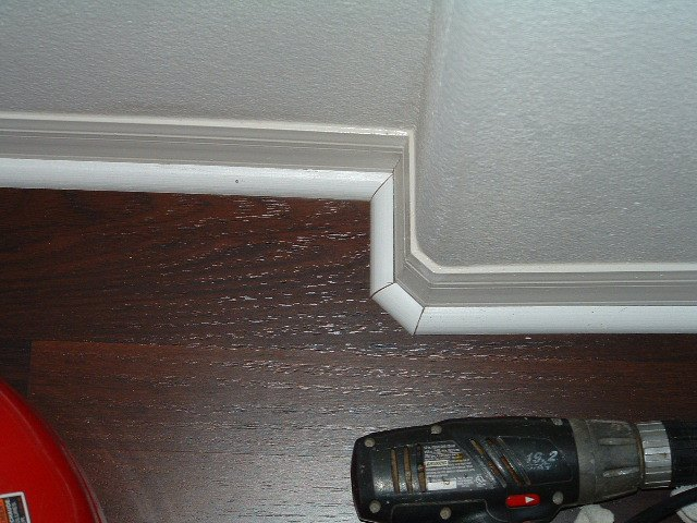

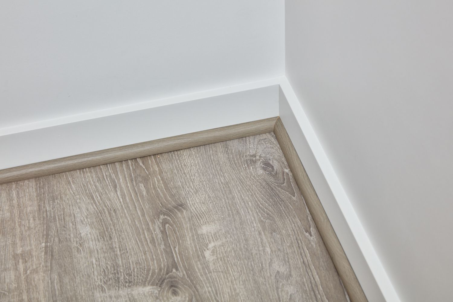

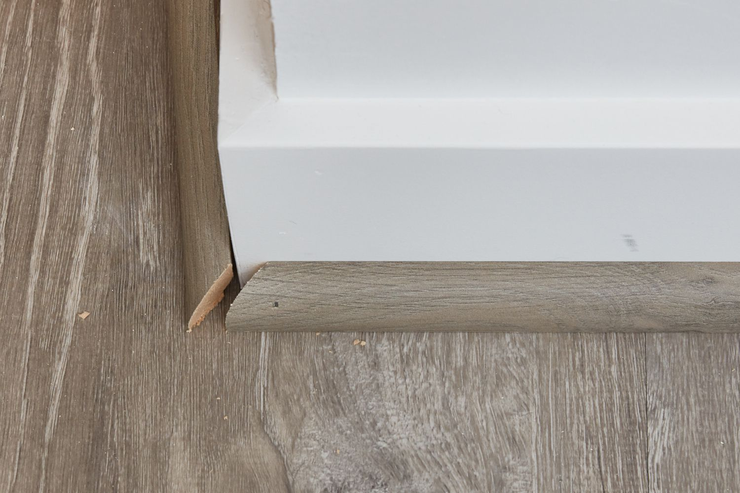

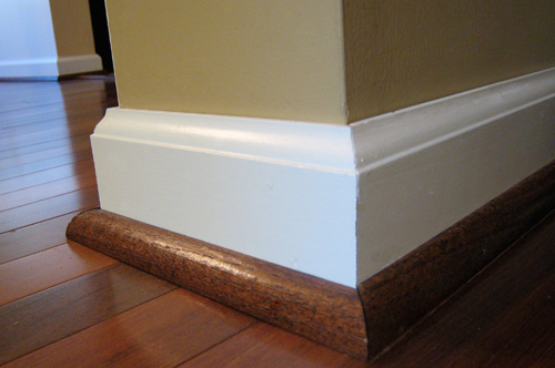

When removing the baseboards to install, LVP is out of the budget
116,040
Badass
Reactions: KSL and Dolly Llama
116,040
LVP should be installed UNDER the baseboards so that it can "float" (expand and contract). It's super common here for people to tear out the old flooring, or lay the LVP over the old hard surface and butt it up to the baseboard and install quater round to hidw the gaps, inn oreder to save money, and time...
Looks like shit imo/

I’m an old Pergo endourced installer. I’ve installed more laminated flooring than you’ve switched board dejour’s over the years. Quarter round or shoe mold is the norm and it’s perfectly acceptable for it to cover the expansion joint.
then it wasn't installed right.
nothing wrong with 1/4 rnd, but thinner shoe mold looks better.
and if they want colonial doorstop for shoe, (what that first pic looks like to me) which I agree looks much nicer, additional cost's apply
(material is more expensive)
otherwise, MDF is trailer park crap as far as I'm concerned and it's not worth pulling.
Pulling base in general is can be a fool's errand too, due to all the snafus that can happen
(that you have no clue about until you've pulled a few thousand feet to know what you don't know)
Now, let me help you so you don't sound like a complete idiot
that's the only molding that's finished in your pics
That one's not finished.
Needs caulked and painted same as base mold to look good.
It would look fine then
that one's the wrong color .
Shoe should be same color as base.
That would stick out like a sore thumb regardless if profile'd shoe was used.

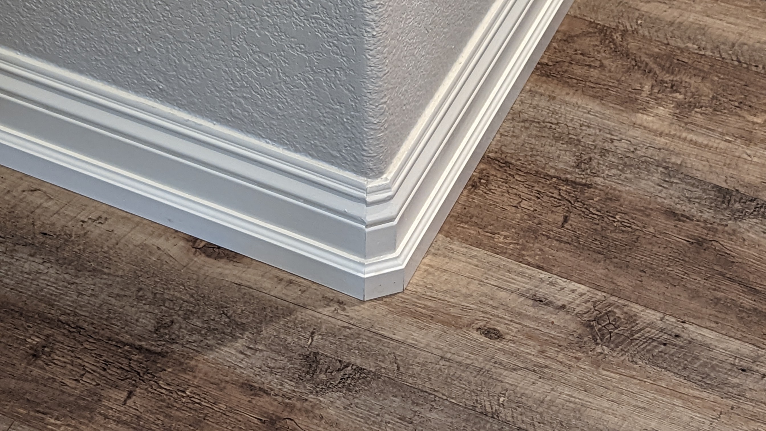

The house in the top photo is just 1.5M. Yes, it's unusual to see vinyl plank and a home of this stature but it's the commercial grade and they got lots of visitors and lots of big dogs and they made the right choice, even if they were slightly white trashy with the fancy molding.
They said I'm the only person that's ever noticed their commented.

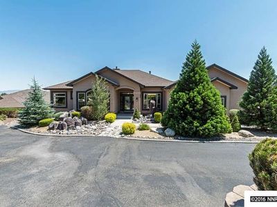

here's the house before the new owner and remodel..
