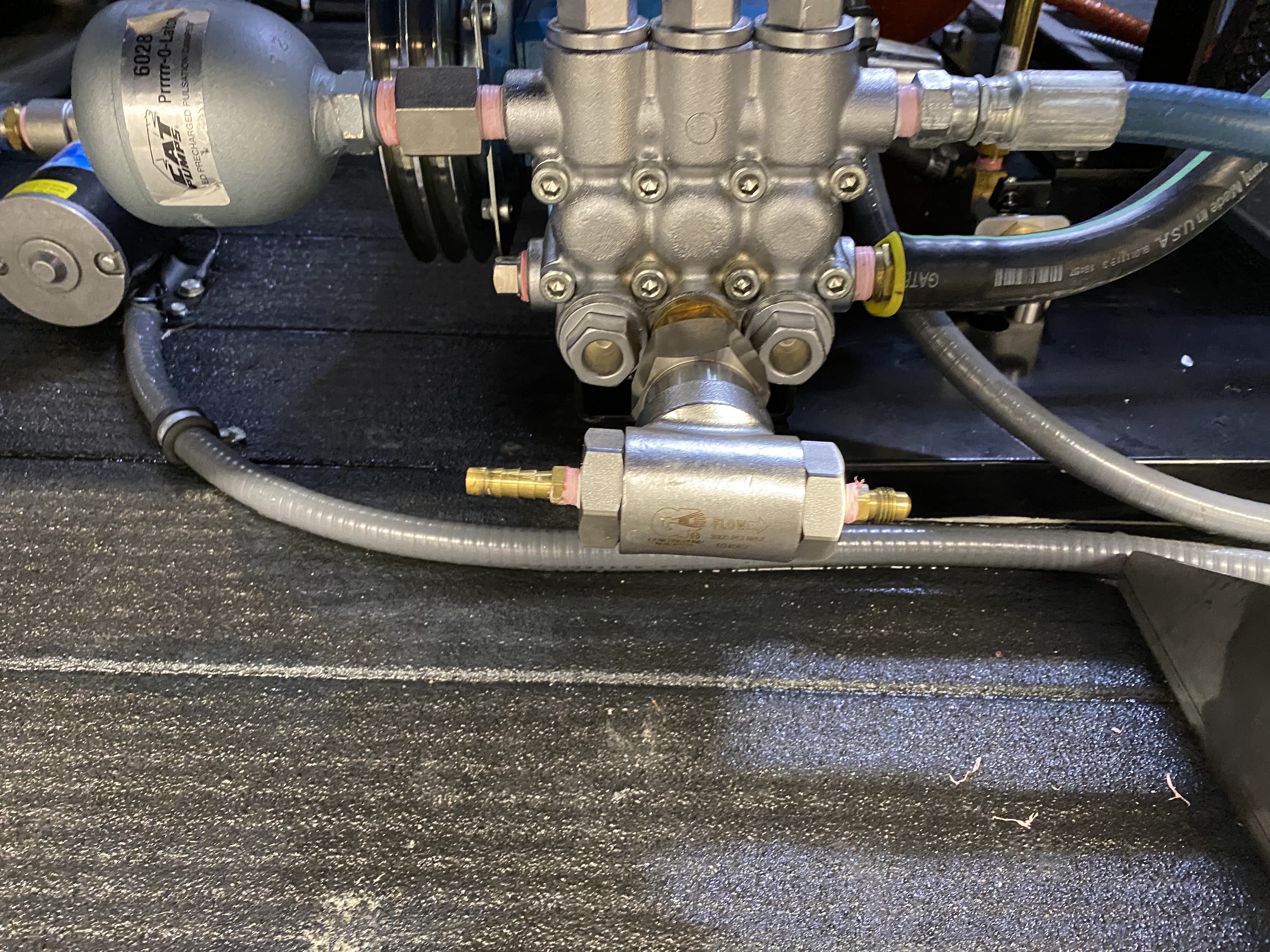

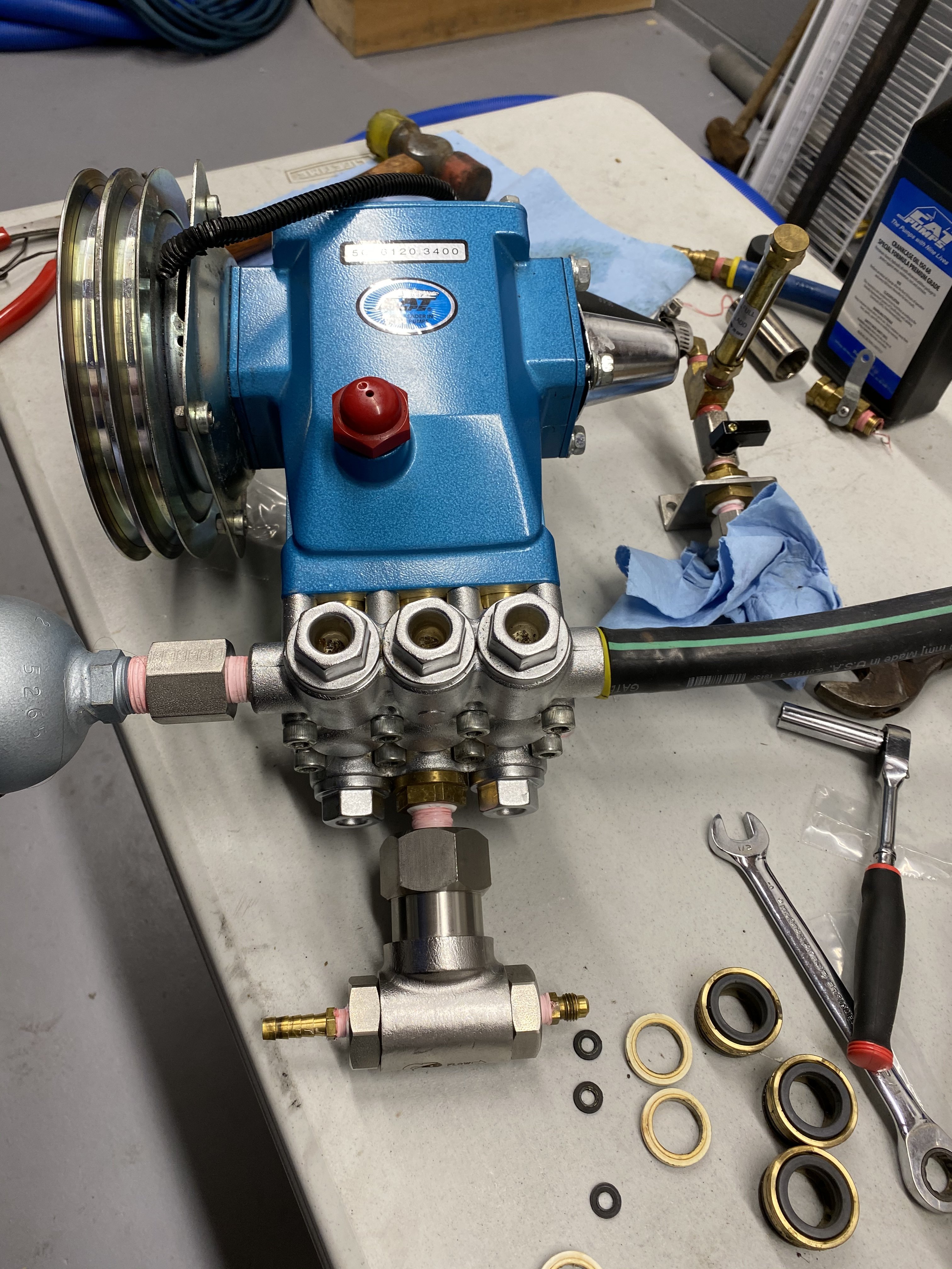

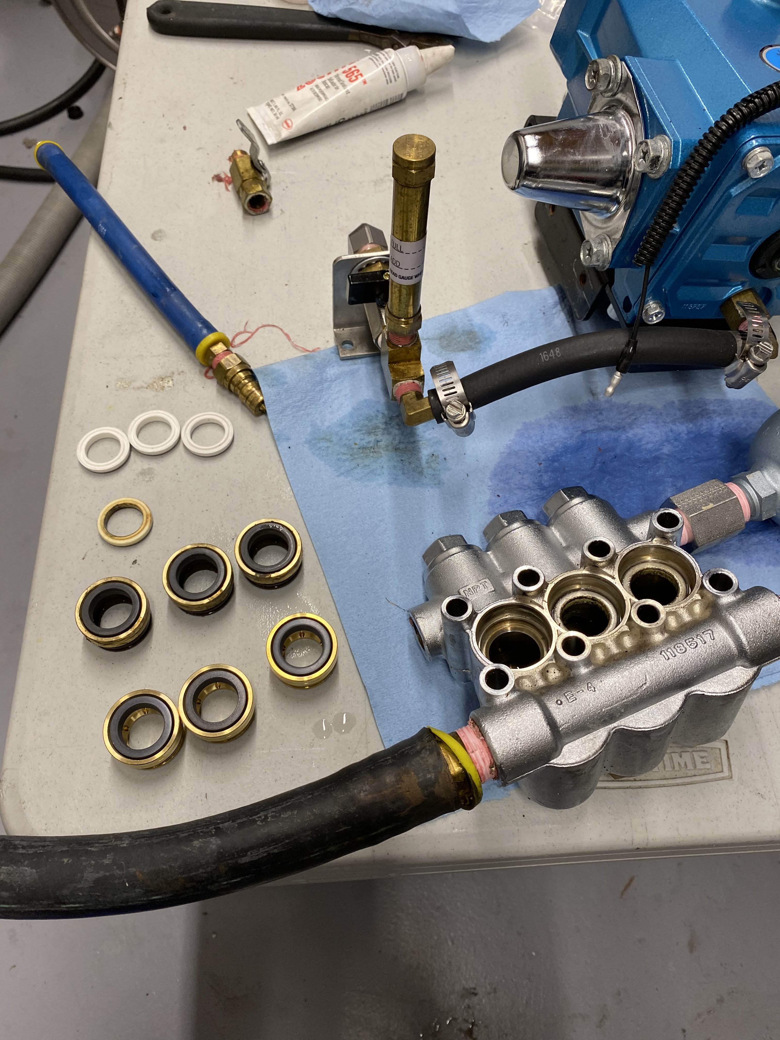

Ordered it from Toolbarn, installed yesterday. I rebuilt the pump and removed the shutoff, not needed anymore.
