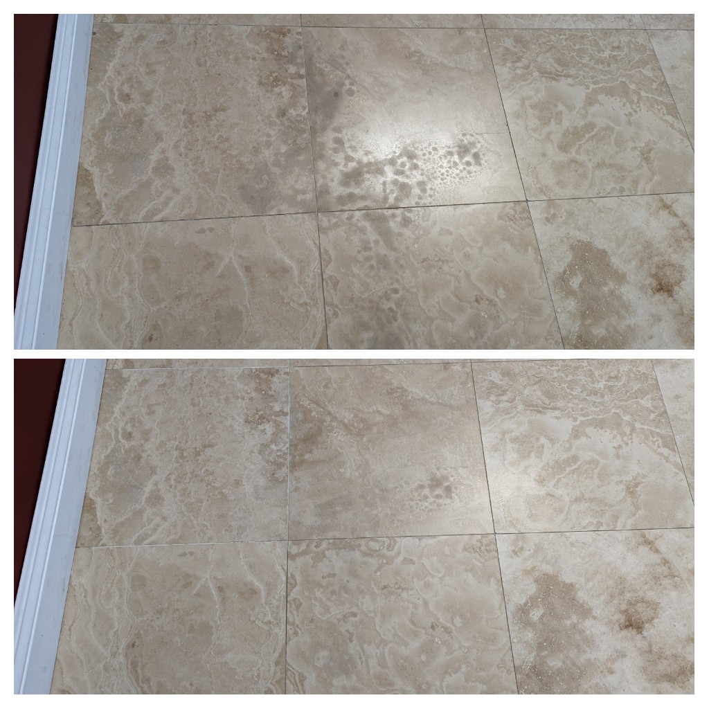

Turns out it was real travertine, very unusual one..
Got the red out but the etching remains. They didn't want to resurface the floor.. 20220831_111026-COLLAGE.jpgPXL_20220831_170836167.jpg

Not only did I misdiagnose this floor from the photograph that I posted elsewhere. I also blew it in the freakfact that my Crocs left footprints after using Sager tsunami and sugar oxy end cap to chemically etch the floor, normally I would have used 40 volume but I removed it as I'm headed to Vegas on Saturday and the only peroxide base product I had was the oxy encap, while it worked well, there were some kind of weird chemical reaction with my favorite casual footwear
I've left footprints as well using Tsunami. Needs to be acid rinsed to prevent that in my limited opinion.
