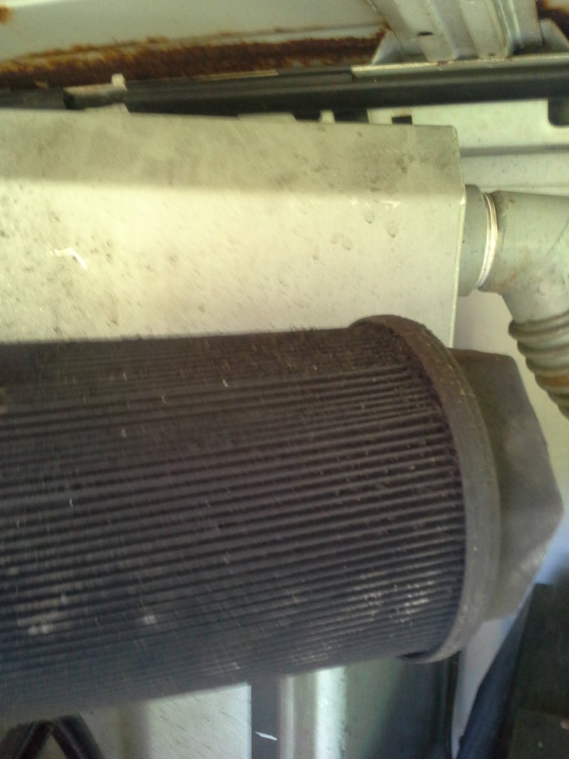

when you say "filter" do you mean- Lint trap?--- Check your blower filters
That's what I would guess too. My Cleanco (blower protection) filters need to be hosed off about every other day.

Yeah, and if you haven't cleaned them in awhile you may want to let them set in a bucket of hot water for some time first.

I'll have to try that. I use a Devastator to catch most of the stuff but I can definitely feel a loss in suction after a day or 2.

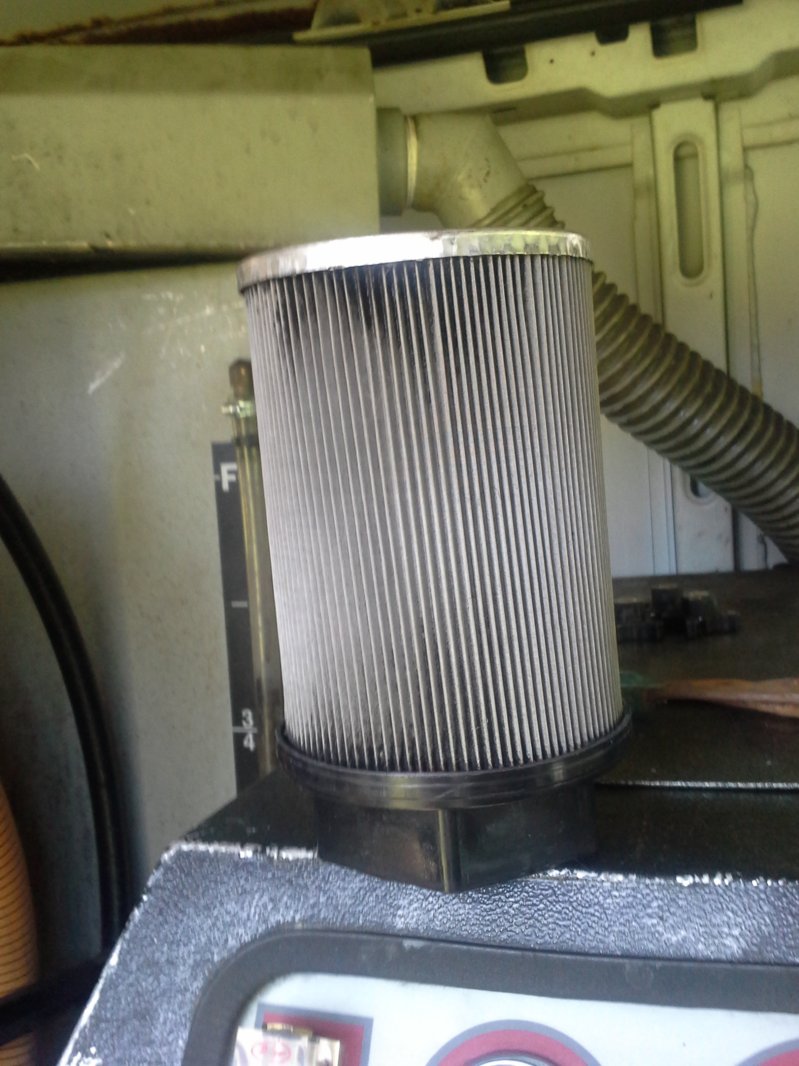

Vacuum filter need scrubbing with a brush, new foam seal on the lid my 405 is amazing again.
I thought my problem was leaky hose cuffs.
Like Lee said something could be blocking a elbow take a garden hose push it in the recovery tank side towards hose hook up if it's blocked you'll hit something.

Dump valve close all the way .. sometimes grit will block the blade.
Pop off valve screw loose from vibration? (valve on blower)

Never...NEVER...scrub yor filter....run water from inside out at pressure...

Make sure the dump valve is closed all the way. Open the dump valve and make sure nothing is in the track that will keep it from closing all the way.
