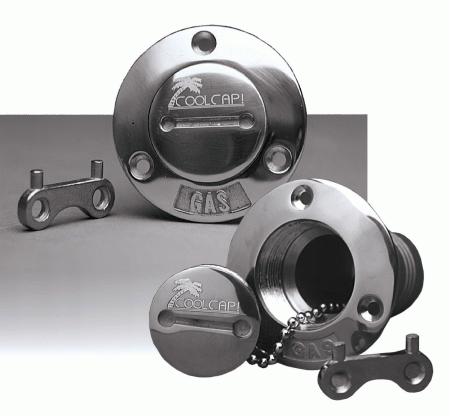

I already ordered the gas cap. the tank will be installed behind the rear axles and the fill neck will be on the driver side rear quarter panel. Haven't decided where to put the fuel gauge yet.

If that is a marine cap - you will likely end up with a vapor lock issue. Can't have a totally sealed system, air has to be introduced back into the tank as the fuel is removed.

Adding a second tank under is something I haven't yet done - maybe there is a way to get air flow back into the tank via check valve of some sort.
