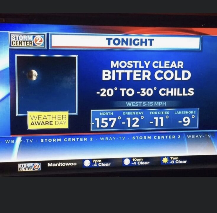

If there was ever a good reason this is why Dwaino lives on the coast!

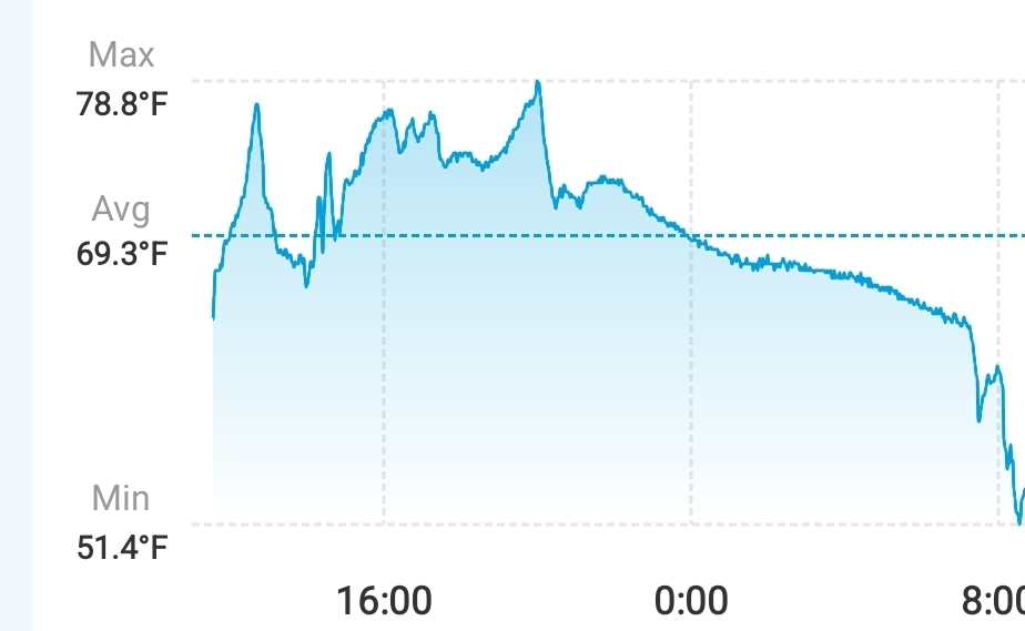

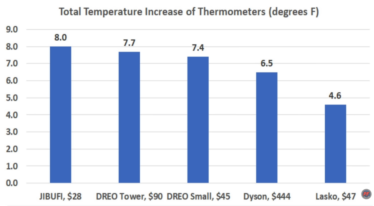

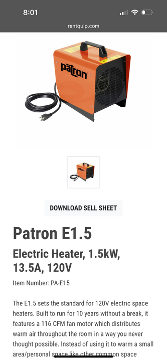

Screenshot_20251106_173426_Google.jpg Screenshot_20251106_173441_Google.jpg Screenshot_20251106_174539_Google.jpg Screenshot_20251106_175828_Google.jpg
