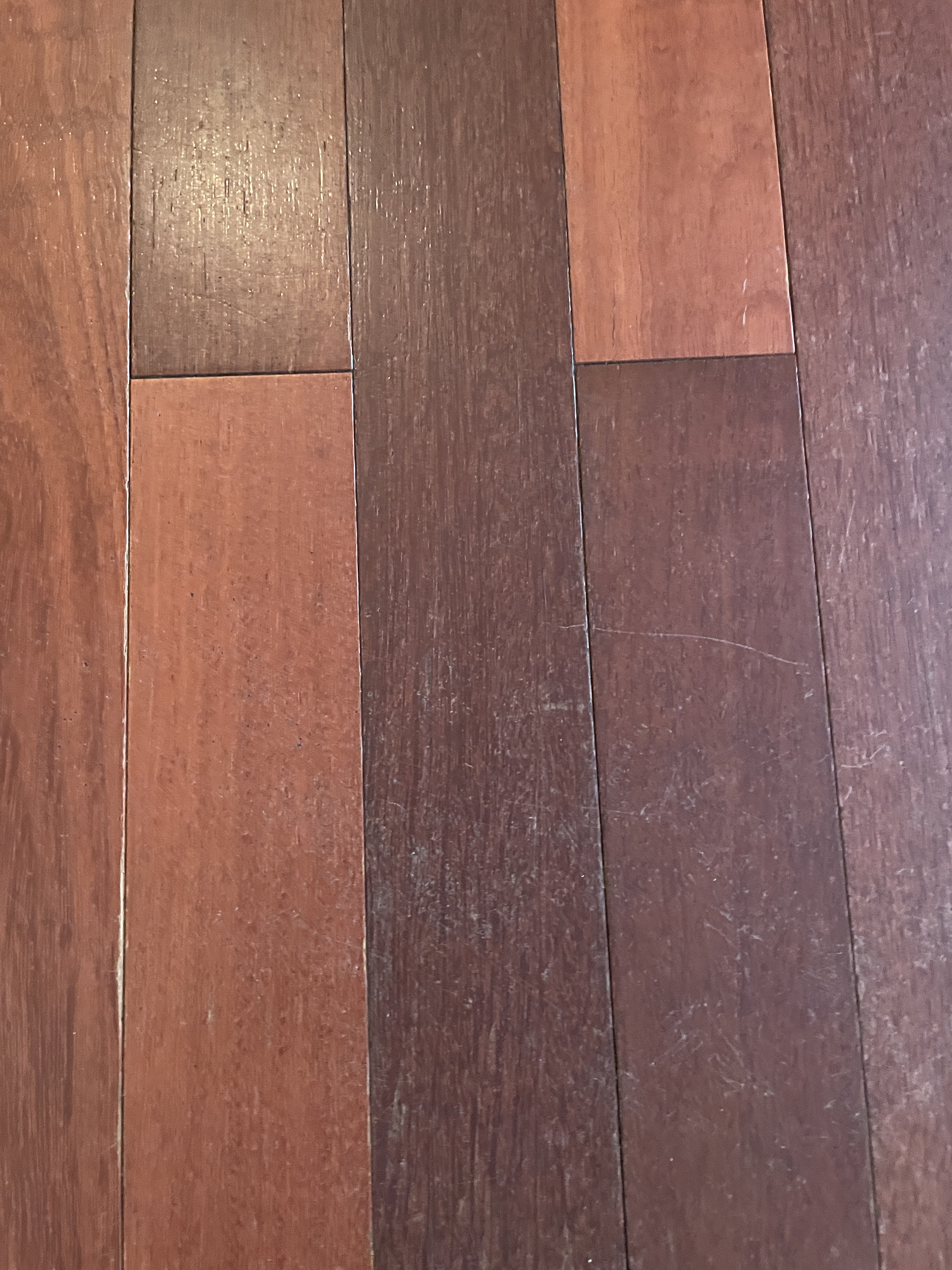

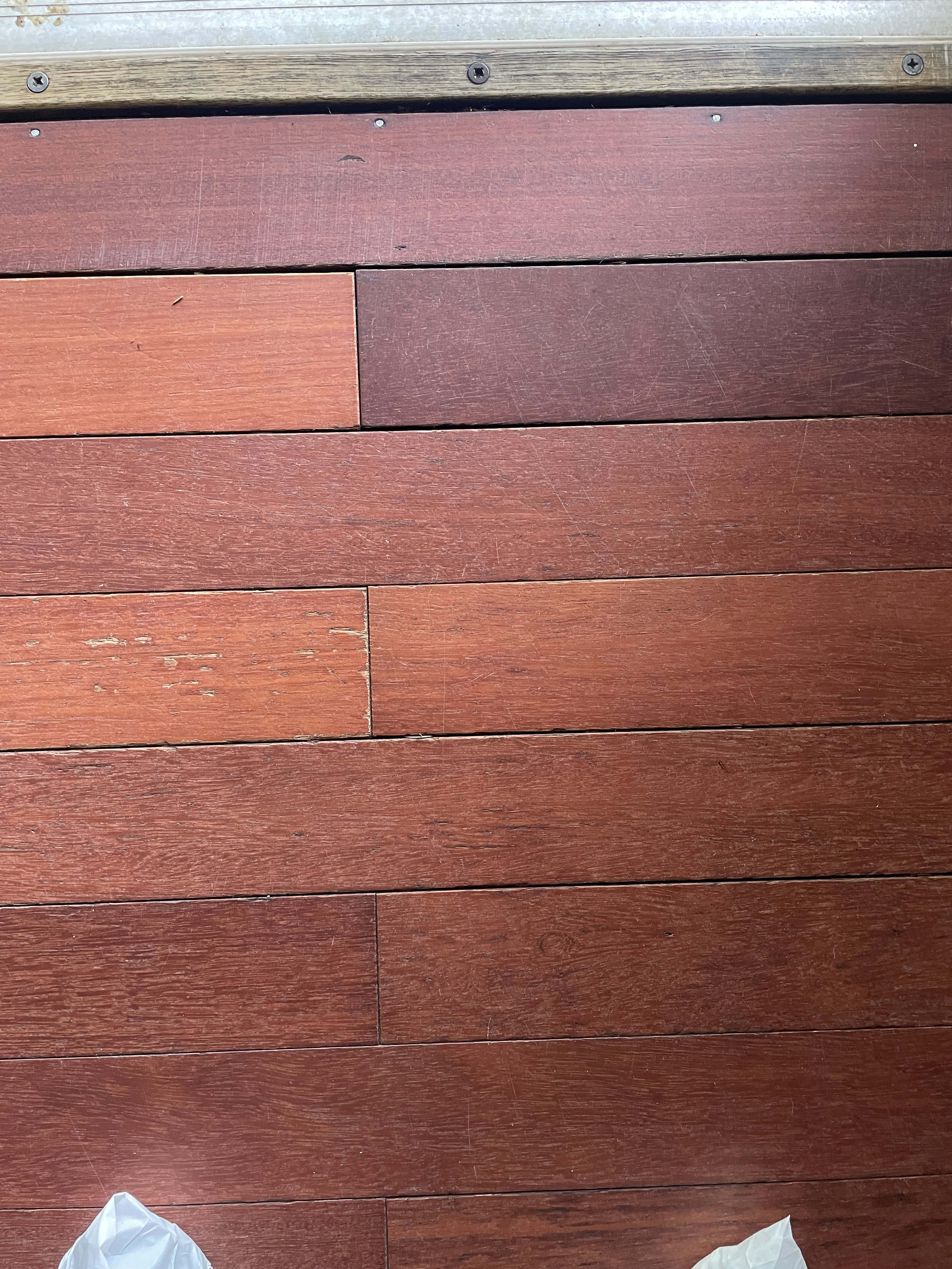

Came out good and clean. Very easy set up made it very easy job.
Before
After
So as long as I don't get a call that the floor is popping off the subfloor, It was a success.
Before I cleaned it, it was sticky when walking on it, now it is clean and can feel the difference more than see it.
