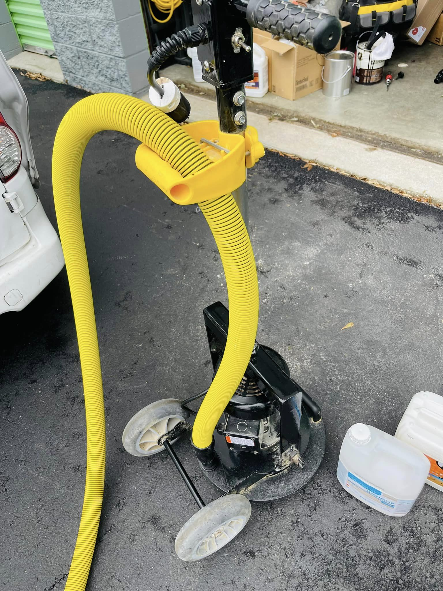

For all you pad cappers, if you’re looking to upgrade your lifestyle, and have been thinking about jumping onto the hottest trend in hardwood floor maintenance, here’s your solution. I’ve been finish sanding, screening and coating with the TOPS Odyssey.
I have tried square buffs and rotaries, but this little 13” banger is light and easy to use. I removed the tamping for smooth operation, drilled a vac port on the rear top plate, and added a simple dust skirt for a dust free work environment. Trinity OP Systems should consider this mod standard..
