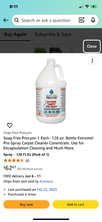

Liquid
My experience with the powder is that it leaves a death valley salt pack around fittings and spray tips
Procyon Extreme works very well for wool carpeting. (Liquid), but the price is RIDICULOUS!!!!!!

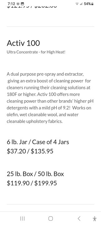

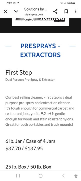

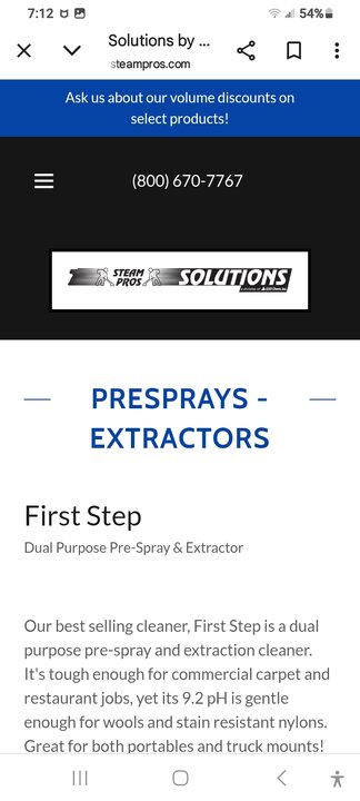

Ive been reading dry slurry is safe for wool.
Any thoughts?
I use first step as my primary prespray and hd100 as an emulsifier for virtually all carpets including fine wool . After cleaning i do rinse all carpets with prochem all fiber rinse. It cleans very well and is pretty idiot proof with employees i never had to worry that they used the wrong product on wool. About the only other prespray i use is firestorm for greasey restaurants and my shop and funky rentals occasionally ill boost eighter one with 2cups of peroxide per 5qt hf sprayer and the other 2 cups in the bottle goes into the emulsifier jug. I go thru about 150lbs of hd100, 50lbs of first step and 30lbs of firestorm (6 jars) per year. Added perk when i order from steam pros solutions is that when i order 2-50lb boxes of any of there products i get a 25lb box for free to offset some of the shipping costs
