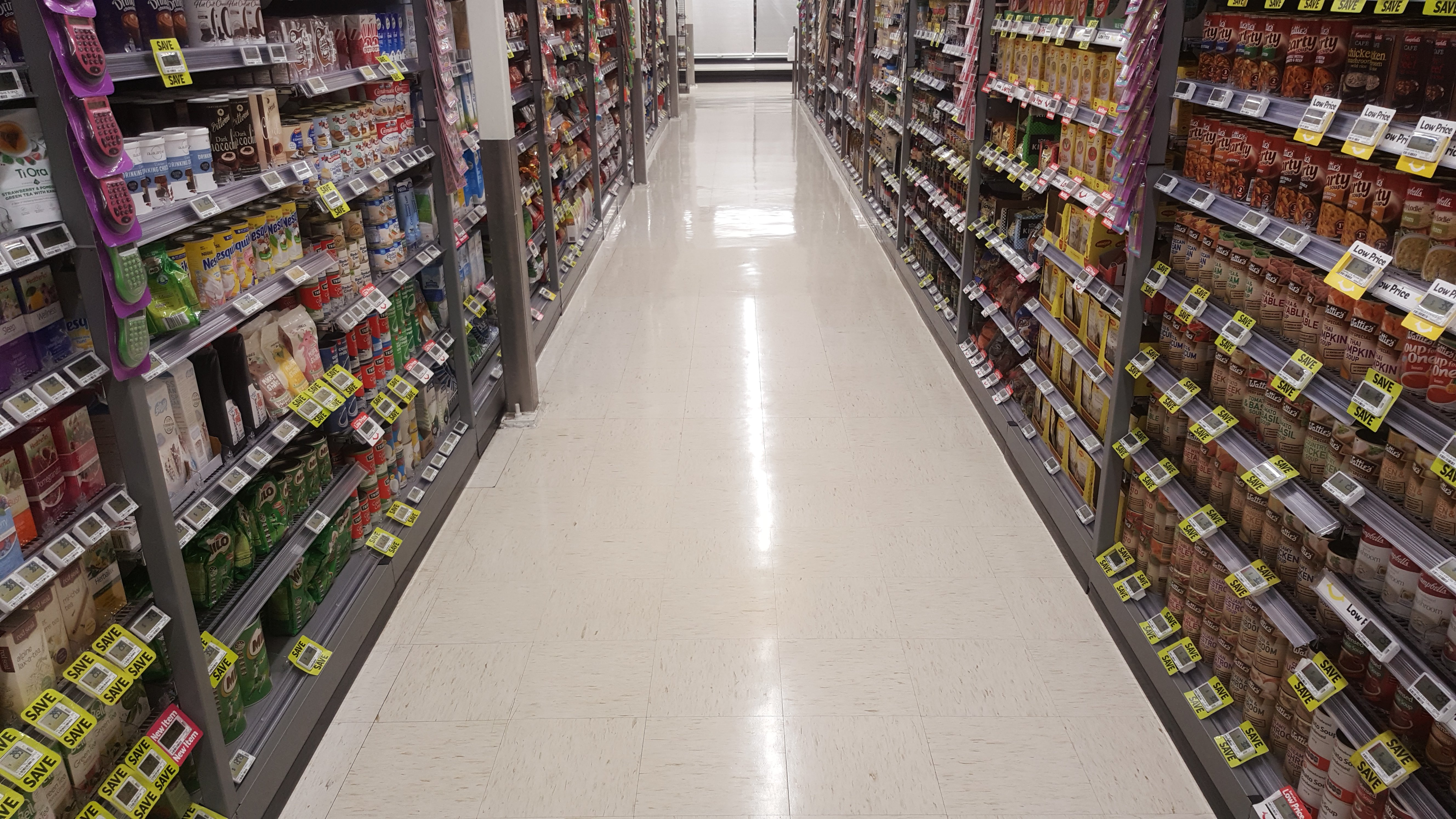

I run a cycle of detergent 1 night then 2 nights just water 20180519_204318.jpg

Judging by the pictures I'd say you're in over your head..
Oh no. I’m not gonna fix it. I was cleaning their carpet tiles at the entrance. Just like Walmart. I was just curios

I dont see yellowing in the picture. If it's in specific places I'd say plasticized migration from rubber mats and such, but if its everywhere then I have no idea.
