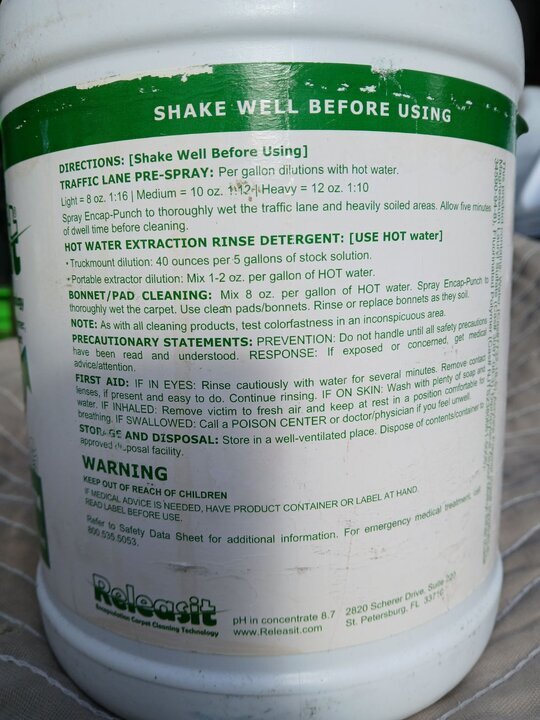

This week I did some furniture cleaning at 2 Houses. I did one on Monday and after the sister saw the job she called me to do hers
Both Sisters have 2 German Shepherds that lay on the furniture. Lucky for me both Sectionals were dark blue but still were atrocious
I used Punch as a Rinse Detergent at 1 oz per gallon in my Heated Portable ( water gets to 200 degrees ) and was very pleased with the results and so were the customers
After doing those jobs I thought maybe I should have used it at 2 oz. It says on label 1-2 oz per gallon for portables but I think that is for carpet not furniture
What are your thoughts on using Punch as a Rinse Detergent on TRASHED Furniture
