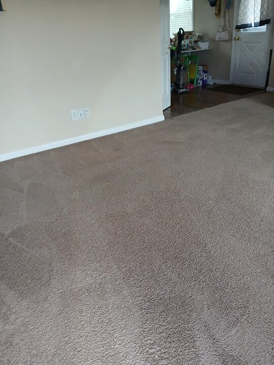

Long time customer. Living Room and Hall are always bad
Used VacAway Double Trouble 9.5 ph at 2 oz and 4 oz of Detonator (Peroxide) on carpet
I also cleaned the 2 Chairs Sofa and Lveseat
Thick dense carpet Clean and DRY in 1-2 hours
