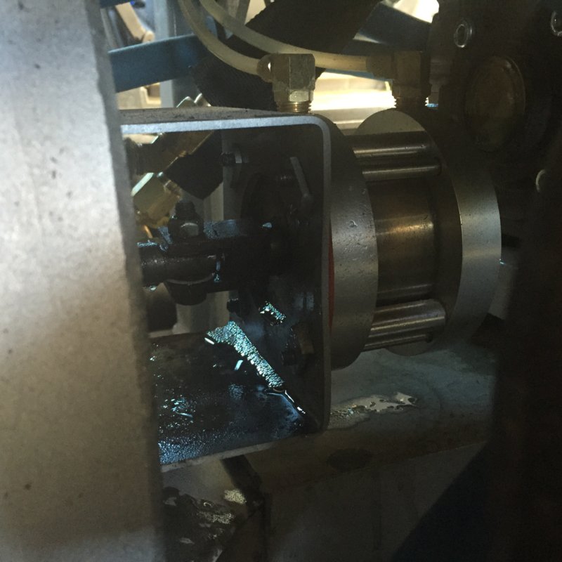

That Bimba valve is all the way out which is off. The exhaust is bypassing in that mode. I don't know what happens on the other end I haven't seen. I know how my last one worked and if the flex coupler was turning so was the diverter. Spend a few minutes and watch that shaft as it warms up. Is it moving in and out ❓
D
dgardner
Gene, according to the diagram out of the manual (that I posted earlier), that position is bypass closed (full heat, not bypassing) which would match the symptoms Sam is experiencing.
D
dgardner
Sam, with the unit not running can you move the shaft in towards the hx with your fingers? I tend to agree with Tom it looks kinda gummed up and may be physically stuck.....
Reactions: Lee Stockwell
11,531
I actually greased it and sprayed some wd40 on shaft thats why it looks funky. no it wont budge but I have been doubling up on wd40 at the vacuum inlet hoping it will loosen it.
D
dgardner
I see. That shaft goes through and moves a big disk (the actual diverter plate) and it could be the plate that is stuck. Hopefully Sapphire has a suggestion but you could end up disassembling that end of the hx to clean everything up.....

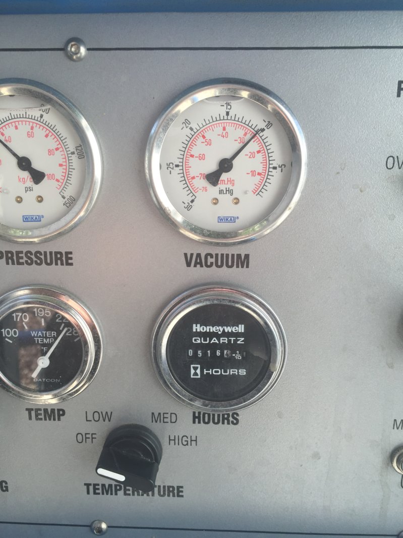

I now believe its been this problem all along and the temp switch is fine I had the temp switch off on our first job and we filled up after 3 rooms and steps tfa only. I'm leaving it on high to see if that helps with the bypassing.

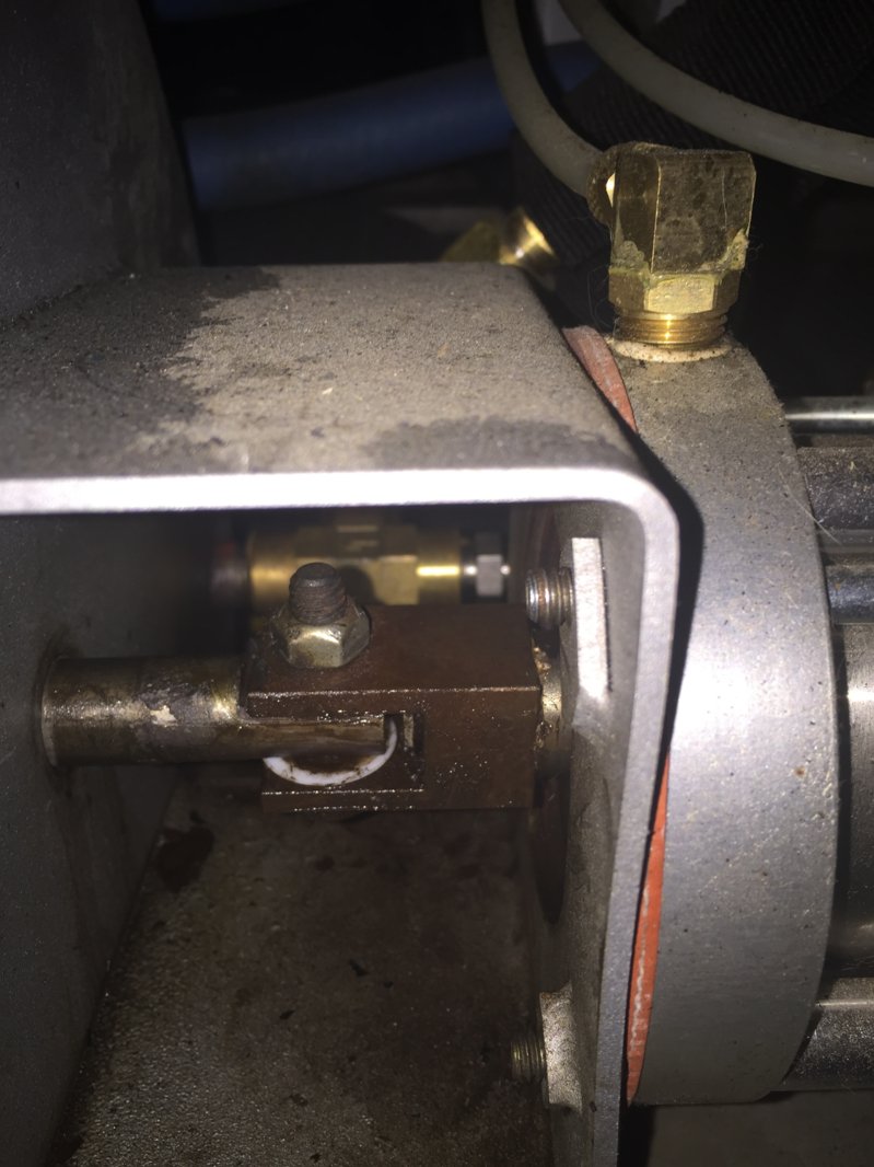

You can pull the pin from the fork on the shaft. Use a pry bar to see if you can move the shaft.

On all Sapphire units the divertor valve operation is as follows, IN - clevis stroked toward the back of the machine is off no heat, OUT - clevis stroked toward the front of the machine is heat mode, controlled by the temperature control.

Somehow I have it backwards in my head . You re right , At startup mine is towards the back of the machine. It pulls out to engage the heat. I would have already pulled the pin and checked that shaft if it's was mine. I'm quick to jump in. I'd check with sapphire before I twisted it with a pair of channel locks but I see if it will push in and out without the bimbo valve attached.
Gene
11,531
Actually I did what Gene said and wiggled the shaft and it move pretty freely just wont go back and forth believe its locked up on the bimbo valve side took the little hoses off and wate dripped out

The bimba valve moves the shaft. If you pull the pin from the fork that holds the shaft you will bypass the bimba valve.
Use something that you can push/pull on the shaft. It should move in and out without a lot of effort.
11,531
Bimba valve full of water??? Cleaned it out putting it back on now. No wonder empire didn't want to mess with it!
You can never let your machine get full because the shut off doesn't shut off until water pours out the front of machine.
You have to have s pump out and make sure it works. If the bimba valve gets water in it it will get stuck
