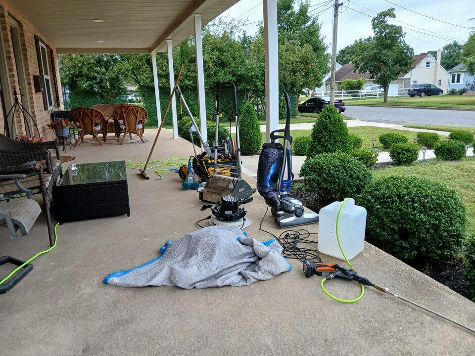

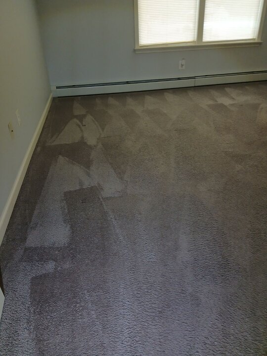

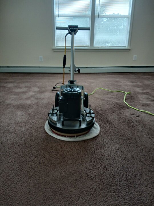

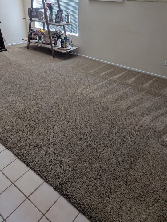

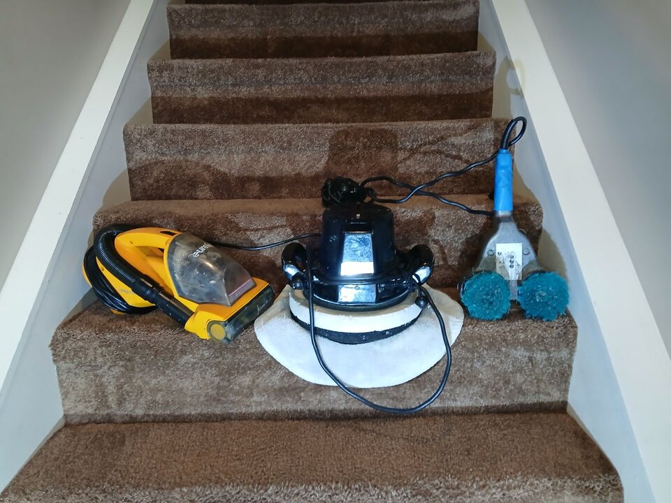

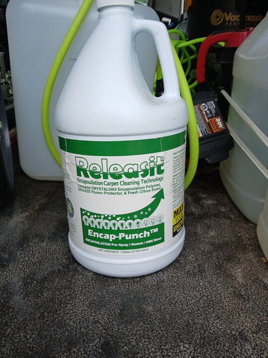

I had some time today so I decided to document my VLM process for the GROUP THINK
Yes I know nobody cares
I decided to try Excellent Supply Releasit Encap-Punch for the first time on Residential Carpet. This is a long time customer with a Painting Business and 10 rentals. The results were fantastic. No customers around so I can take my time and experiment. Punch did a beautiful job with low odor. I expected a stronger odor for Punch but was very surprised. It just has a light clean fragrance
I used 4 gallons to clean 2 Bedrooms Living Room Hall Steps. Hall and steps were still damp when I left. Rooms were probably 95% dry
Using 2 weights on each side and with Malish Driver instead of the velcro Driver makes Vibe much more aggressive and a cleaning MONSTER. No weights and a velcro Driver makes Vibe a WIMP
Just Wondering ??? Are you really vacuuming if your not using a Kirby. No other vacuum compares
Kirby is a REAL Vacuum !!! Kirby is a Man's Vacuum !!!
Steps
1 - Vacuum - Eureka Hand Held
2 - Encap - WORX Sprayer with 8002 teejet 8 oz Punch per gallon
3 - Scrub - Cyclo with Green Brushes
4 - Extract - Stepson with 14'' Challenger Bonnets
5 - Groom - Carpet Brush
Rooms/Hall
1 - Vacuum - Kirby Avalir
2 - Encap - WORX Sprayer with 8002 Teejet 8 oz Punch per gallon
3 - Scrub - 14'' Brush Master Pro 35 CRB with Grey Brushes
4 - Extract - Tankless Orbot Vibe with 2 weights on each side and SuperZorb Bonnets
5 - Groom - 10'' CRB with White Brushes
Get Paid with a HUGE Profit
It's 2025 !!! The Carpet Cleaning World has CHANGED over the last 10 Years
BETTER Machines BETTER Detergents BETTER Bonnets BETTER Dry Times means BETTER Carpet Cleaning and BETTER Profits
I love VLM !!!
