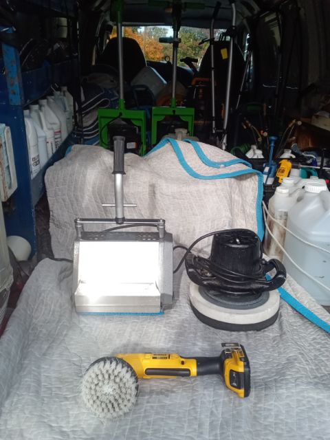

Why not groom with a rake?
It takes longer but I believe using a CRB with soft brushes makes the carpet fibers stand up better and makes the carpet look better than with a rake. Especially cheap polyester
Some people HATE the TRUTH but the TRUTH is VLM WORKS !!!
I love VLM !!!

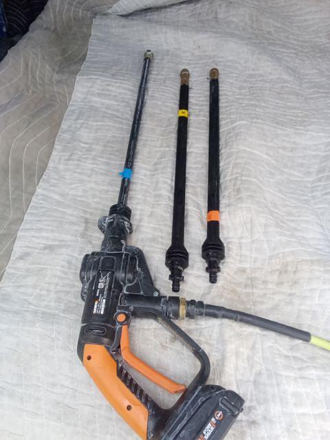

My opinion on the best chemicals for VLM in Residential homes has changed over the last year
I still like Carpet Details for homes with elderly and need zero odor or very light soiling but for the other 95% I have found Vacaway detergents are the best for VLM cleaning of Residential carpet
Carpet Details struggles to get the excellent results I need on difficult to clean polyester carpet
Double Trouble is amazing cleaner of polyester carpet at 2oz and has very low odor using a 8002 jet on a Worx Sprayer. Heavily soiled needs 3oz
The BEST Sprayer for VLM is a Worx ... PERIOD !!!
I love VLM !!!
