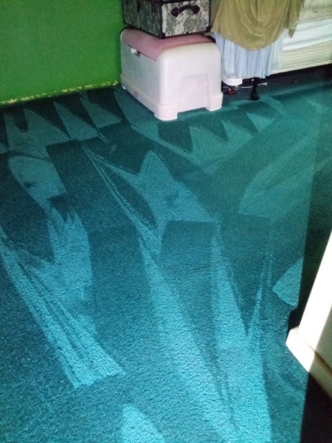

Why not groom with a rake?
It takes longer but I believe using a CRB with soft brushes makes the carpet fibers stand up better and makes the carpet look better than with a rake. Especially cheap polyester
Some people HATE the TRUTH but the TRUTH is VLM WORKS !!!
