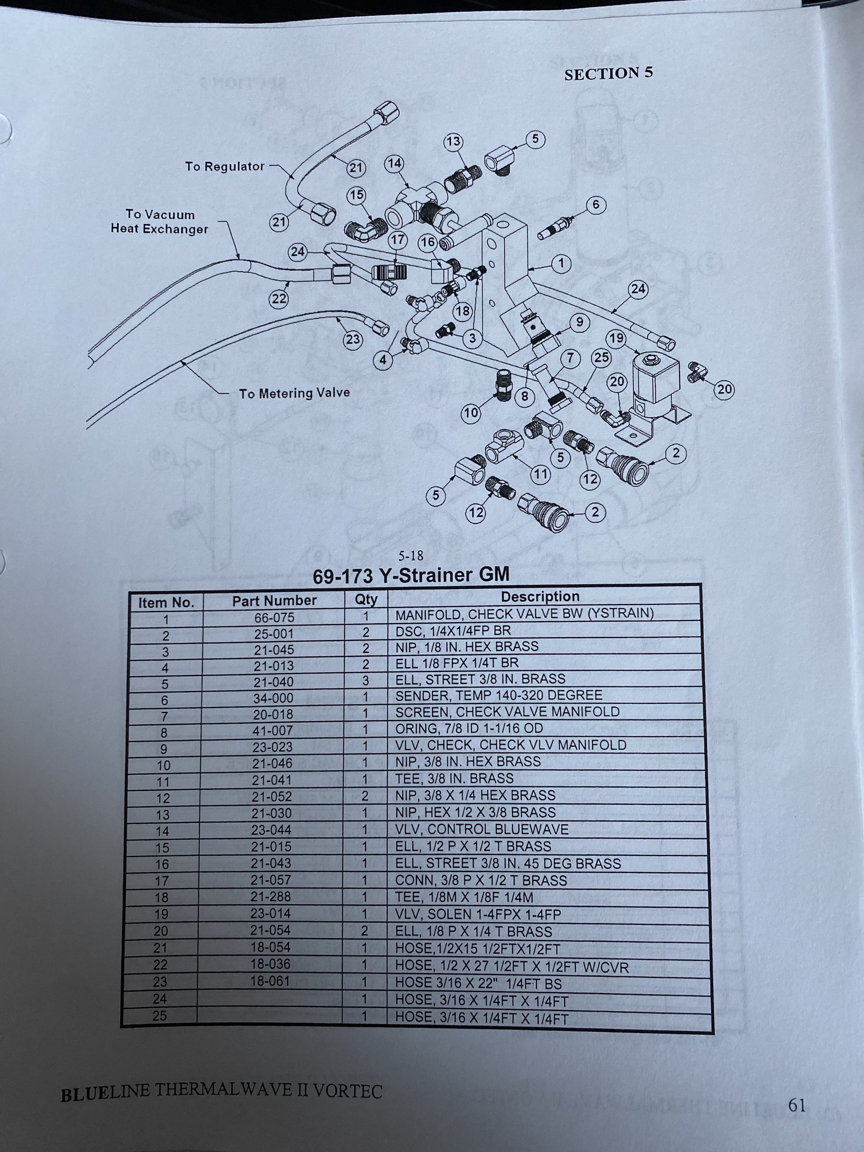

Thanks to your updated manual…it showed where the plumbing I had currently .from my manual, was preventing the hot water to return back to the water box. And since my unit doesn’t have a solenoid, the hose #24 was routed to the pressure regulator so the water would stop moving.
And to complete the day even better…the headers didn’t overheat and glow during testing. I hope it stays that way. I’ll be burning extra clean gas for the next few tanks to make certain it stays that way
Thanks again @Justin Legend Brands
And @Jim Martin , your help was Greatly appreciated as well.

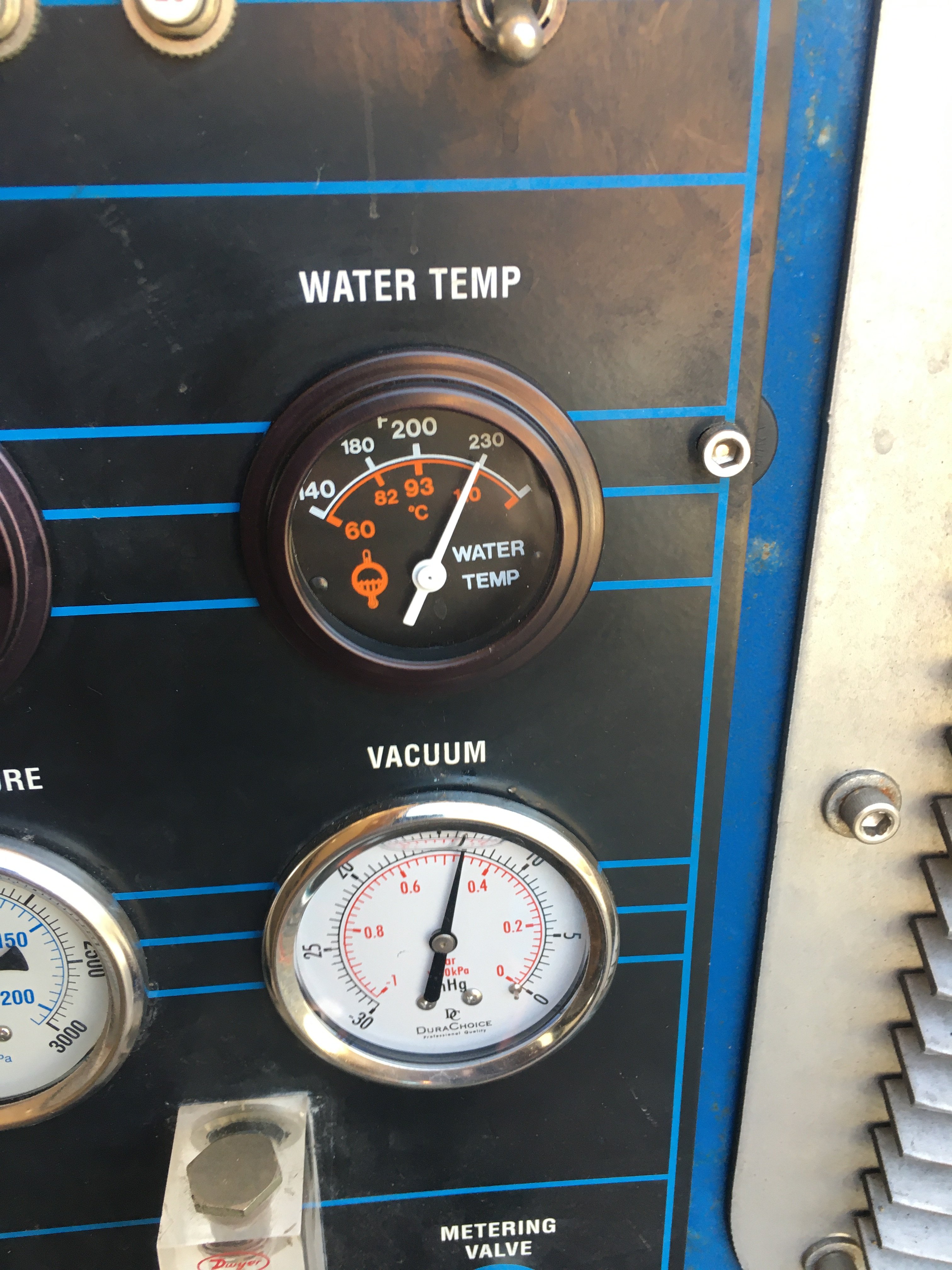

Thanks to your updated manual, The temp loss problem has finally been fixed. I have yet to find out if it can compete with the everest heat (I need to put it on a full day of work), and the headers did not start overheating with red glow today.
So this project is ready to be sent out to work. Thanks @Justin Legend Brands , and @Jim Martin

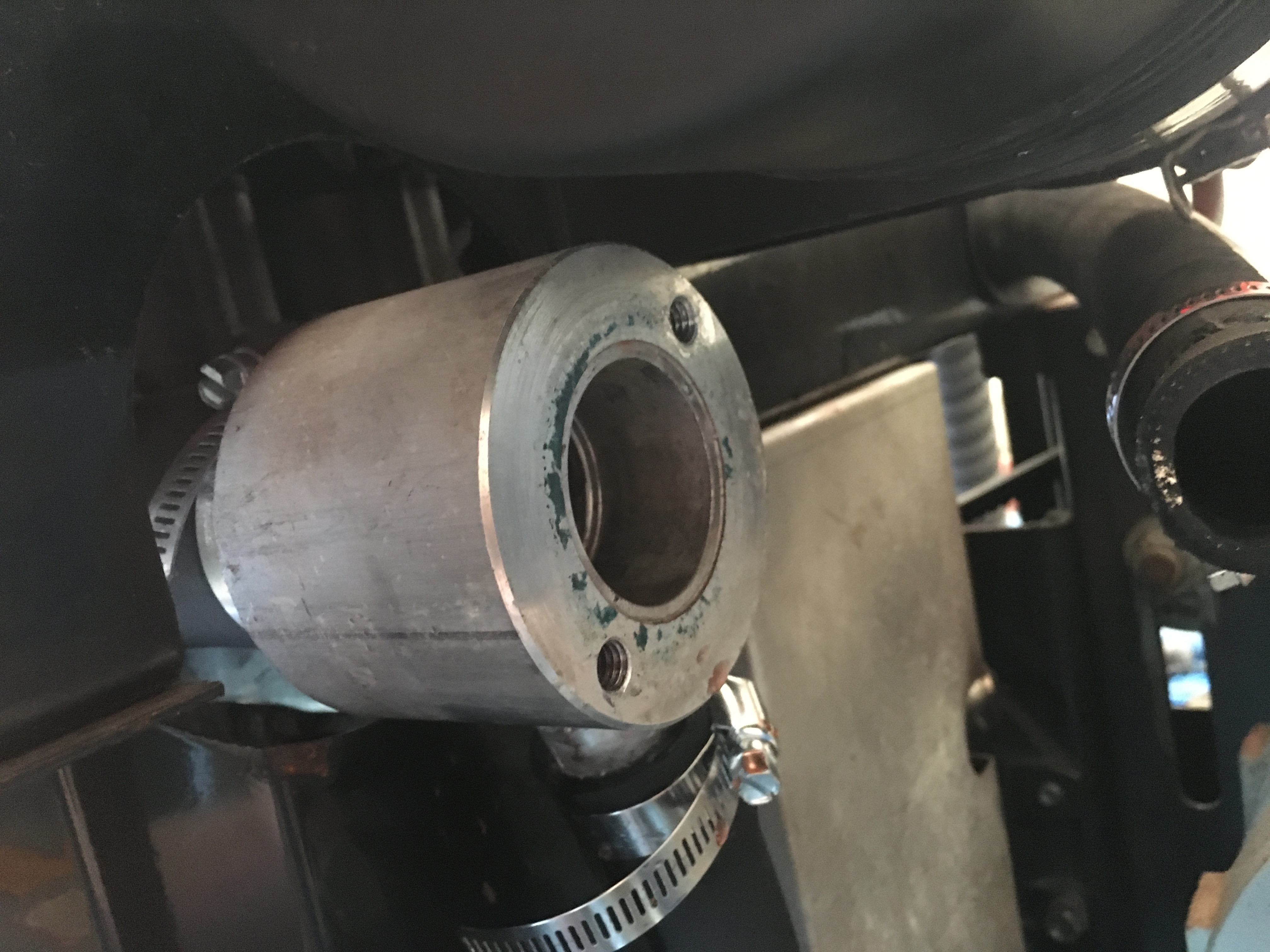

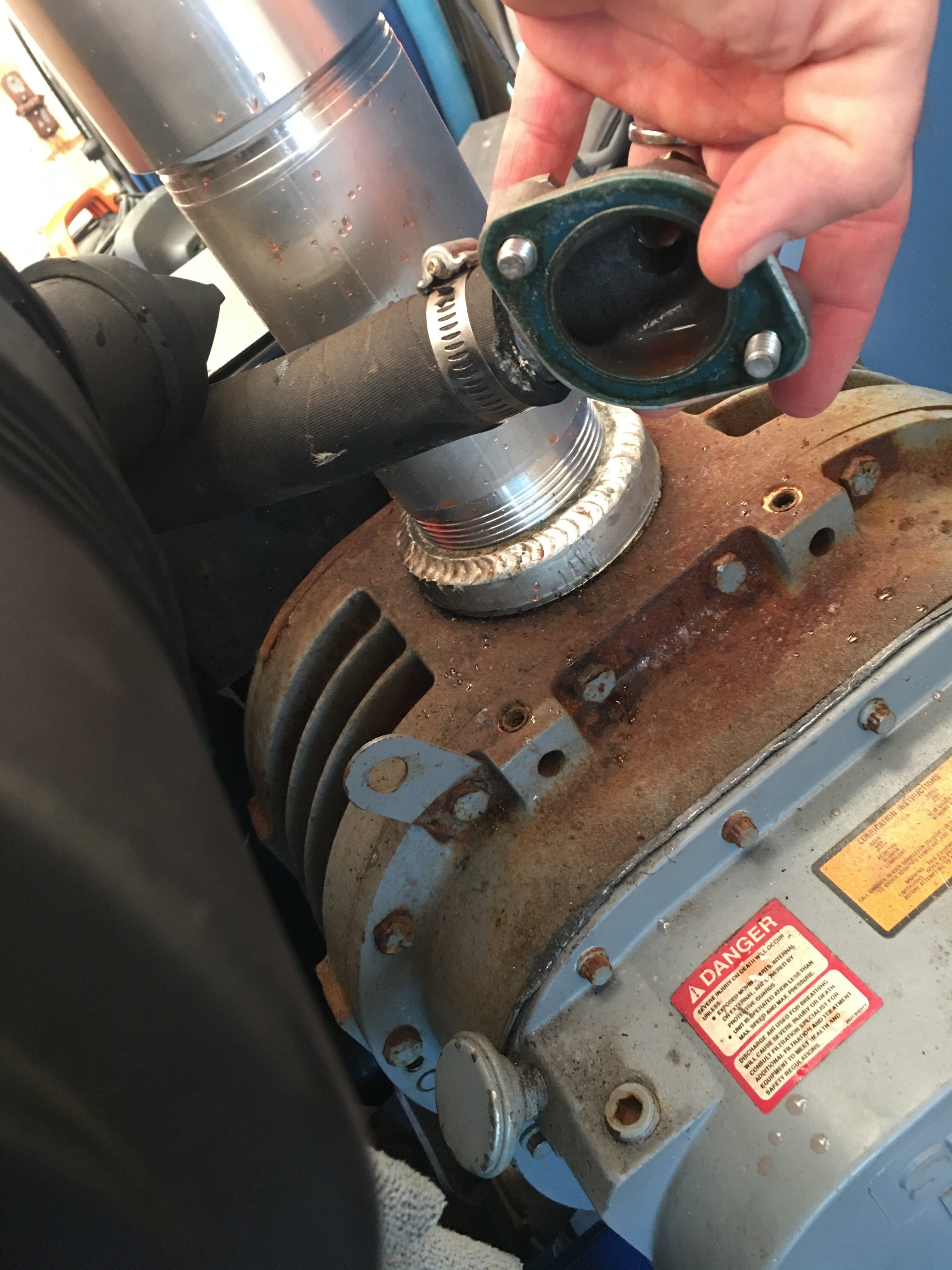

Aaaaand…another stupid finding
I was never fully satisfied with the heat. So I kept testing it and noticed the thermostat housing right above the coolant heat exchanger is almost 100f hotter than the heat exchanger. So I’m thinking the thermostat is bad
Well, I take it off, only to see the housing with NO FKIN THERMOSTAT! It’s been bypassing the heat exchanger the whole time. So I go to the auto parts store and get the recommended one, only to discover it’s too big to fit in the seat of the housing.
If anyone knows the part number to fit this housing, I’d appreciate it.

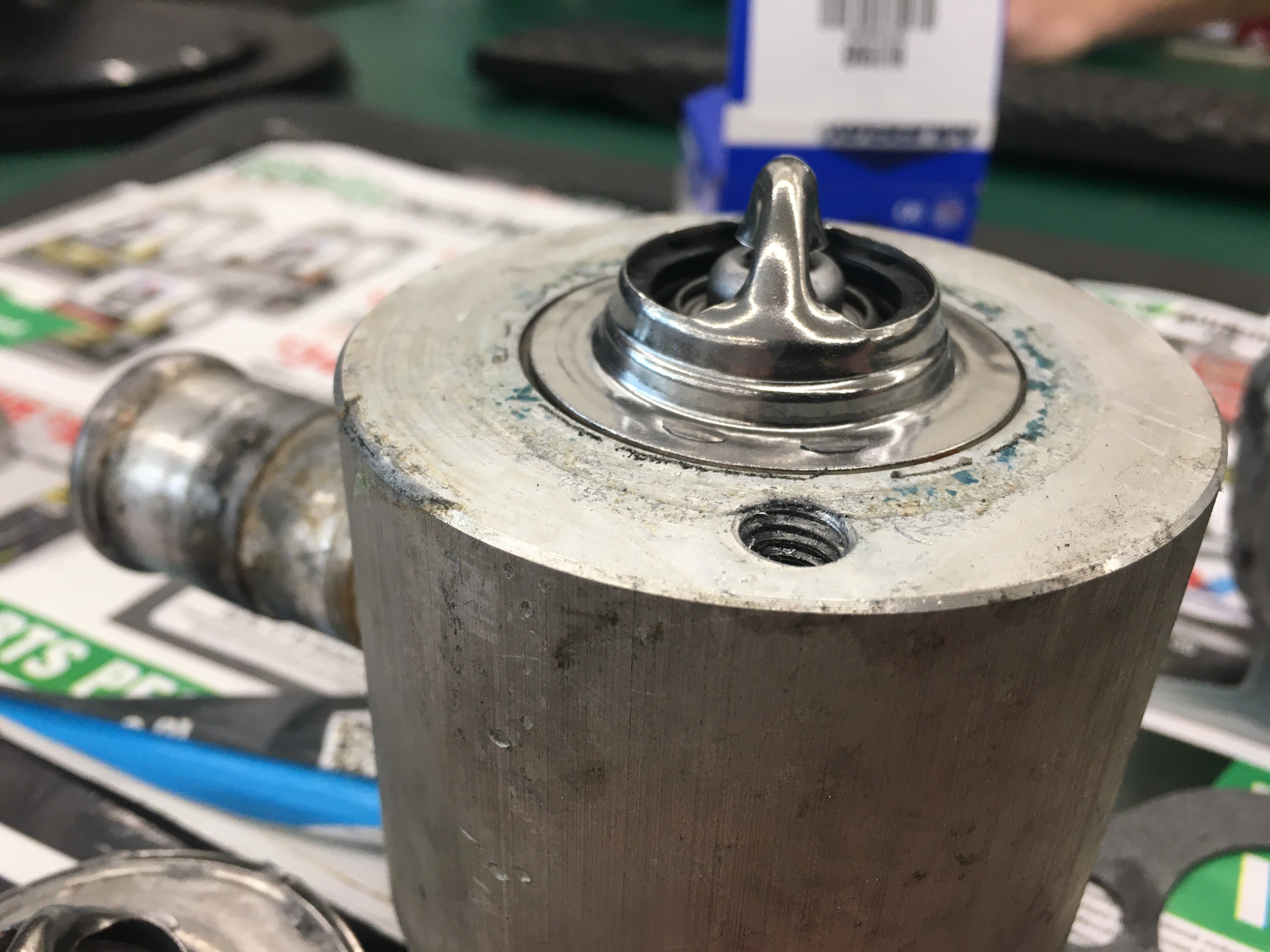

F35C8F91-E285-4EDE-90E1-1C03F4D97BE6.jpeg 67071B70-A80D-49B0-AB1D-BA3AA1FB2537.jpeg
Is this what you meant by recommended one?
THERMOSTAT, NISSAN A-15 195 DEG
I looked locally auto store for a 195degree for a 1981 Datsun 210/310 (which I assume is the same part)but only found 180
for cross reference
*shows the nissan tstat in GM Manual
14,624
for cross reference
I got the thermostat from a ‘76 Datsun b210
I’ll look up your reference and see if it pulls up a different thermostat
break your calipers out and tell us how big that is
and you were putting it in the right way right? :D
14,624
I should’ve taken the housing with me to fit it in at the store. That’s my project this weekend
