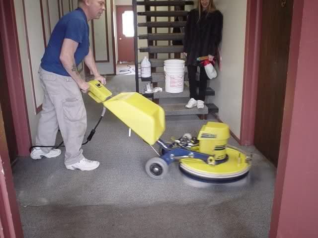

My cimex has the spray up front and it is better than shower feed. IMHO
Here is a picture of the cimex doing commercial hallway with a lot of asphalt track off and heavy soil load in apartment hallway.( you can see jets up front)

very cool Tom!

What powers the jet up front? Gravity flow? Does it fan out a little? Like the width of the whole set up?

i have tried a machine with them jets out front and don't like it..over sprays to much, while the pad feed keeps things under control...

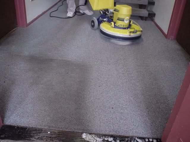

The machine has a pump on it, so when you pull the handle instead of shower feed, it sprays. I had to change spray set-up to get the spray pattern where I wanted it, but it works great now. That is me operating the cimex, and that is Andrechelle on the steps watching me. ((Andrechelle from Andrechelle.com web site design, and summerfest woman of the year in 2004). Cleaning with releasit from rick.

if you are training some one to use a cimex, using Rick's juice, it is a little easier if they can see a foam product to gauge how much they are using

The foam was from the releasit, this was one of the first jobs I did with it, and it is quite possible I over applied the chemical. It was worse than the pictures show. We did 9 -3 story apartment buildings and steps on this job.
As we became more familiar with the machine and chemical we used a lot less chemical to get the same results.
