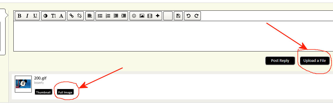

Tom,
Looks like for vimeo you will need to use the insert video button and copy/paste the direct url in
