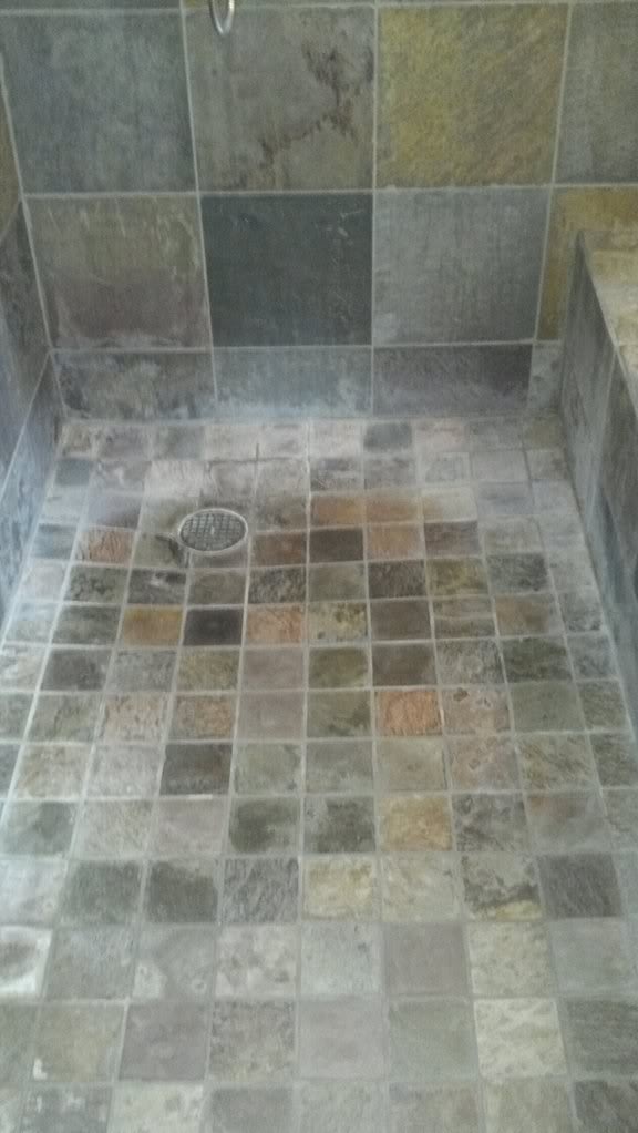

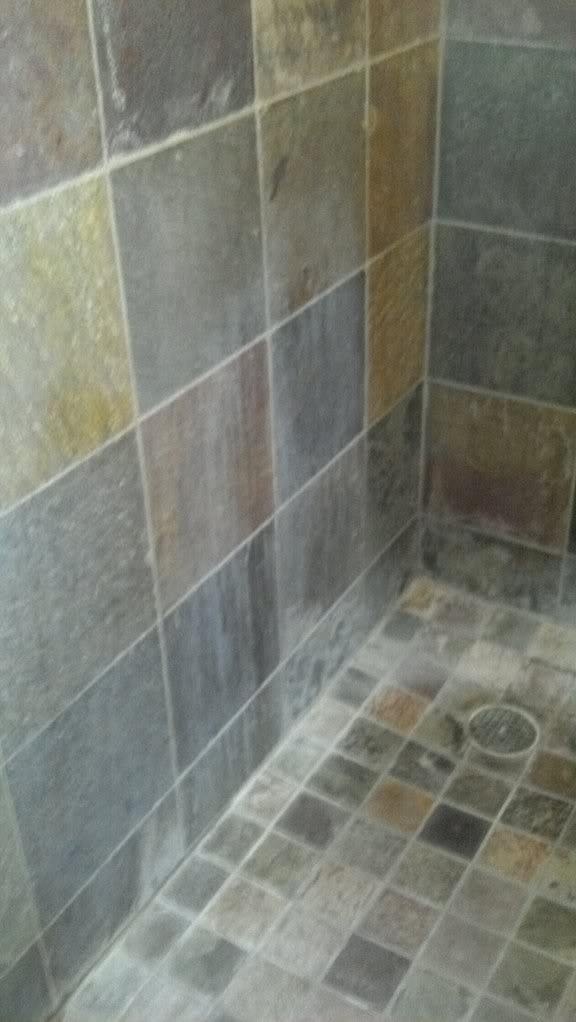

before
after
give me hard surfaces :shock: !gotcha! shiteatinggrin

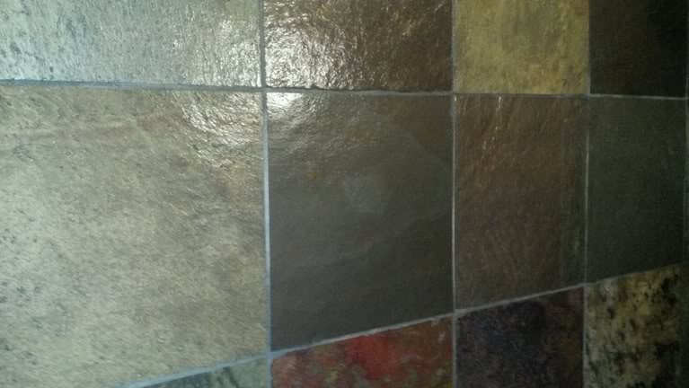

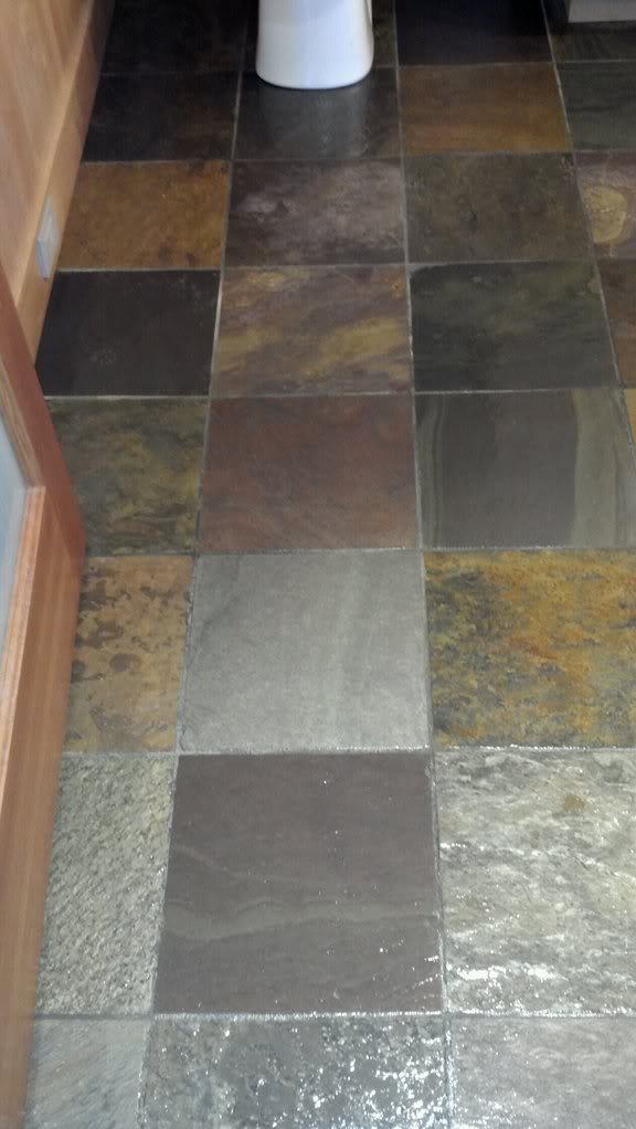

enhancer is still wet
go back next week and 80 of it will be gone.

305 husky acid cleaner its clingy and pink. does not dry out. 25 minutes of dwell. 475.00 just under 2 hours.

how did you scrub off the heavy soap scum/deposits? I always let slate dry out 1-2 days with fans before color enhancing as well...just curious

Bill we used a product by husky #305 i believe it might be 303. Its a pink clingy acid 20 minutes dwell time, Most of the build up was calcium hard water.
