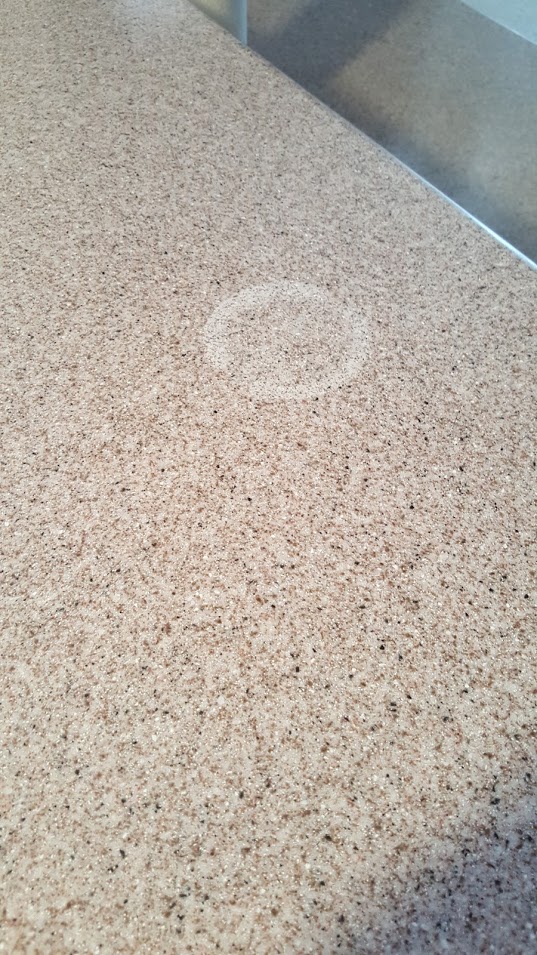

color loss on Corian counter
117,374
anybody ever dealt with this?

Crop circles. Damty low-rent runty aliens make them and leave us poor humans to wonder...

No and i have blue corian and a lot has been left on it with no problem.

Maybe try a real fine sand paper or something like a 3000 grit spinergy pad to remove a thin layer.
I know a guy that manufactures corian. I haven't seen him for years. I'll see if I can contact him and ask what to do.

I don't do Corian. It might be able to be sanded out and polished. I don't know the exact procedure, but I know you can sand it with an orbital and some automotive sandpaper and polish it with some stuff. I dunno, maybe just light it on fire.

Burns can cause deep discoloration. A blemish or even scratches don't require much more sanding than, say, a wood plank would. The trick is to be disciplined in using progressively finer grits, as there will be no concealing the swirl marks left by skipping stages. At the end, a good buffing with polishing compound will make it look like glass. Not hard, just tedious.

The color is all the way through the Corian. The key is to sand the burn and sand the rest of the slab without creating a crater.

If it is like wood then a burn is much harder to remove than a scratch.
