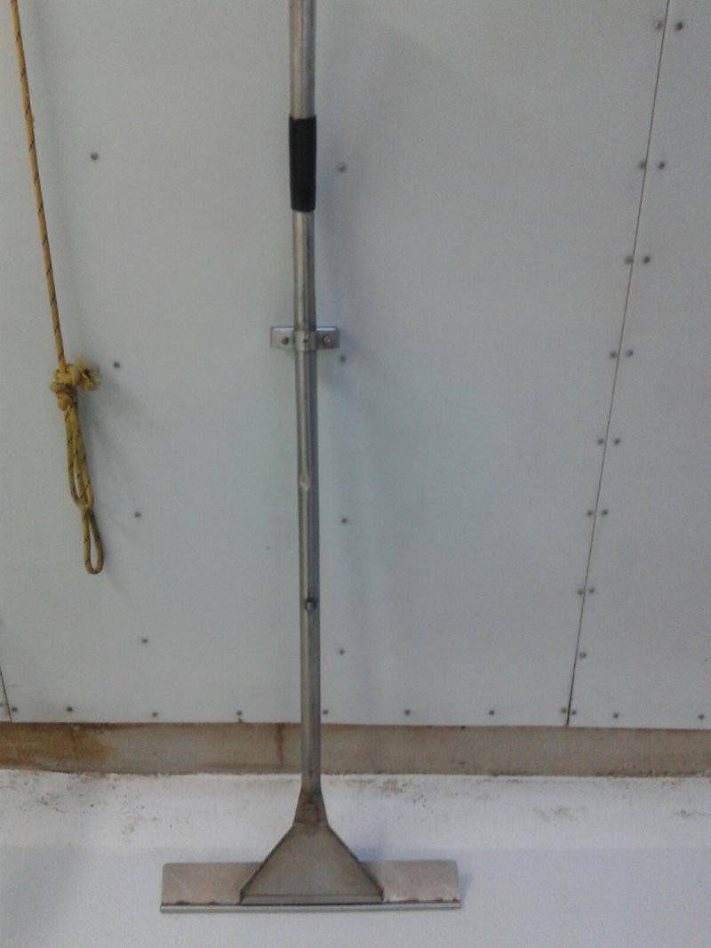

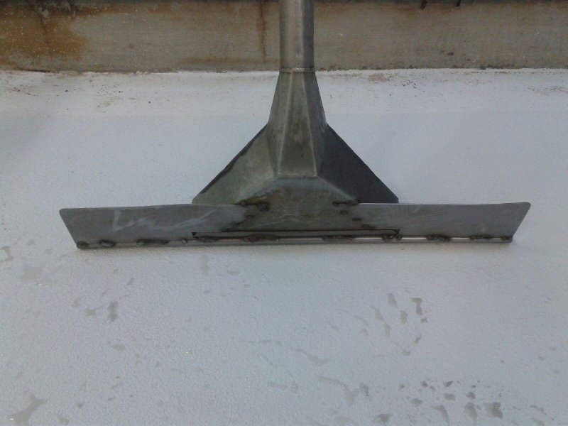

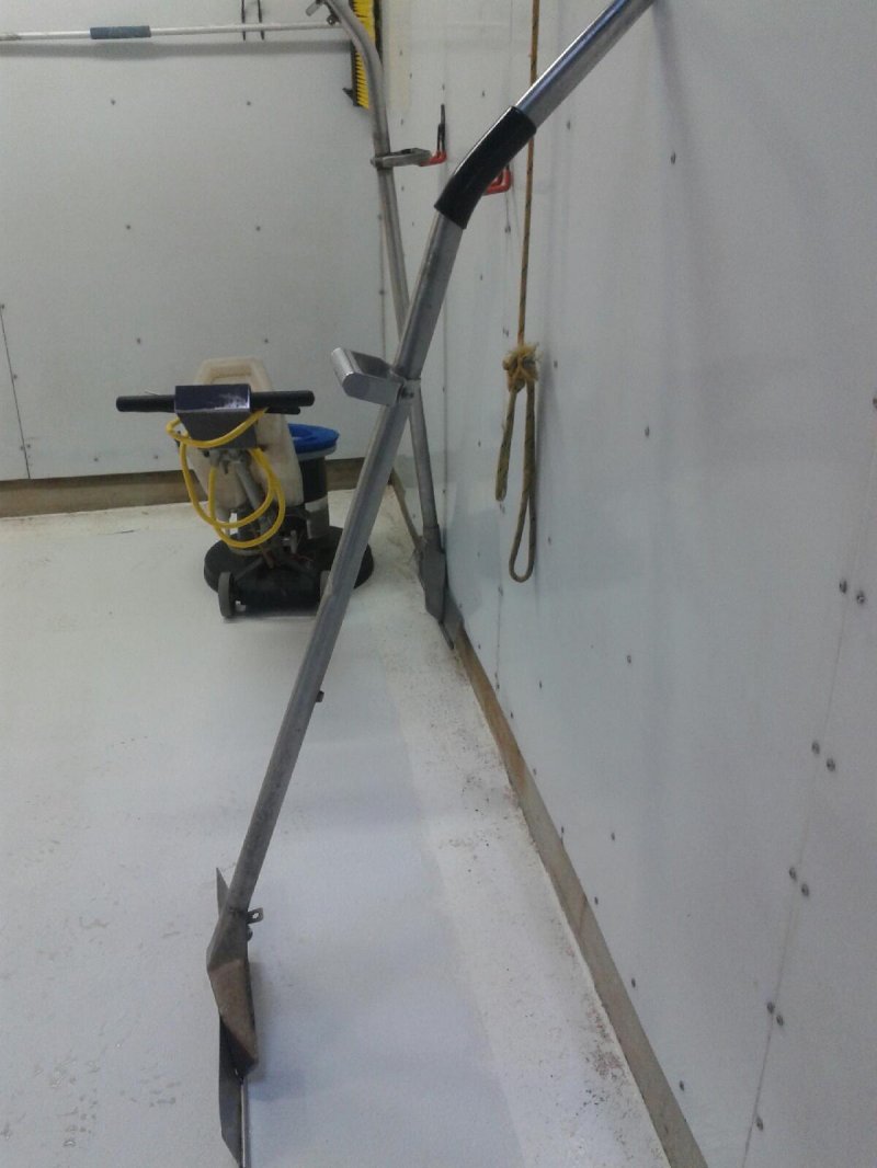

Different strokes for different pokes. A glided wand reduces agitation by allowing a fat piece of plastic to skim over the carpet surface. A wide scraper tool also might have a tendency to skim the surface without much compression. A narrow plastic under a heavier tool on a soaked and lubed up rug...His theory (and practice) of using a glided RE for pit agitation is something I'd like to see tested more. Not to offend Brian but arnt you the company that wont let your on location techs use glided wands?![]()

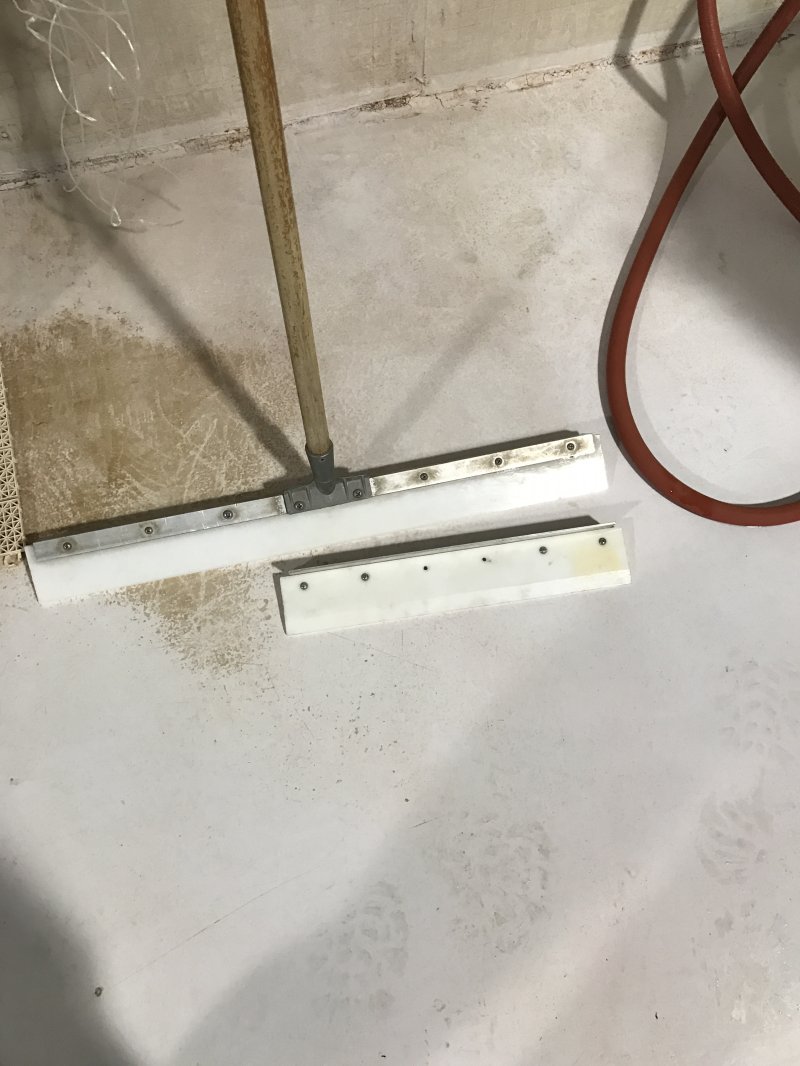

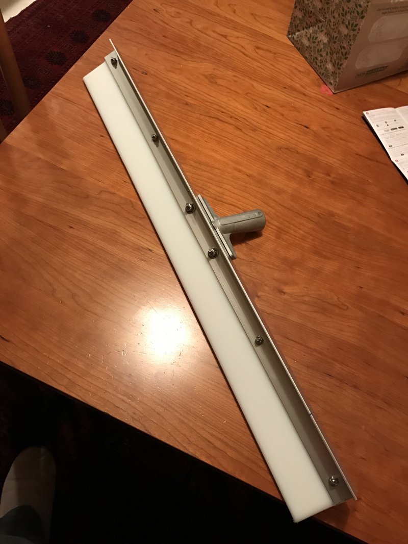

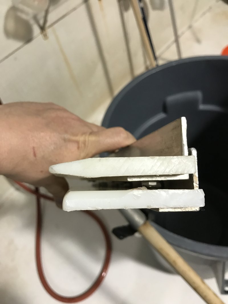

LOLDifferent strokes for different pokes. A glided wand reduces agitation by allowing a fat piece of plastic to skim over the carpet surface. A wide scraper tool also might have a tendency to skim the surface without much compression. A narrow plastic under a heavier tool on a soaked and lubed up rug...
(We have roll-a-jet washer, so don't need this tool. I was thinking of all the people that could use a better method of soil removal until they have enough work to spend the 350k.) Knowing how the compression roller works in the machine, I believe a roller head would be better, as it would be less likely to damage a fragile rug (be more idiot proof). This is the "urban/backwoods/quick and easy/we have one of those" version.
