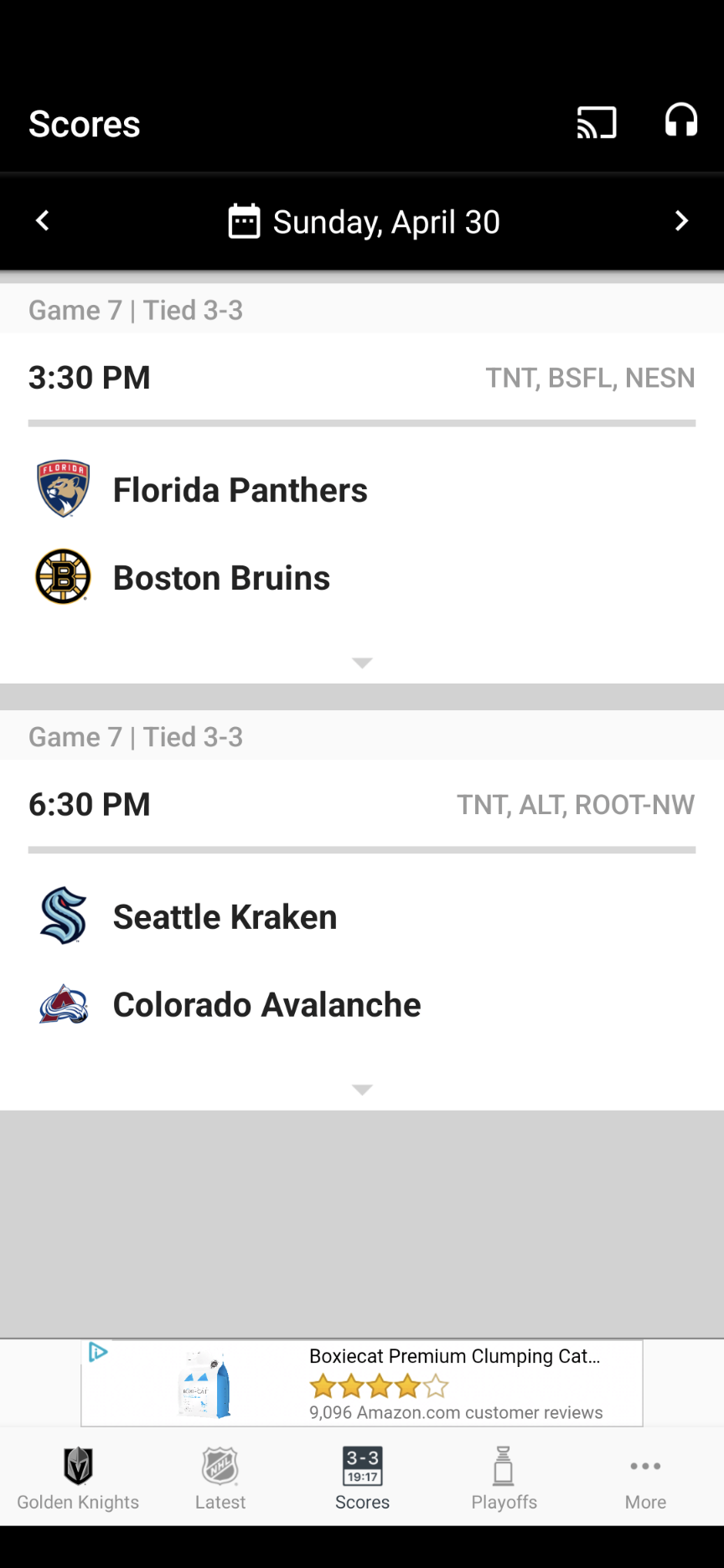

I spend no time thinking about piss.
Two game 7's today fellas!
Reactions: SamIam
