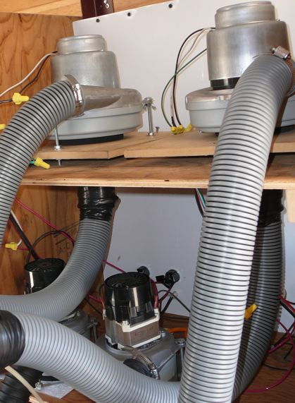

Jerry used two of our new 8.4" Lamb Vacs (LMB5A)
in conjunction with two of our LMB2A vac motors.
This is the 17" hg sealed vac photo:
It maintained over 10" hg at the wand, when cleaning today.

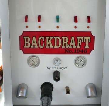

Here is the front of the machine:
Here are the vacs:

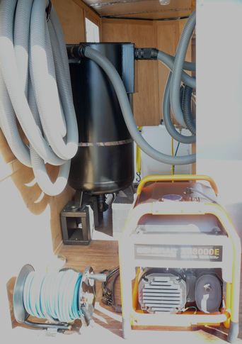

Large Dual Filters in Recovery Tank for Each Vacuum string connection

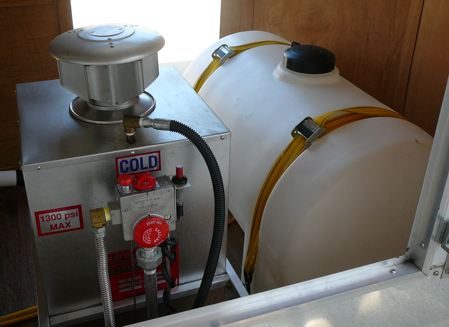

This is the 1300 PSI Little Giant Heater & Tank for Tile & Grout:
8000 Watt Generator + Recycled Recovery Tank
(He also uses 220 VAC power)

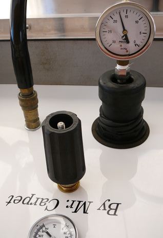

performance is the most important....but... presentation is everything...maybe it is just a me thing ..but when I see wire nuts and unsupported wires...rolls of electrical tape holding things together...and nerf football vacuum relief valves.....then I start to question everything else...

It is a air compressor tank.
Larry
I've made a few garage mounts using 60 gallon compressor tanks, they work like a charm and already have a 2 inch thread on the conical bottom for smooth draining. His doesn't look like the ones I've used, never seen one with a flat top before.
