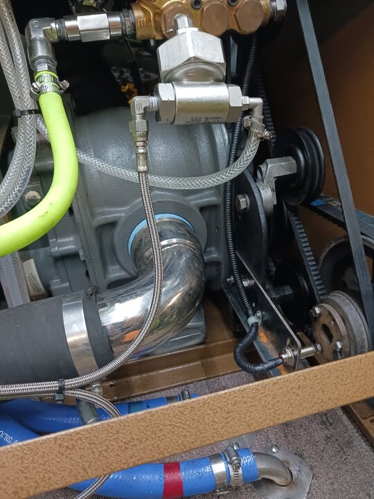

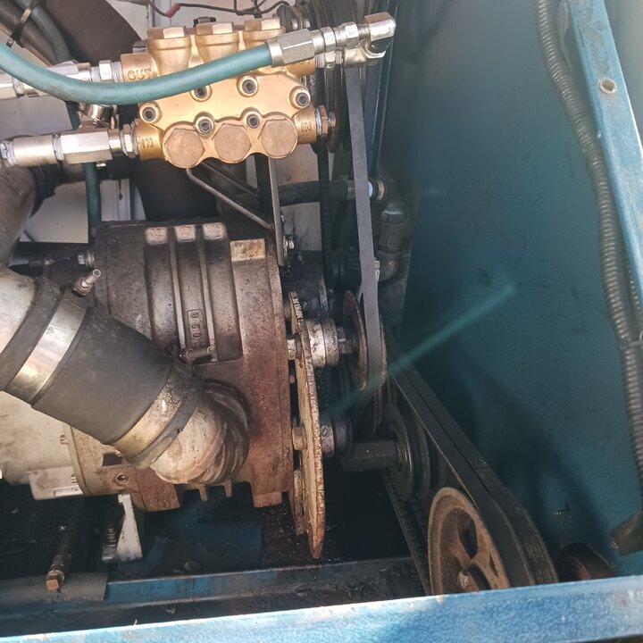

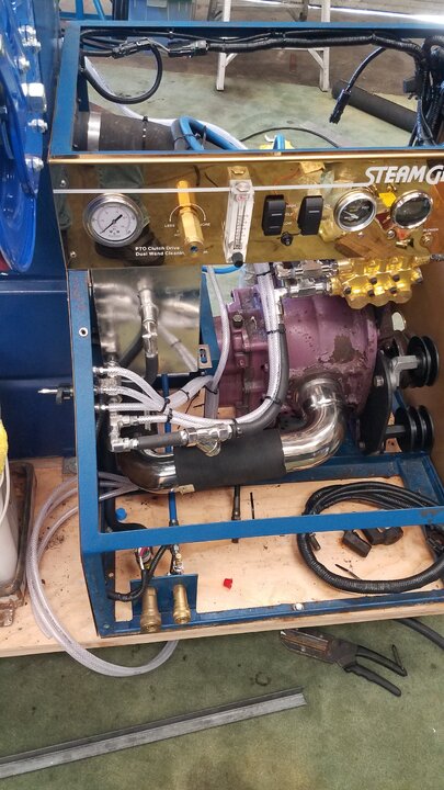

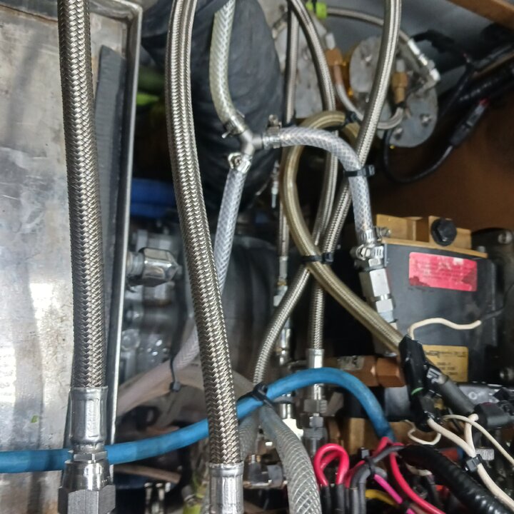

That's cool Dwain-o. I really like the adjustable belts with the idler pulleys, and the simple driveshaft construction. I will challenge you on something though, I think this CDS 4.8 is even more accessible than your sexy Steam Genie. If we consider removing your panels on par (or close enough) with removing my driver and passenger seats, then it seems to me my layout is way more open and accessible as it is spread out across the space between the driver and passenger seats as well as about 20" or so behind each of those seats, like wide open, rather than stuffed in a box. I'll remove the seats and share some pics tomorrow.

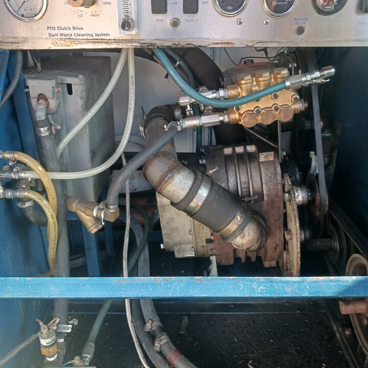

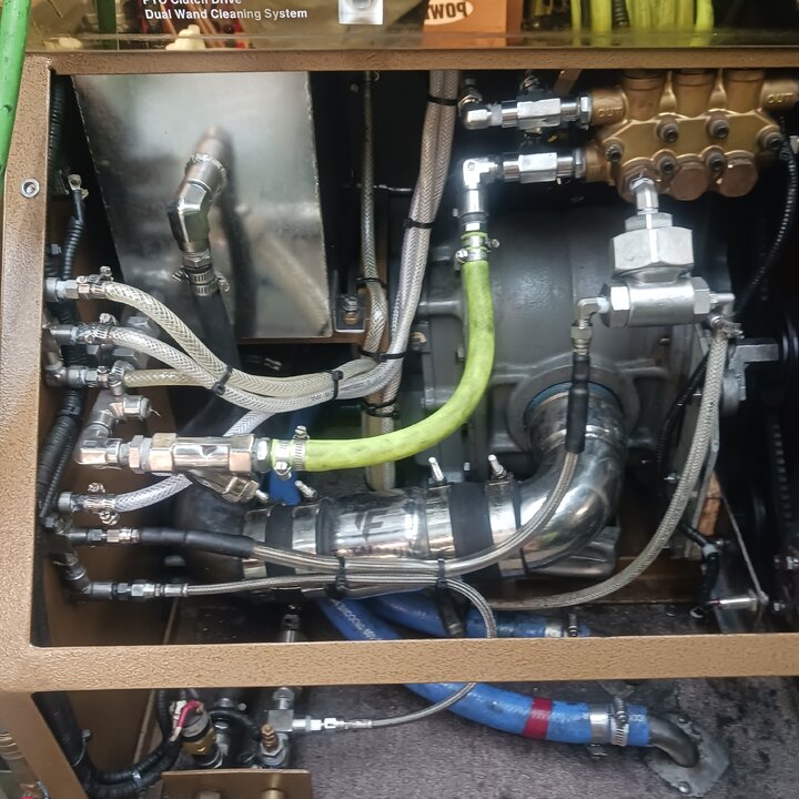

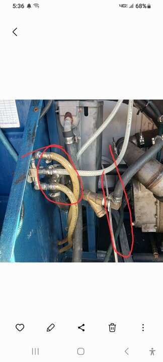

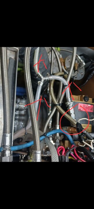

Heres what the insides of a "near original " steamgeni pto looks like the 3 hose valve on the left (red outlined) is chemical tank selector (not stock ) and white duplex wire is waste pump other than that its a stock 2000 steamgeni pto with 10,363 hours as simple as a powerful machine can get 3 belts 4 hoses a pump n a blower 3 tube and shell heat exchangers a lot of open space still in a 3×3 box tucked behind the drivers seat
20250906_173314.jpg 20250906_173425.jpg 20250906_173446.jpg Screenshot_20250906_173641_Gallery.jpg
Reactions: Bryce C
Dwain Ray
Jul 22, 2020
663
View attachment 132463 View attachment 132464 View attachment 132465 View attachment 132466

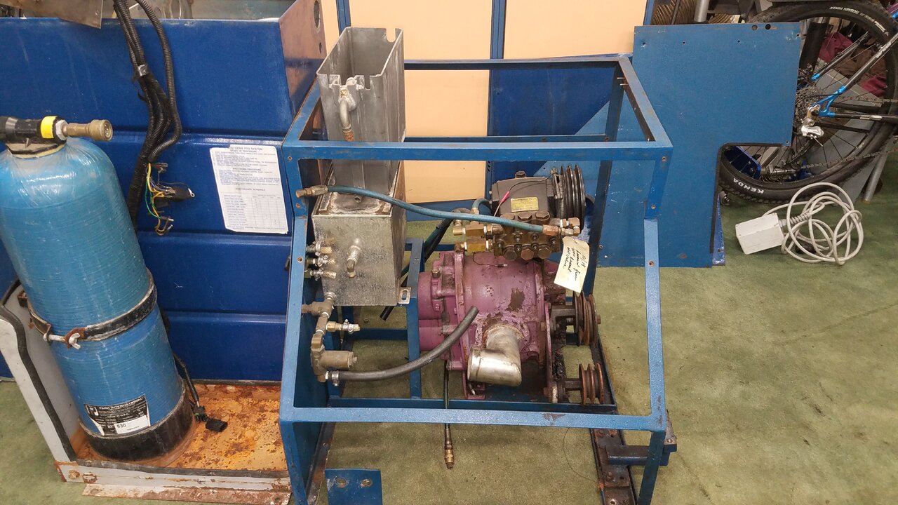

Here's a side by side Frankenstein vs near original
20250906_173446.jpg 20221108_170827.jpg 20250906_173425.jpg 20241109_153921.jpg 20250906_173322.jpg 20250208_160041.jpg 20250906_173314.jpg 20250208_160041.jpg 20250906_173425.jpg
Reactions: Bryce C

That's sweet Dwain. Thanks for the pics. I like simple!

Your a badass mechanic Dwain. Your machine looks so much cleaner and kickass than the original Steam Genie!
Keep in mind your comparing a 3 year old machine with 1,400 hours on the clock with one thats pushing 26 years old with over 10k on the clock. There's alot more shit in frankinstiens box, last step chemical injection, thermal relief waterbox overflow drain , high pressure cleanco & salsa heat exchangers tachometer and shaft sensor . Remote start/stop pump or enitre machine,dual chemical tank selector. Dual wastepump float switches with auto and manual with auto stop. Remote excess blower grease collection. But most importantly everything including control panel is all compactand accessible in a 3×3 box . I will have to admit, theres alot more space to work in the original. But just like cars today the more features the less space. Compared to some of the shit ive seen on the market for what frankinstien is and does he's still very very simple and easy to maintain
Reactions: Bryce C

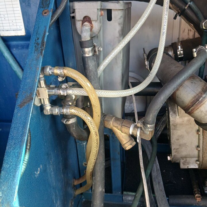

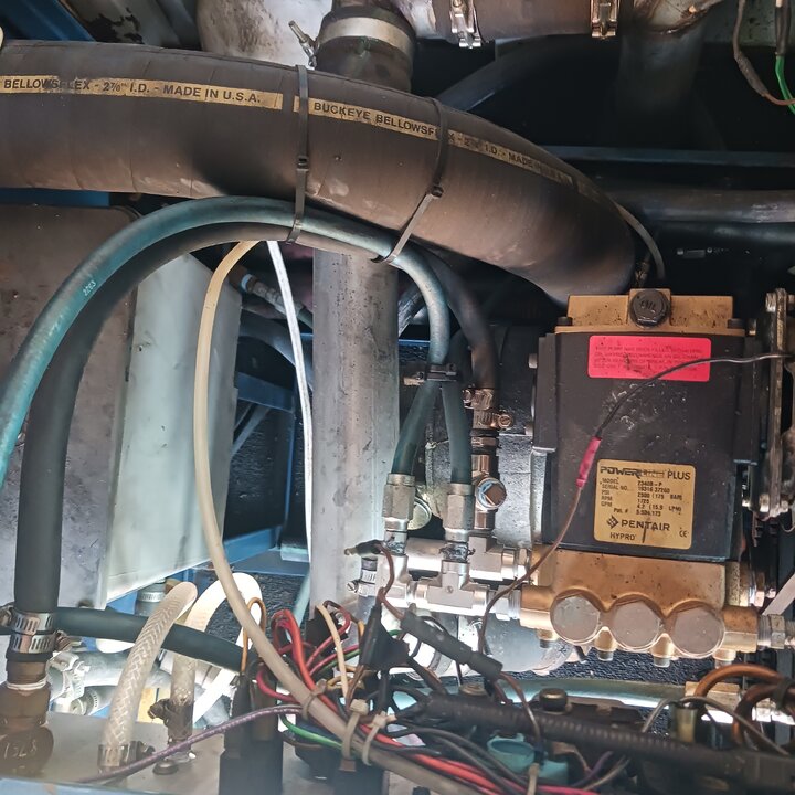

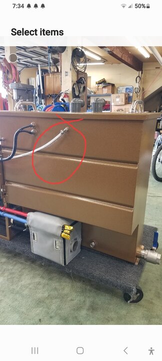

I installed a 140° thermal relief in frankinstien where the bypassed water reenters the pump the pump pumps cold water but when im not using it the bypass regulator recirculates back into the pumps inlet and as it's recirculating with each pass ot heats up so if or when it reaches 140° it dumps into the wastetank using the same hose y'd off from the chemical pump prime i also added a check valve to prevent air from entering thru the thermal relief in the pictures circled is the thermal relief (brass) with check valve( stainless connected to hose) lower left hose is chem pump discharge top is to waste tank
Screenshot_20250906_192423_Gallery.jpg Screenshot_20250906_193410_Gallery.jpg
Reactions: Bryce C
