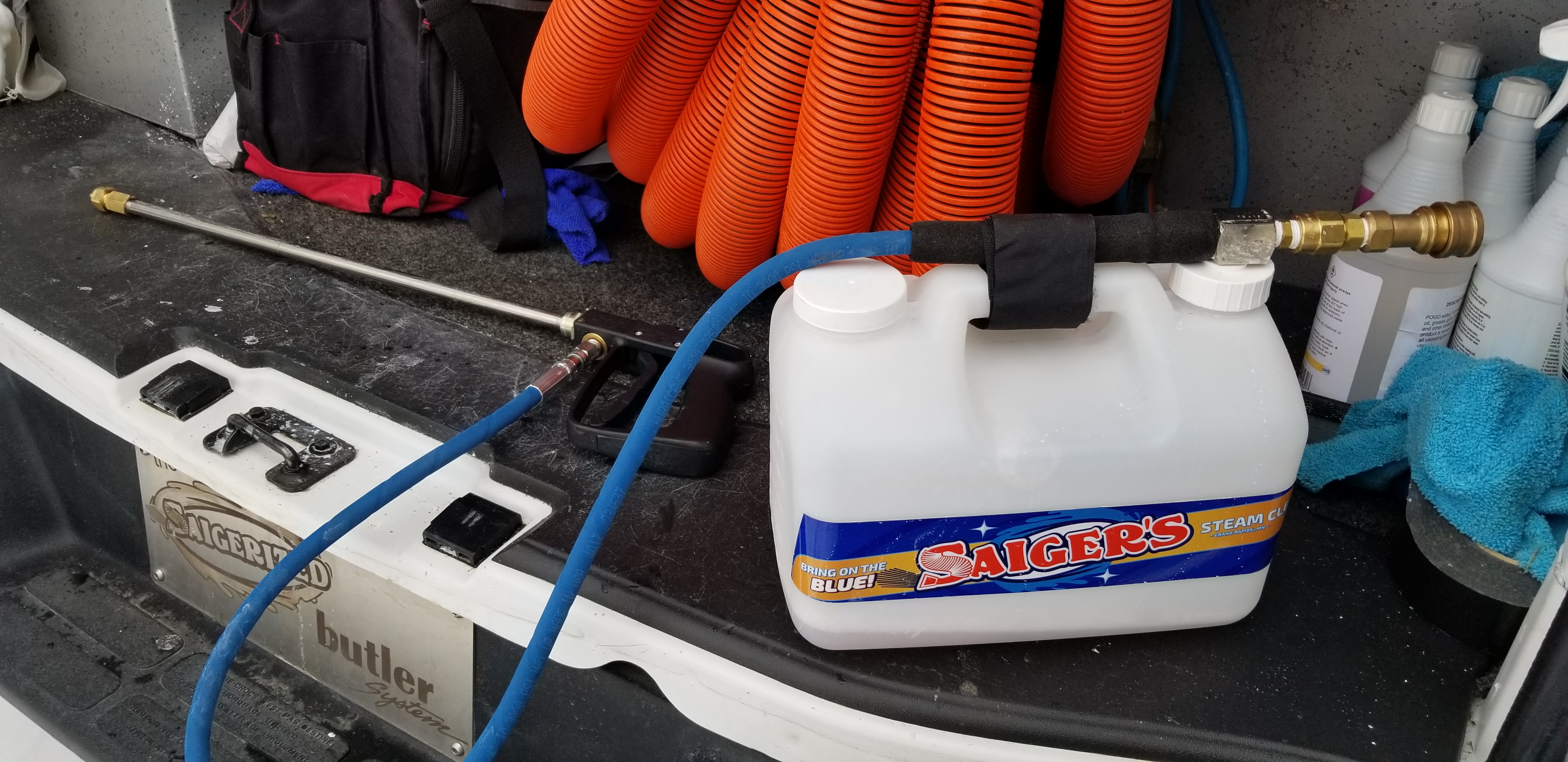

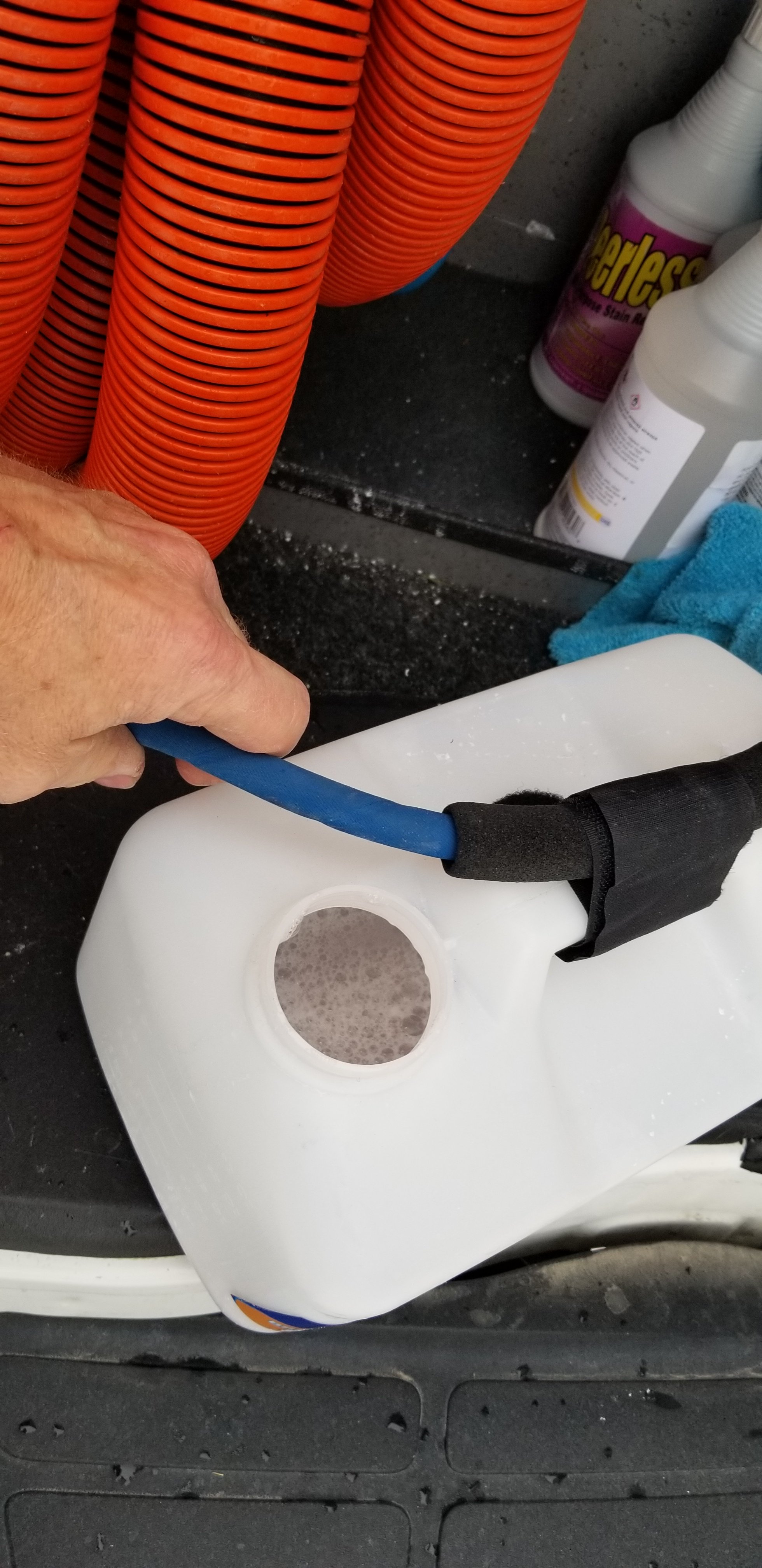

All you need is a bottle of vinegar in the truck. At the end of the day, just put the siphon hose in the vinegar and blow a little through it.

Yes...that's what then did on the six quart units. If look in pics, easy to get to the large opening now because the rubber hose will move off to the side.
