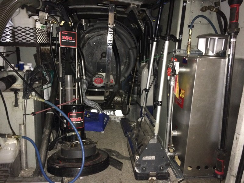

So I was thinking about placement today for a little giant, for those of you thst have them how hot do they get? How much room do they need around them or can I put it tight up against the wall of my van or my water tank. I was also thinking about putting it just rear of my seats in the center so that it would be partially between the driver and passenger seats.

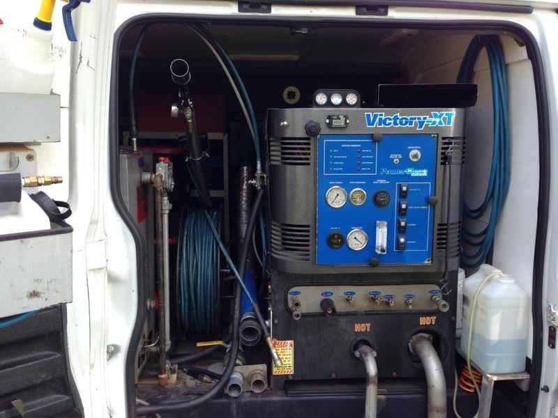

A couple inches is enough. Don't put it by the seats, you'll be sorry(to hot to sit next to). I like mine within arms length of a door so I don't have to climb in to light it. You can see mine to the left of the door.

Shane, that's a nice looking monster(tm)! How many hp? Did the gauges on top come w/it or did you add those?
It's a 31 water-cooled Kholer with a Roots 47. I added the gauges on top. Oil pressure, coolant temp & volt meter. I don't like to wait for an idiot light to tell me something is wrong.
