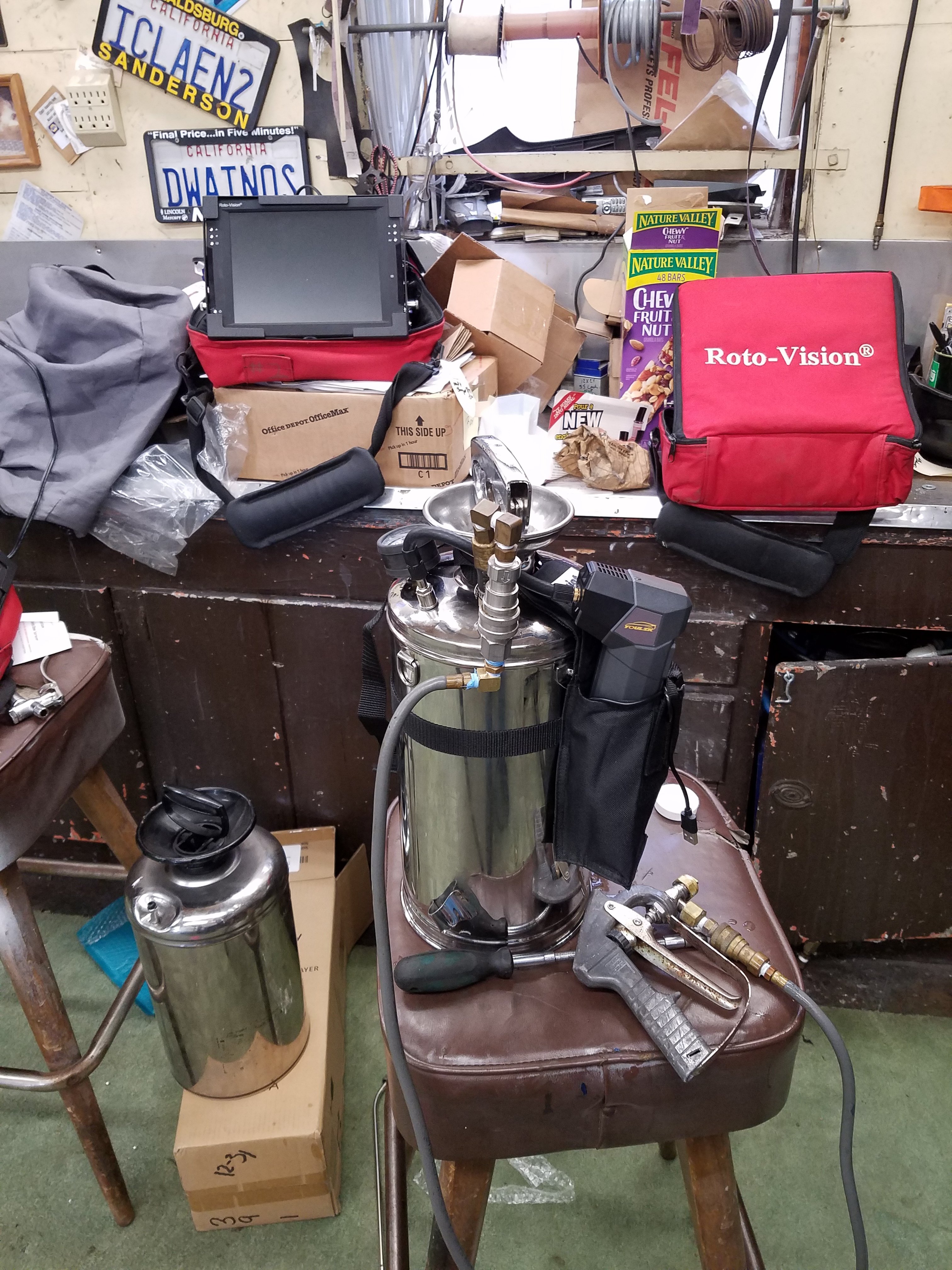

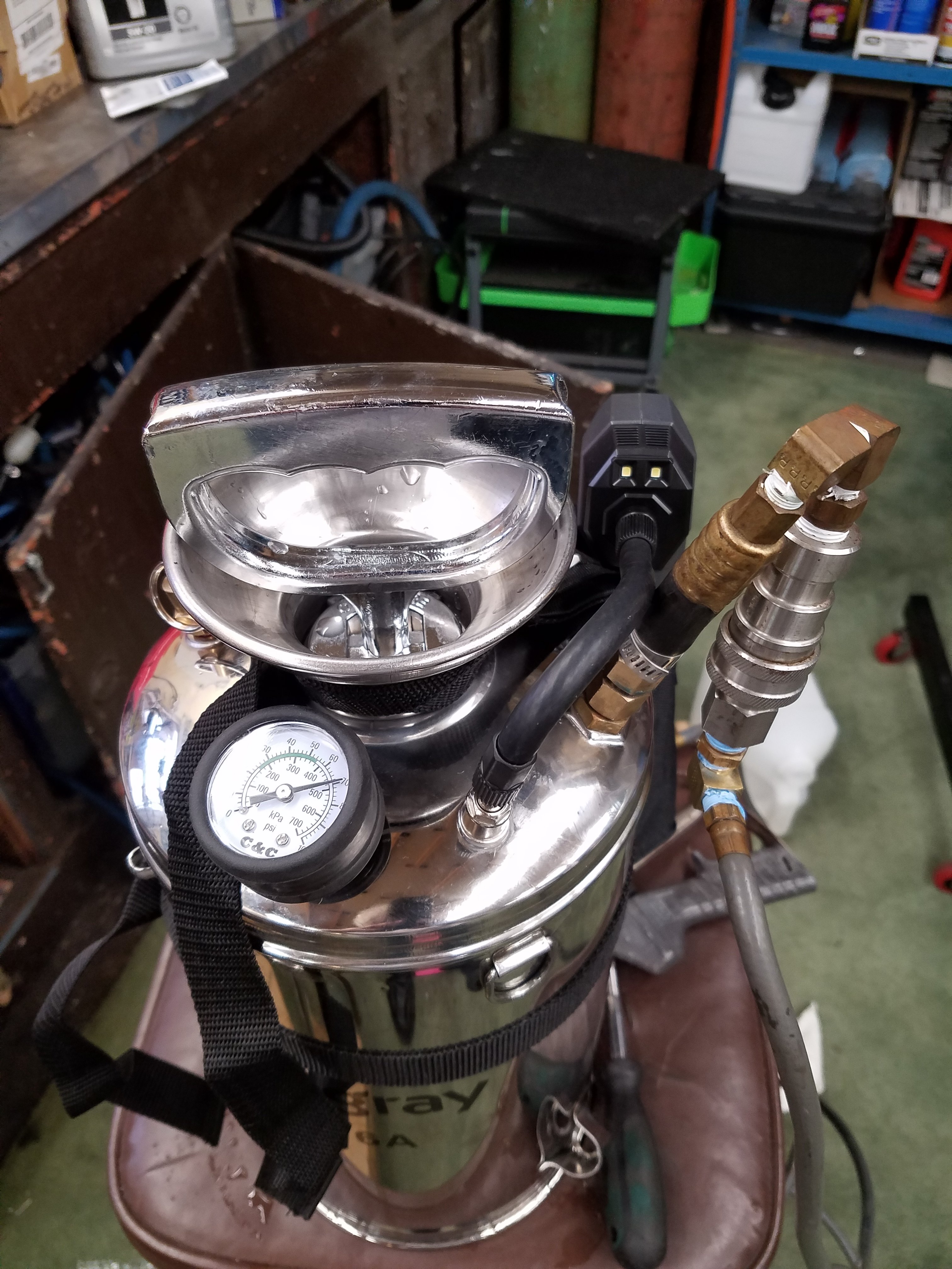

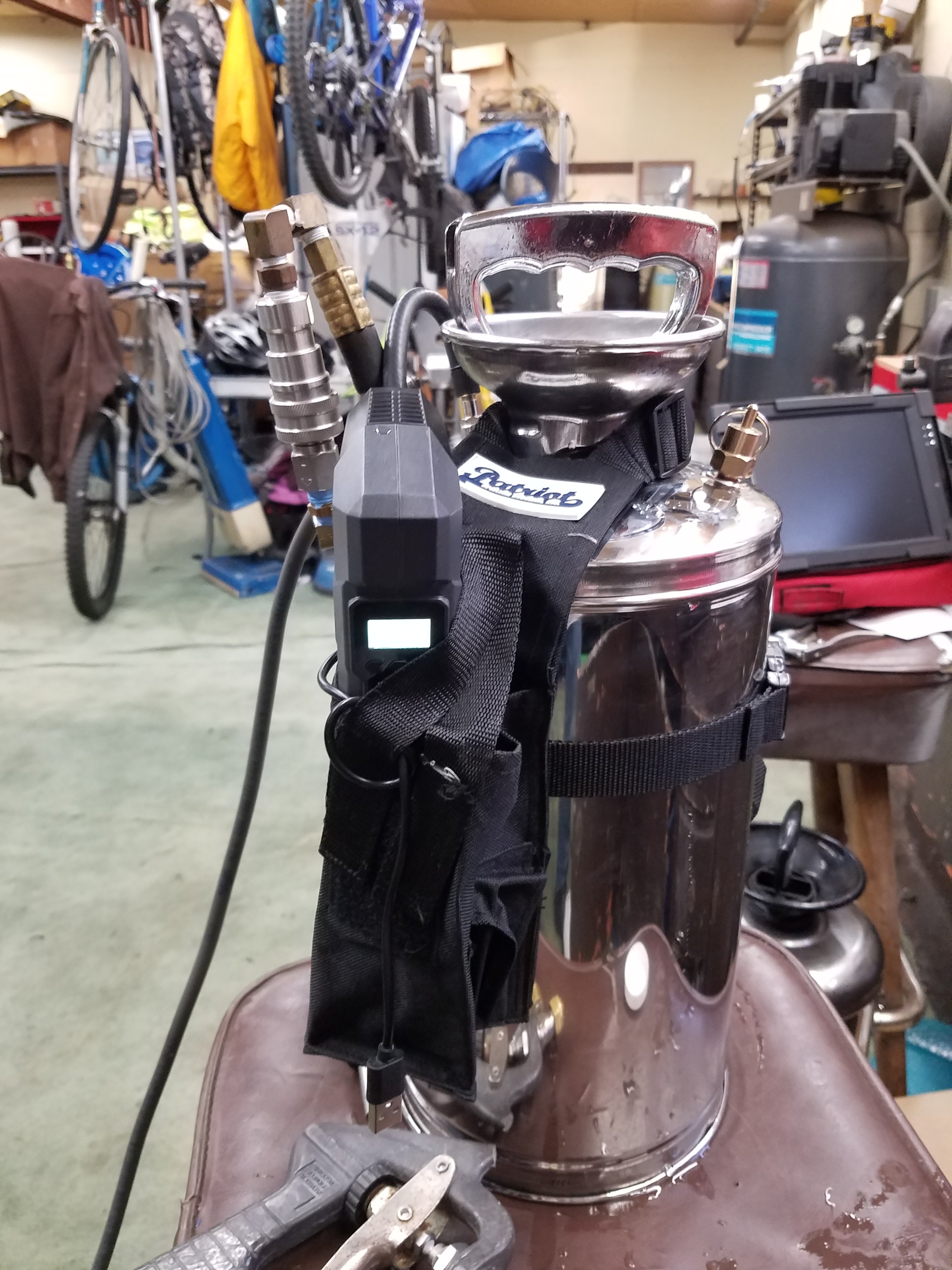

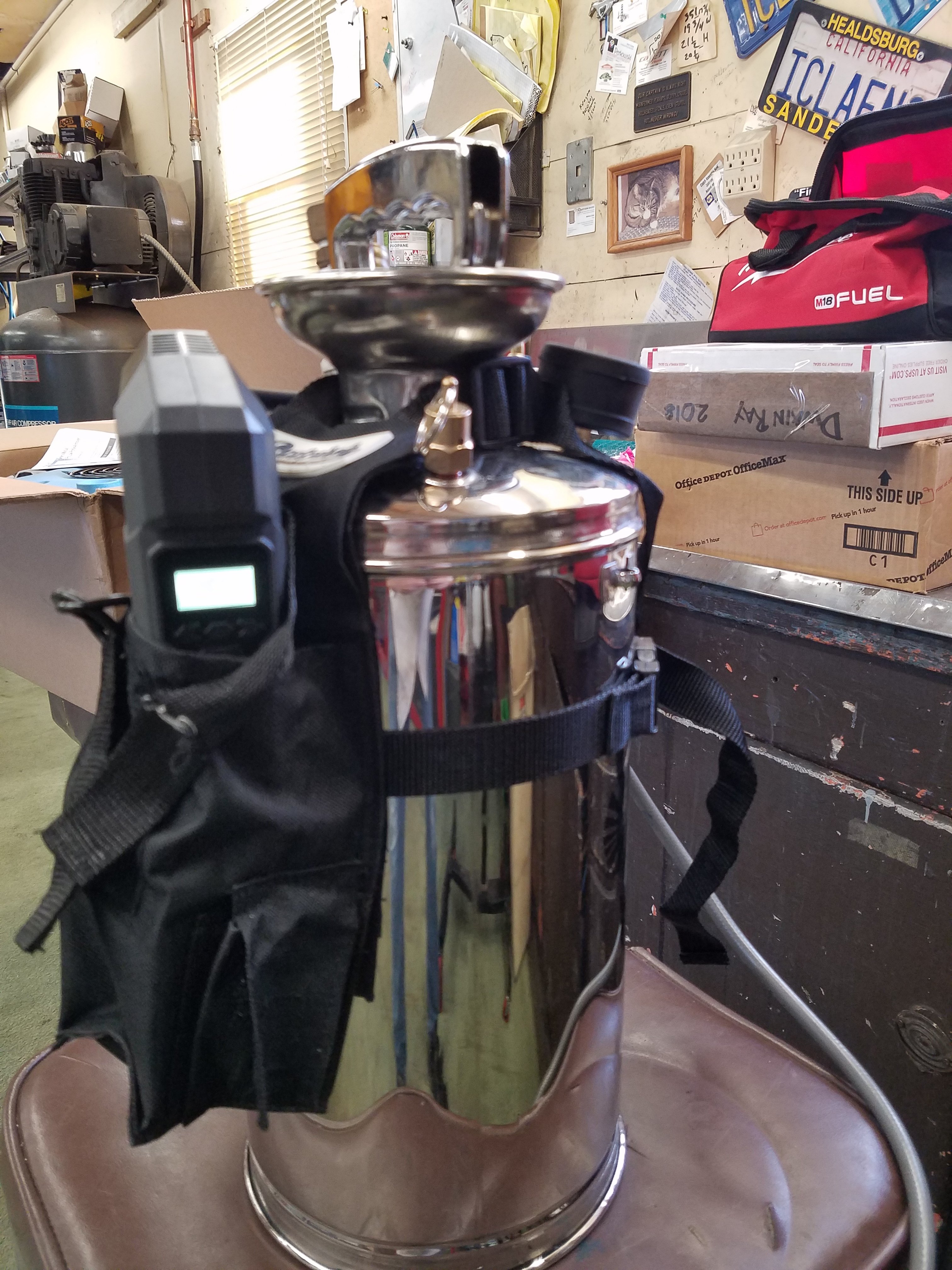

If you're doing 2000 chairs you need one of these , i only did 350 chairs for a church with 2 of us 1 presprayed and brushed and the other cleaned this sprayer saved alot of time pumping up, you can't see it in the pictures but it has a 15' hose

I have a multisprayer and a Penguin 5 gallon battery sprayer.
they are perfect for those large upholstery jobs. And no frankenstein contraptions.

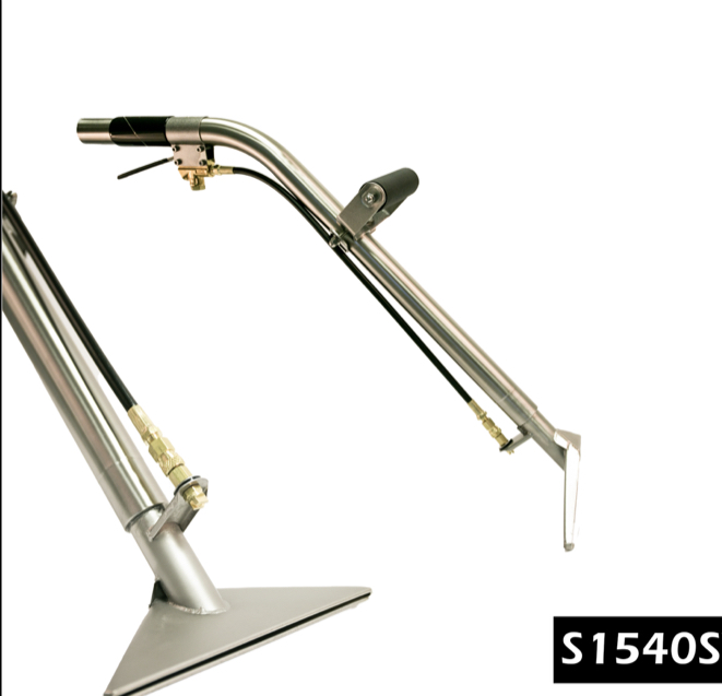

For trashed upholstery, you're better off with a PMF external jet and turn the pressure down. The internal jets don't have enough flow which is great on fine fabrics but is slow on trashed stuff.
For trash upholstery you’re better off with this uph tool from PMF!
(Jim Pemberton do not read this keep scrolling)7C122FBC-C122-4792-B754-6B749BBEF669.jpeg

When you say internal jets your not speaking of a spray bar with ajustable flow sapphire or rotovac?
