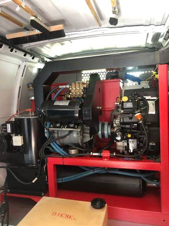

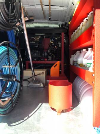

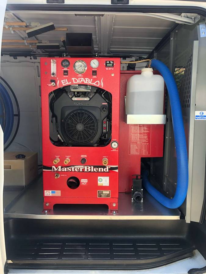

Forget I asked for that promo code lol I saw the option and figured I’d ask since a lot of guys here are friends with Tom. In other words, I took all of you guys’ advice and bought me a solid truck mount set up. Setting me back 25k, thus my “BDCC” attitude @Nomad74 😆

Just checked, 347 hours. And no sir, this thing looks perfect!

Anybody know of a good auto pump out alternative to the $2k versions meant for truck mounts?
how good are you at plumbing?
doesn't your El Diablo have a generator to run the fuel burner?
If you have 110vt available you can plumb a sump pump in the tank.
Appx $400 parts and a half day's labor cutting, drilling, plumbing and wiring
underground sch 40 electrical conduit makes the plumbing from tank out to "wherever" you want it a breeze.
water tight conduit fittings thru the tank and couple it to pump PVC stack using check valve boot
If you buy a pump that will handle sewage ('bout $200) you'll never have to worry about carpet lint and hair covering/restricting pump inlet
if 12vt is needed, there are a lot of transfer pumps available that can be plumbed in.
But don't know which ones are powerful enough to pump out while under 14hg tank vacuum

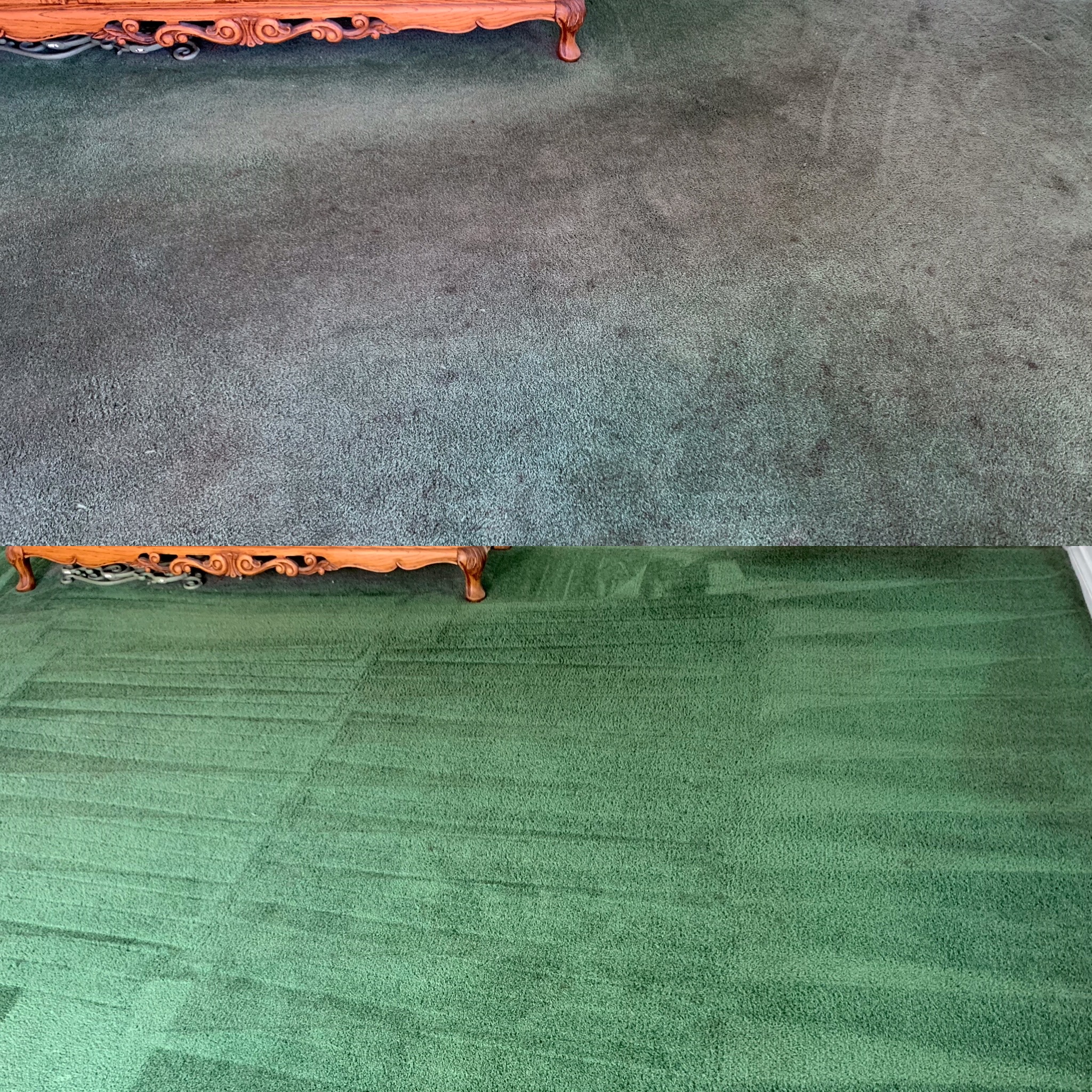

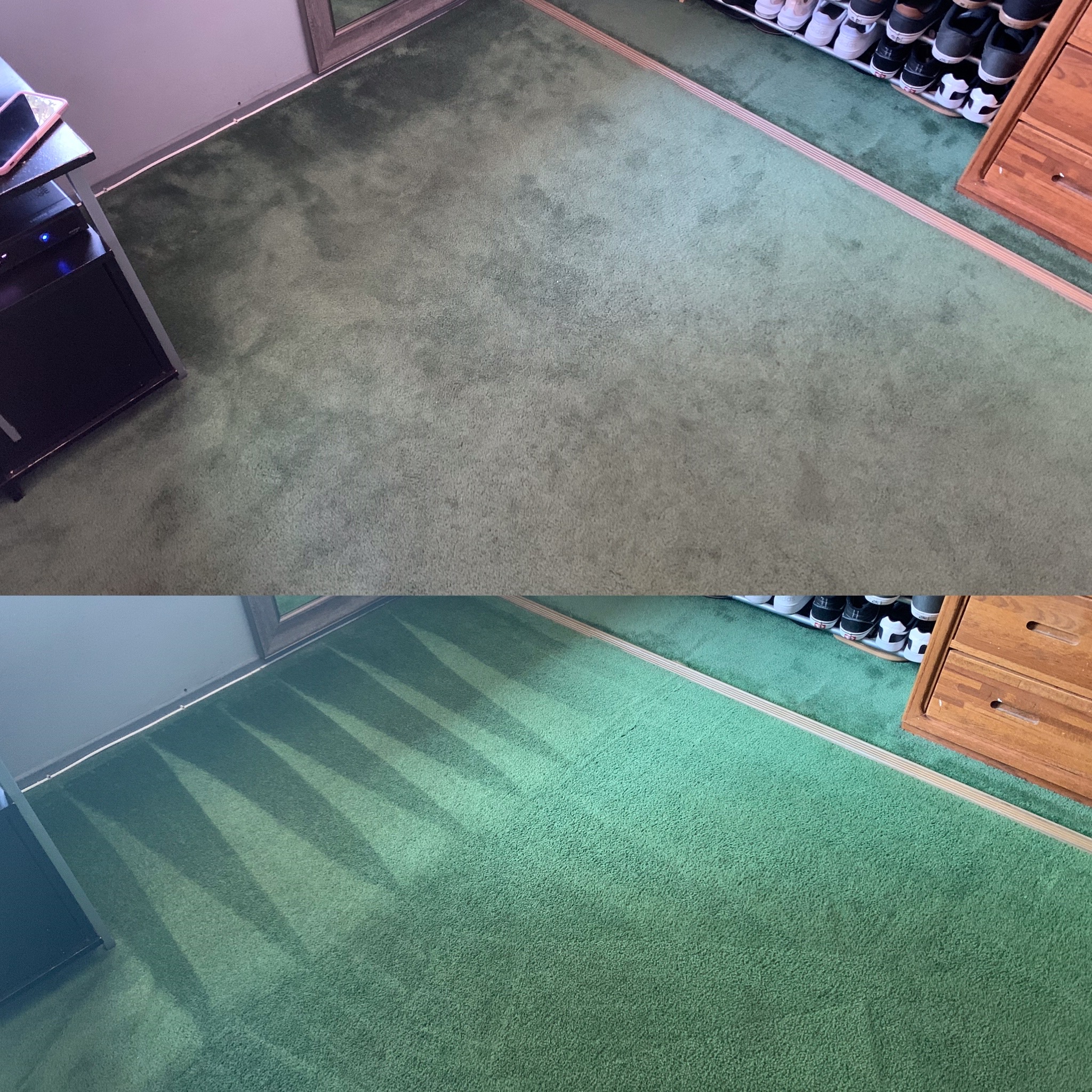

How’s it going everyone? Did my first cleaning today (my fam’s house) And for the most part things went pretty smooth. Something I kept having issues with was switching the solution line between tools. There was too much pressure to pop the line onto anything else without extreme force. What am I not understanding here?
Here’s a couple pics of the job too
BF00F533-BBD6-4D0B-9068-C123722E9163.jpeg A0267FC1-D261-4C32-9C11-6CC38D802278.jpeg

Turn your pump off, release the pressure by opening your courtesy line or bypass, go inside and attach your solution line, go back out and turn on your pressure pump.
One thing to always check before you turn your TM on is that your valve is closed on the solution line. Turn the valve on after you attach to your wand.
