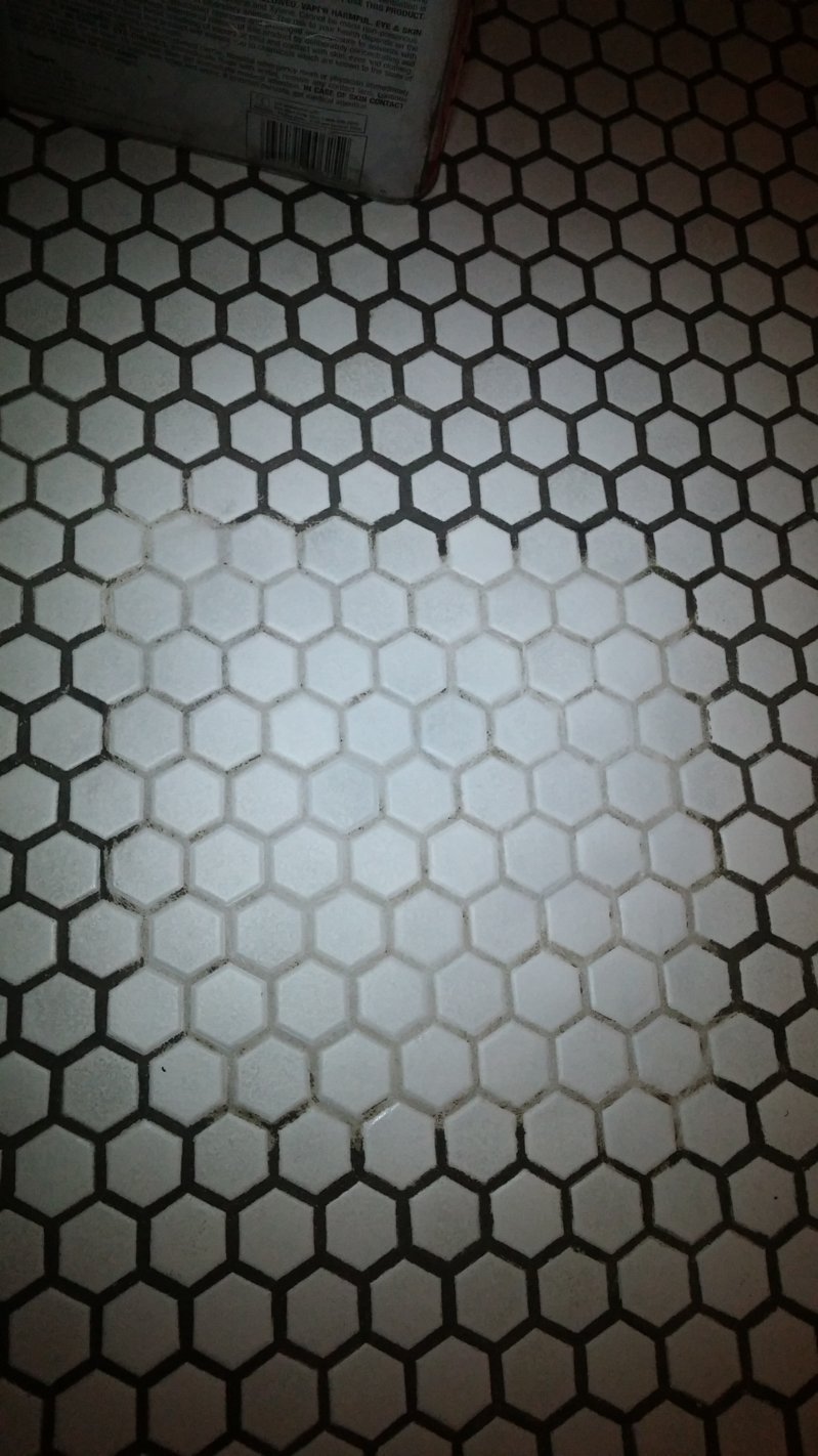

That is pretty freakin awesome, and by the looks at what the others had left behind, you will be very welcomed in that area. Mikey might have just found another GOLDEN spot for a carpet cleaner with passion. Keep it up and you will become the household name.

I don't know why these ugly buildup jobs aren't cleaned using a Turbo?? I did a mosaic nearly identical to this one in a remodeled restaurant, applied a good stripper cut 4:1 short dwell time of 12 to 15 minutes agitated with a carpet groomer brush just to keep low and high areas on equal exposure to the stripper. Then I hit it with my truck mount set at 1800 psi with no heat and years of black grunge under wax layers was gone. no floor machines no abrasive pads (I've see a black pad scratch up a glazed porcelain) Just a steady walk with the spinning spraybar from my Turbo.
