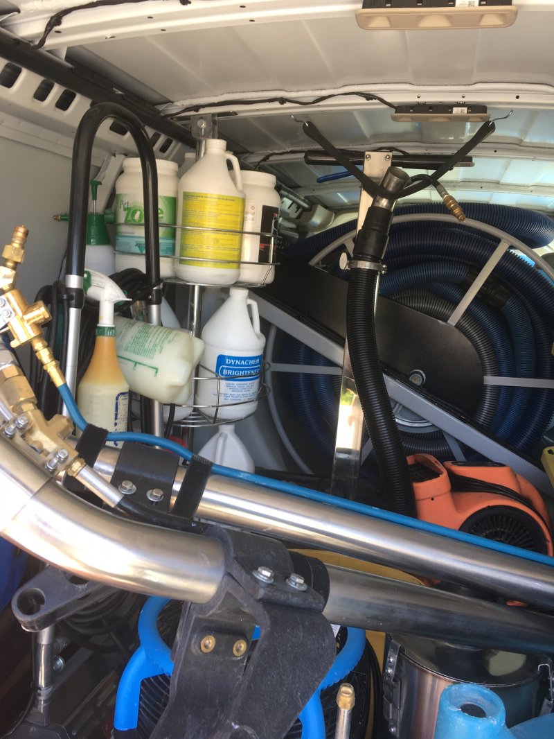

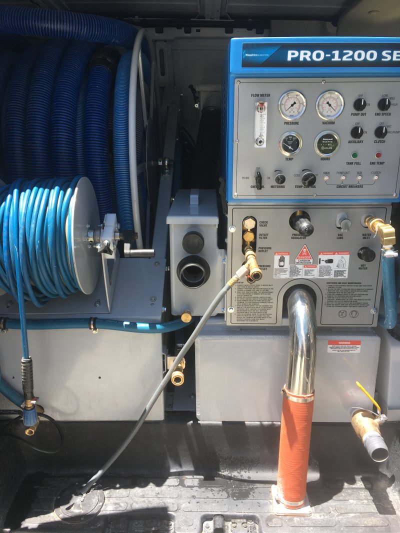

Tool box, rags, tarps, sealadoor, flat mops, multi sprayer, takes..
Where do they go?
Tarps on dash, I use a hydroforce it's in a bucket. Rags and excessories in a plastic container. I don't carry a multi sprayer I have one but barely use it. Rakes behind real with grout brush. I hung the spinner above waste tank.
I'm setting this up for my guys no flat mop.
jcooper
3,232
Jerry Cooper
img_2315-jpg.70348
Omg, you better not let Sam see that wand leaning against the van wall!:eekk:

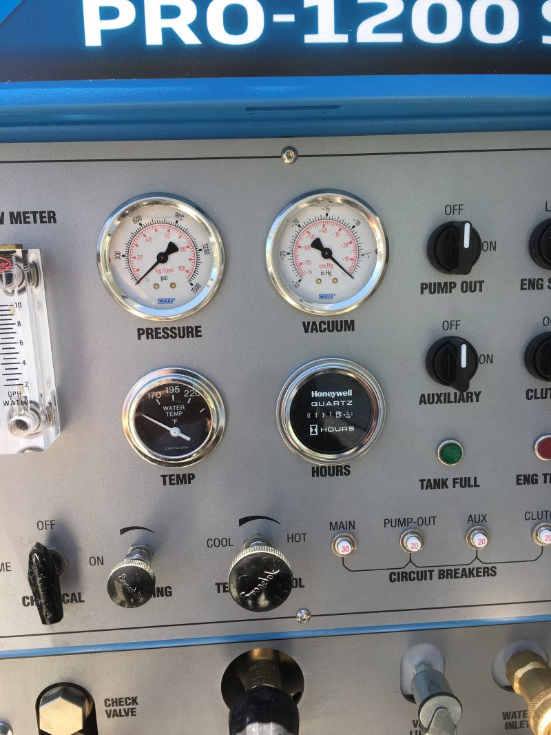

11,531
K so I bumped up the lift so it stays between 12-13, if I want it higher I'll have to add more washers.
But on high it hits about 220 consistently and the hose gets hot.
medium about 195-220.
Feels like it has more vacuum then the 570
On high.

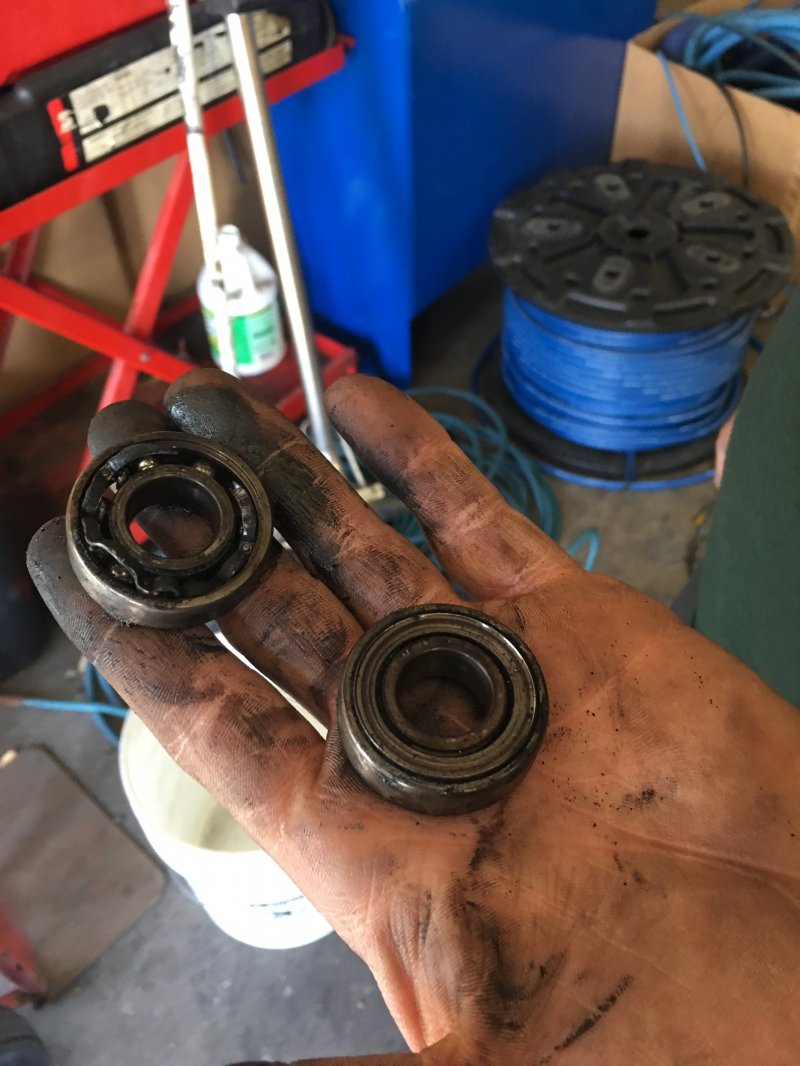

Well we finished I go outside and I smell rubber burning?
Wth is my new pro1200 se on fire????
Why didn't I get a Butler?
Don't say it Saiger!
My guy pulls the vac hoses and holy cow it's starts squealing like a stuck pig!
I panicked thinking broke back
Belt? Clutch or OMG my blower?????
Get to Empire and hour away in Northridge, the tech starts it up YUPP that's sounds nasty, he pulls off the covers
And sure enough.
Everything is great except the small pulley with greased bearing on the tensioner.
One of cased bearing exploded making a dying cat proud.
I was back on the road and home a total round trip and visit of 3 hours, one down, one up, and one to fix. I got some chemicals while I was there.
Besides the heart stopping squeal today, it's a pretty good machine.

Ok this thing will hit 220 and hold it pretty well but it's not as hot as the 570.

So sapphire sent a new serpentine belt and pully for the inside the engine clutch.
It's was a free upgrade, can't complain I'll take free.
