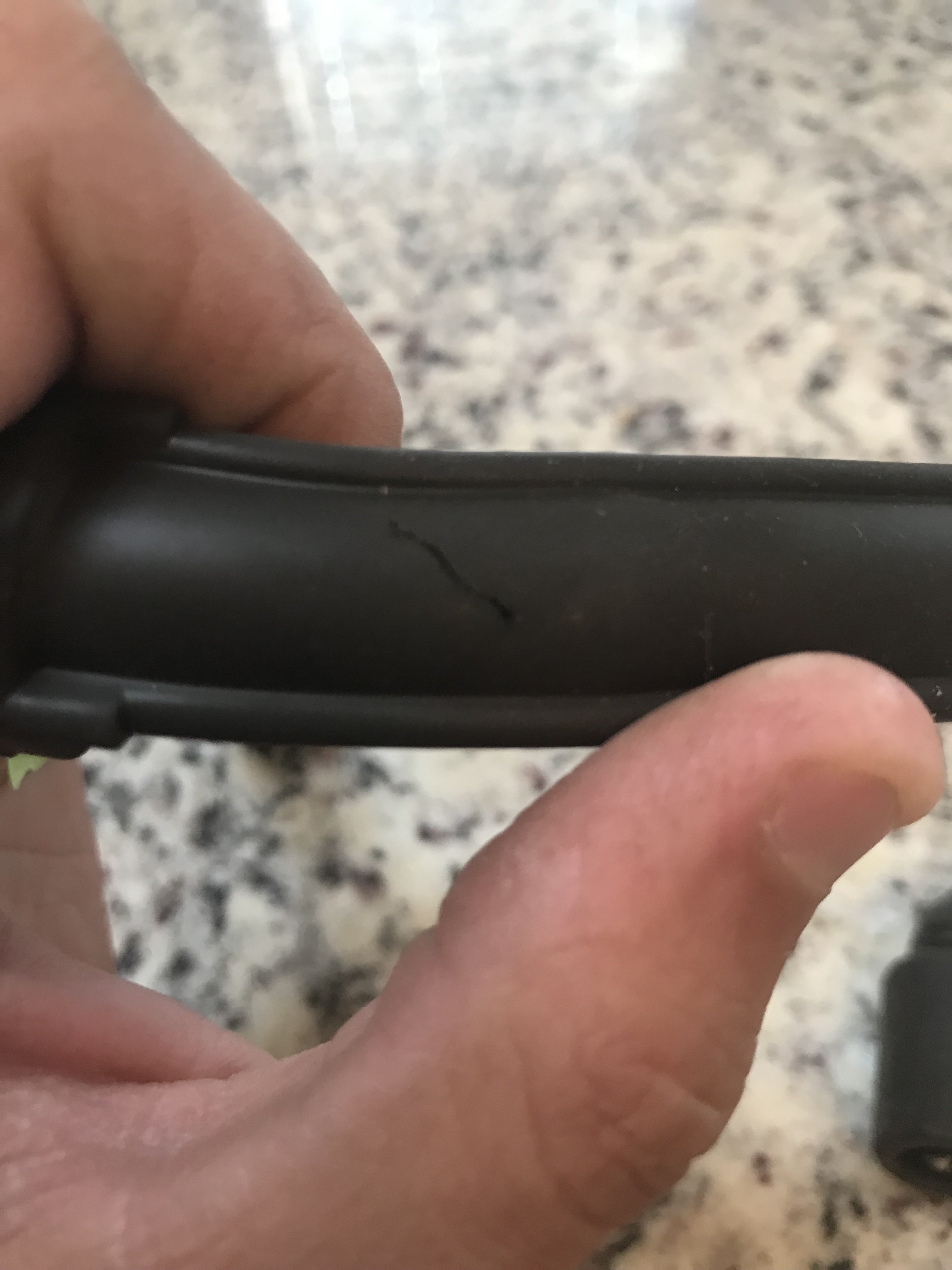

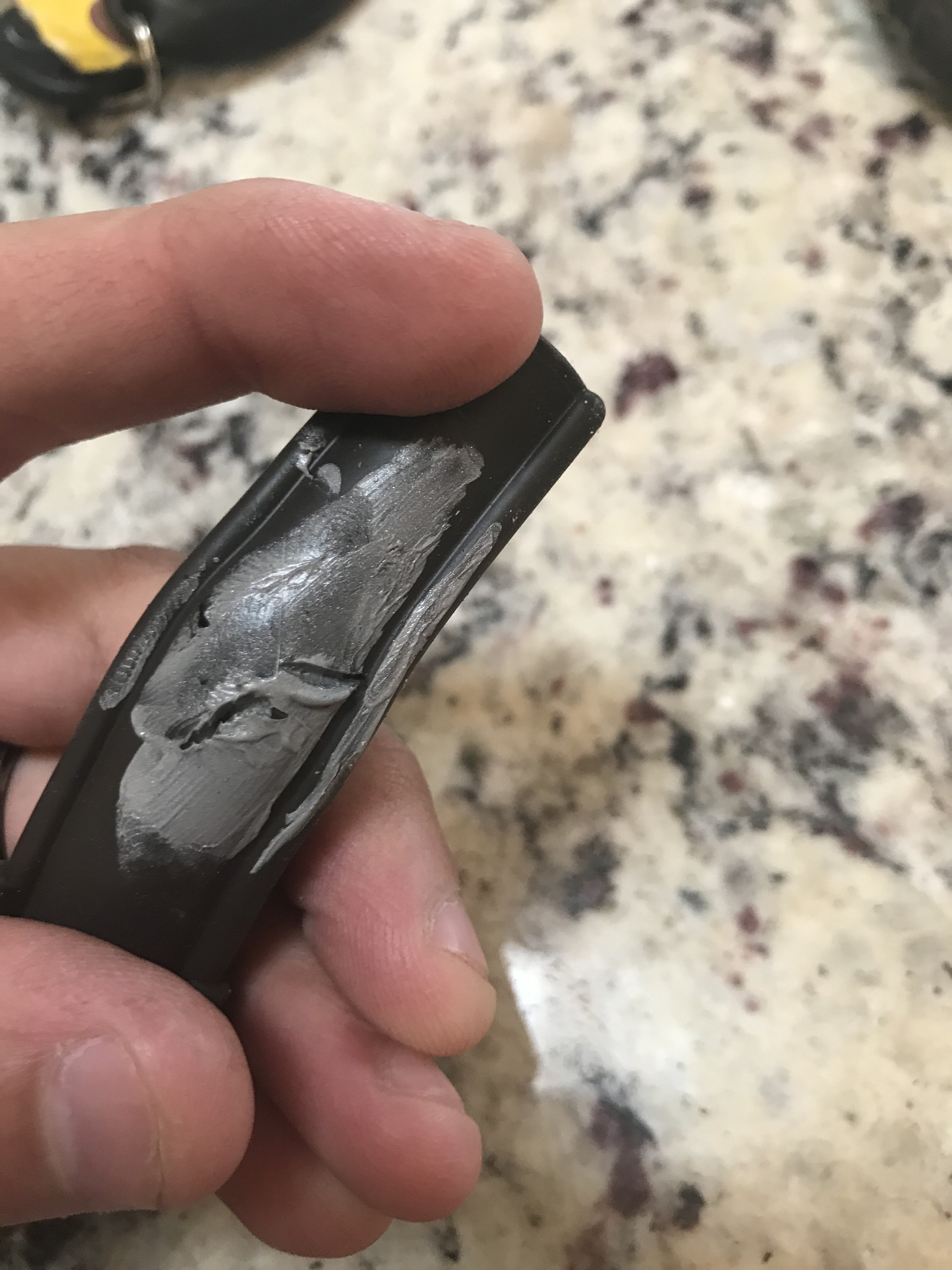

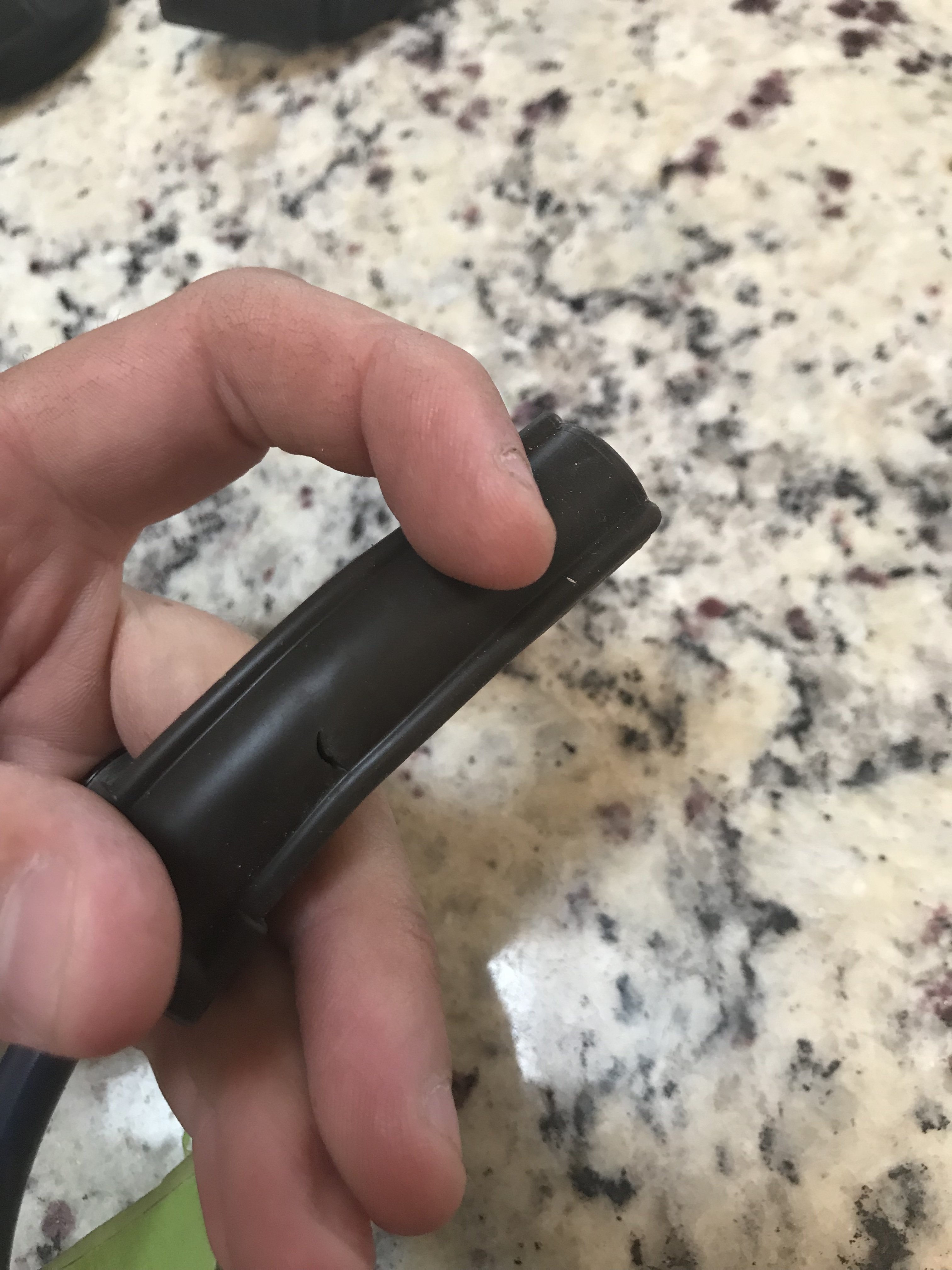

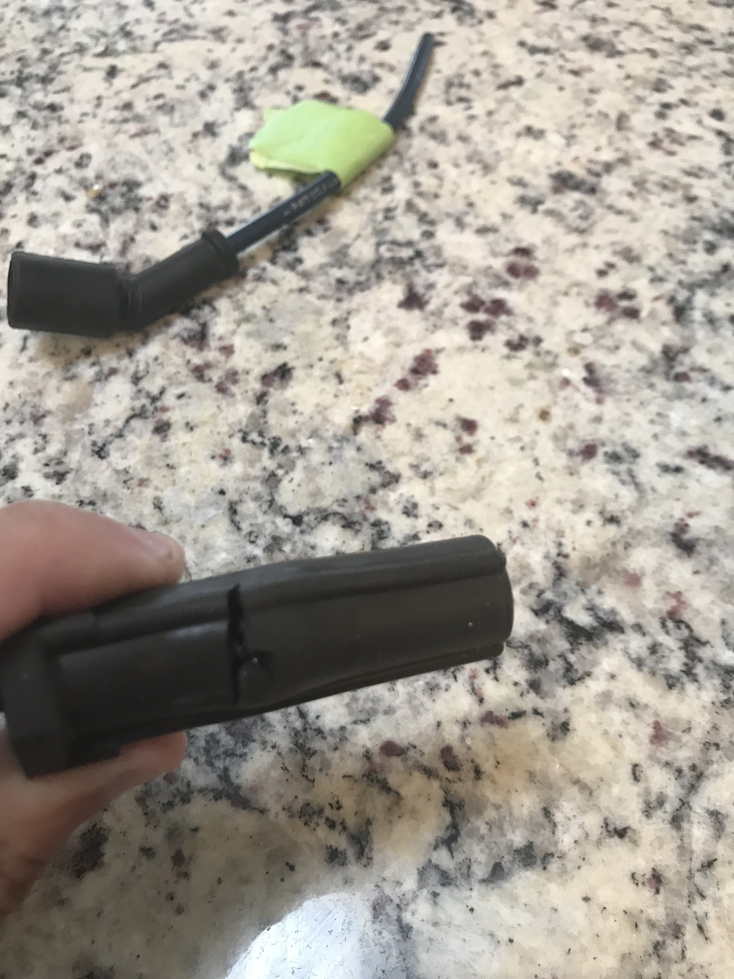

Got the Chevy back today and it’s finally running good again. When the first shop put the wires in they used pliers and tore the insulation on most the wires. They used some silicone to try and patch one of them. Also the #8 wire was barely attached to the plug which was the spark I was hearing during the misfires. Got some new wires and the idle is back to normal.
