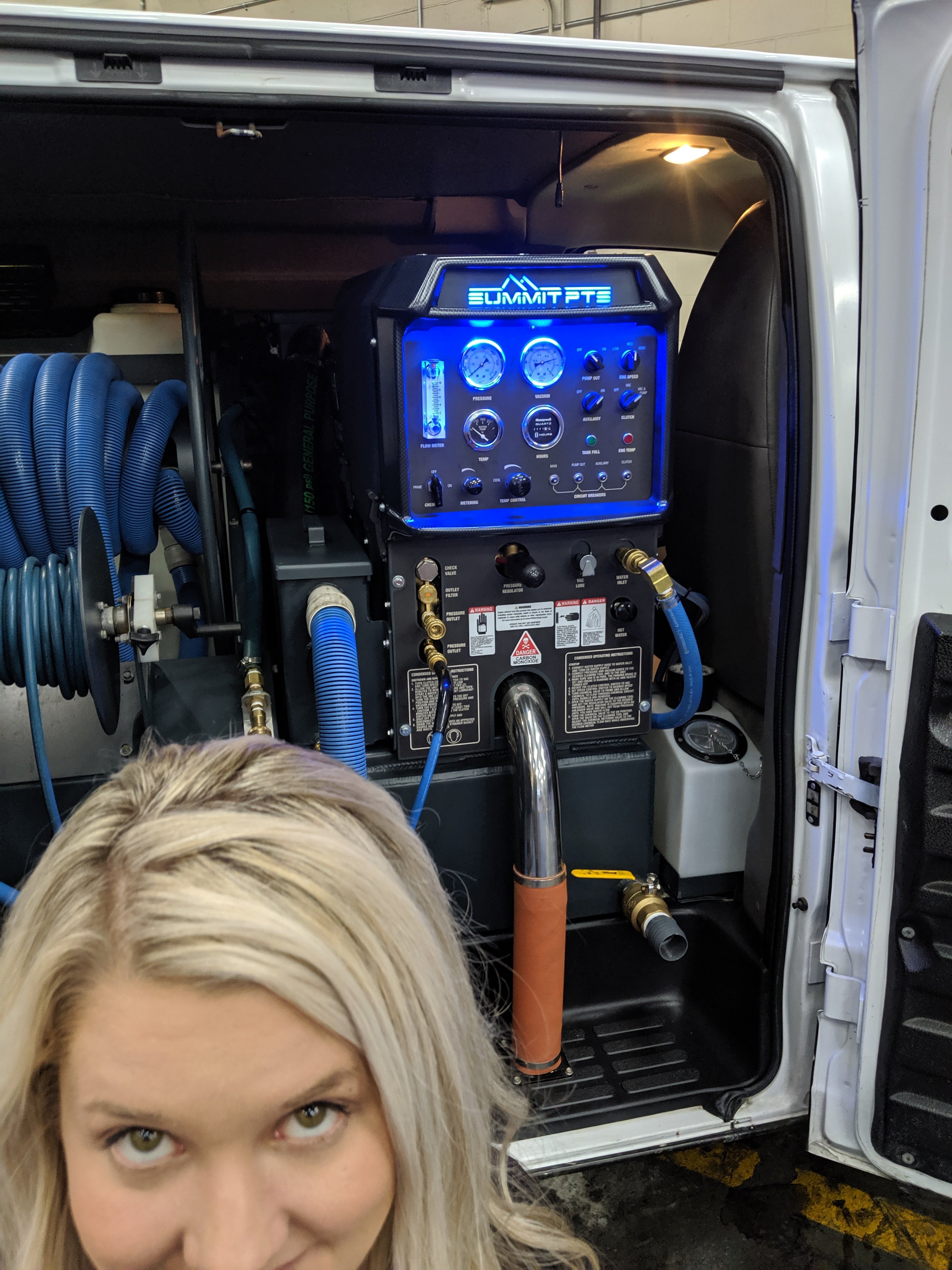

Sapphire Pro 1200 becomes the Summit PTS

That’s it; that’s the way to do it. Change the name and hope they’ll come back to it!
You all have me nervous now. I am getting this installed now on a 2018 Chevy. The company that sold me on it talked about the ease of operation and the limited maintenance. He also was going to charge me $7000 more than another company for the install. Should I be worried about this unit? Brand new to truck mounted units and limited use on a portable carpet cleaner for my cleaning business. Should the hood be up or down when operating?

If he's charging you $7000 more than another reputable distributor, that's your first red flag. How does he justify that? Is he giving you extras that the other guy didn't? Hood down always. I have no experience with that unit but typically pto units are easier to operate and maintain than slide ins. .

Their "fix" for the heat issues is a direct driven flex fan, no clutch. I'm installing the first one tomorrow but I worry it will be loud as took with the fan running at the same speed as the engine...

I have it on good authority that very little was changed except the cooling fan added to the van, and the cerakote on the exhaust. They can keep em

The PTS IS the pro1200se, Finkle is Einhorn... They updated the look and made a couple small tweaks and that was it. The hood up in the promo video is the most damning evidence
