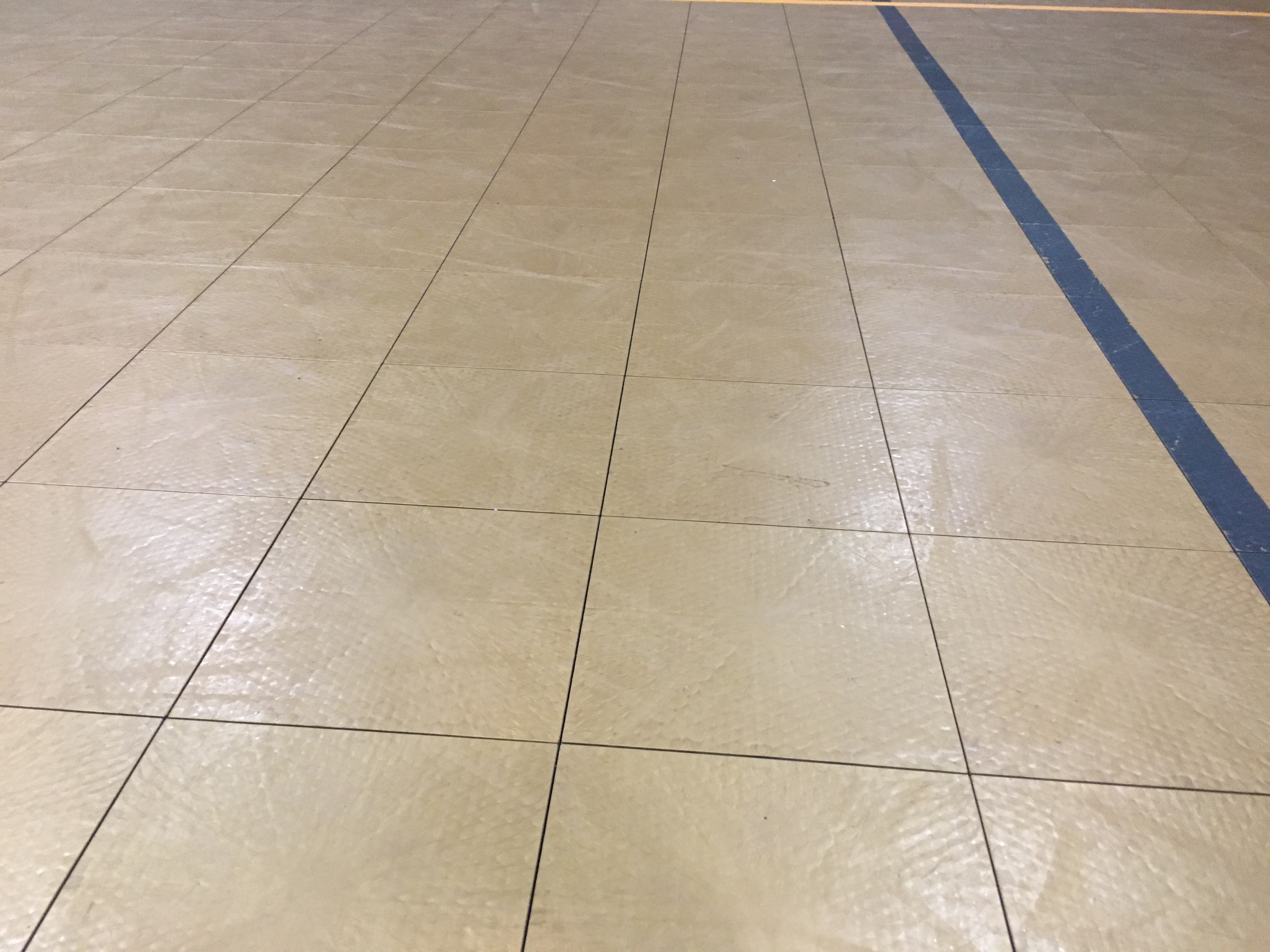

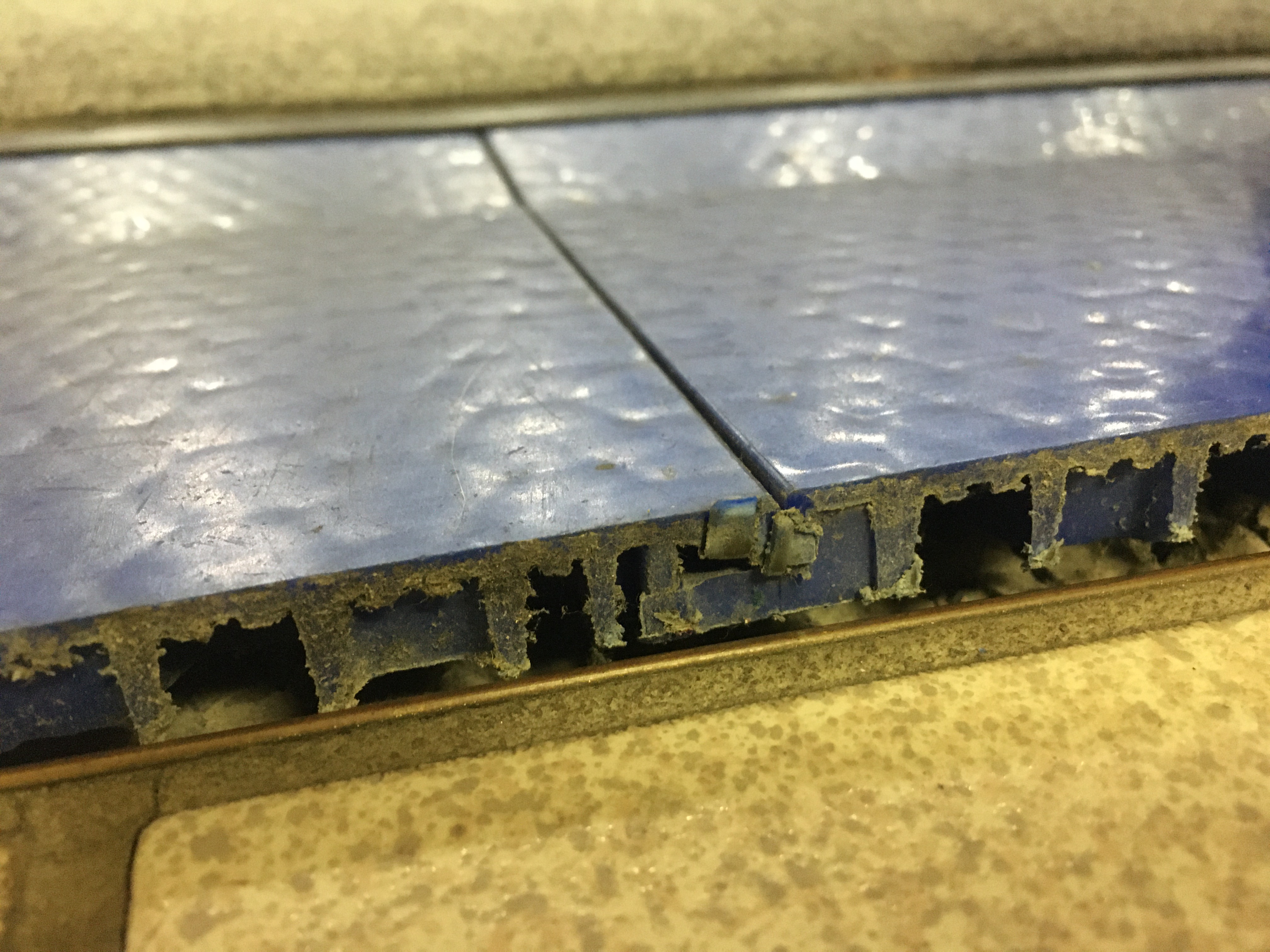

I wasn't sure if any of you guys ran into this kind of gym floor before
10,259
175 with a tank if you have that. If not, sling it around like stripping vct. The 175 would be the ticket. Damon’s right, start light such as red pad. Might do it, if if not move to blue or green.
10,259
If you’re gonna keep getting these, you might need to invest in a used auto-scrubber. A 20” Nobels or Tenant can be had for 15-2k. Throw it in your trailer.🤷🏼‍♂️
