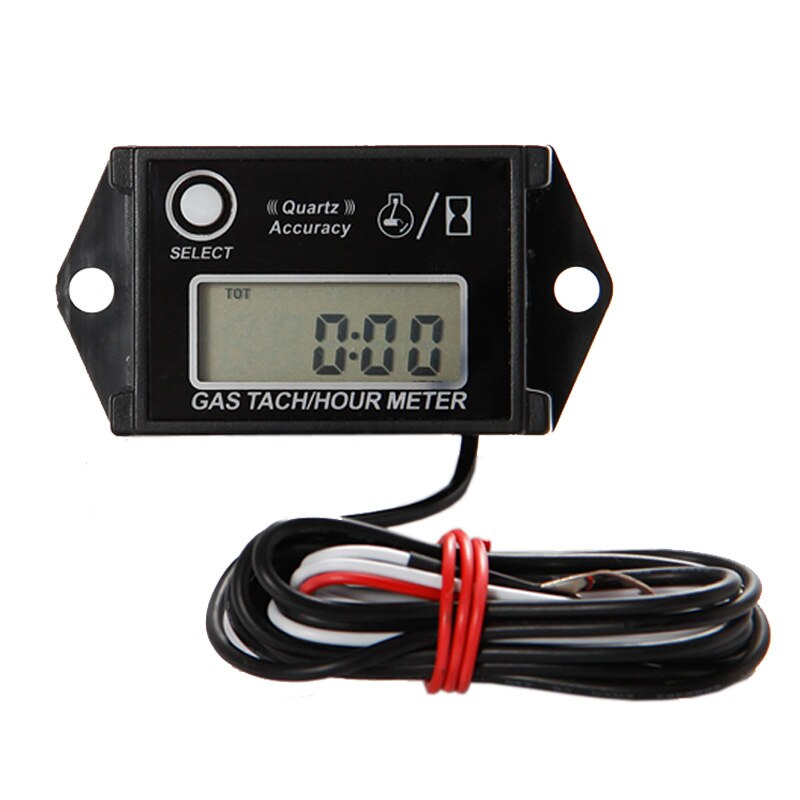

No TinyTac/hour meter on the Boxer??
cheap (relatively) and easy to install
at any rate, you should be running any air cooled motor near max RPM to provide best cooling
'bout 3100-3200rpm would be the sweet spot on your motor
