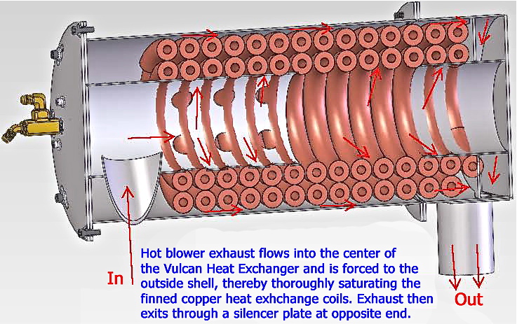

A Vulcan HX is not the same as a Prochem blower HX on a 405. The 405 blower HX are basically 2 heater cores preheating the water box with returning low pressure flow from the regulator. The Vulcan is more like a traditional engine exhaust heat exchanger. It uses the blower exhaust, but same principle. I believe they use a finned stainless coil. If it didn't leak I would guess it's something you could salvage. Keep in mind that if the Vulcan HX doesn't have a blown line. (A leak) it would only stop working if it were clogged. It might need descaled but probably I would assume trash has built up and clogged the fins. That can't be good for your vacuum performance either.

David, this is a diagram I found of the Sapphire Vulcan HX - is yours like this?
