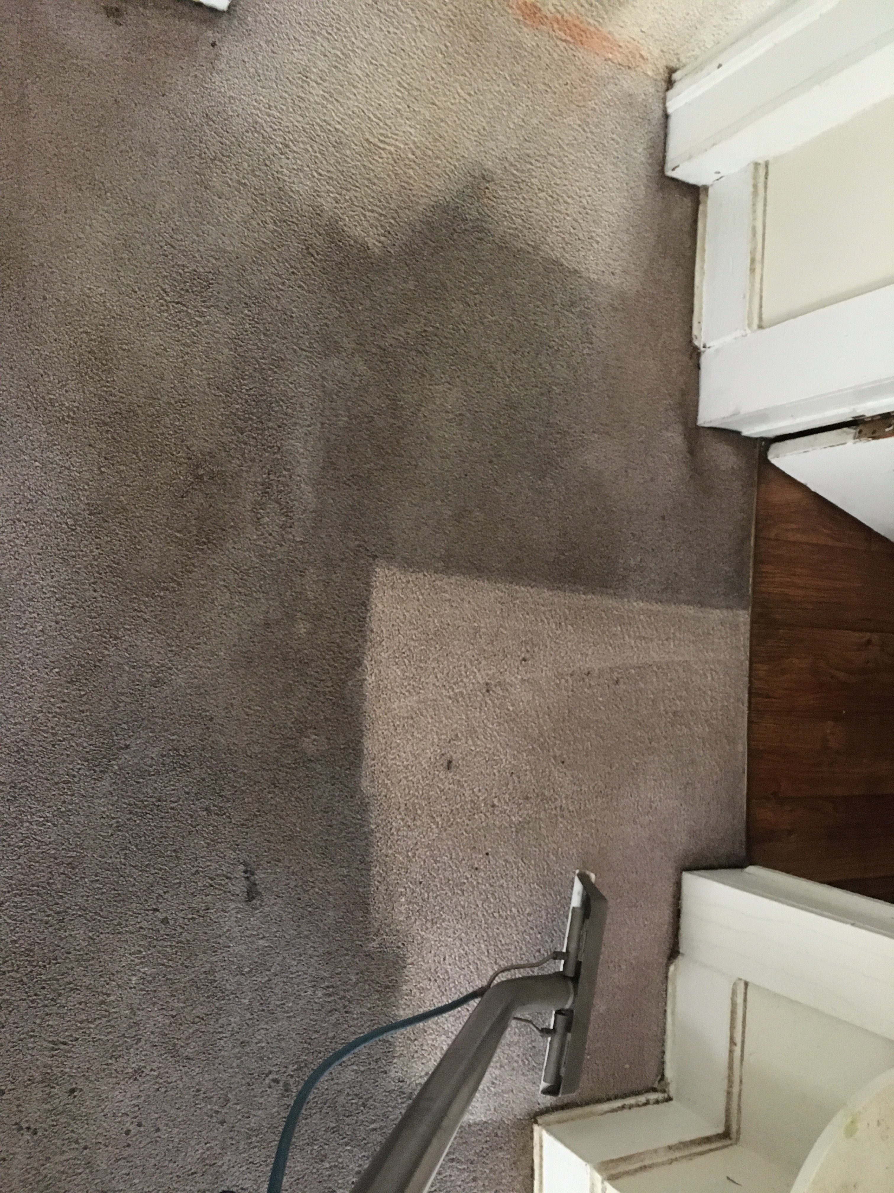

Here’s a job I used some purple on a couple years ago. Don’t worry about it
