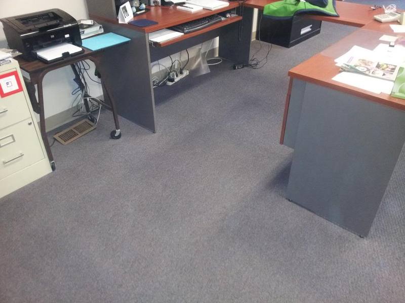

the pic's below are from a REALLY small job, i think it is our smallest commercial office (one of our insurance agent's satellite offices in a very small town.) probably about a 16'x17' room basically, with 3 mats. last time we cleaned it was 2 years ago. every time we clean it, it gradually looks a little better than the previous year...typical of my experience with encap on CGD. the 20" Trio cleaned it slightly faster than the Cimex it seemed, last night's larger job was a better judge.
hard to say on this small job if it gave a better appearance of clean than in past cleanings. overall i was happy with the outcome. it used i'm guessing half the encap juice that the Cimex would. and it dried in about 20 minutes, i was quite surprised. i was happy with the area of carpet that transitions to the chair mat...you know that area where the chair wheels roll off of it all the time and the carpet gets really worn (permanent damage) because the chair mat is too small? i'd say it cleaned that area up about as good as the Cimex. but i'll need a full day of using and cleaning 100+ cubes/offices and i'll get a better idea on that front.

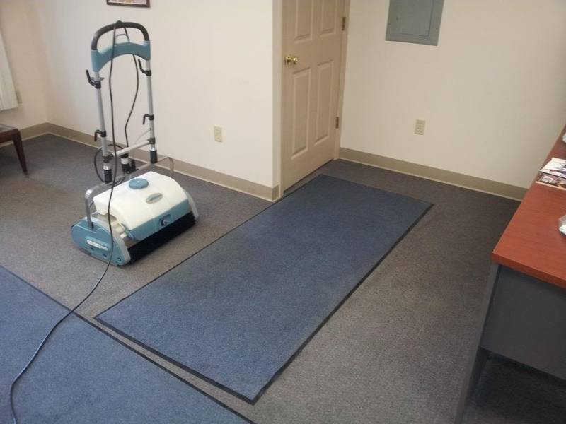

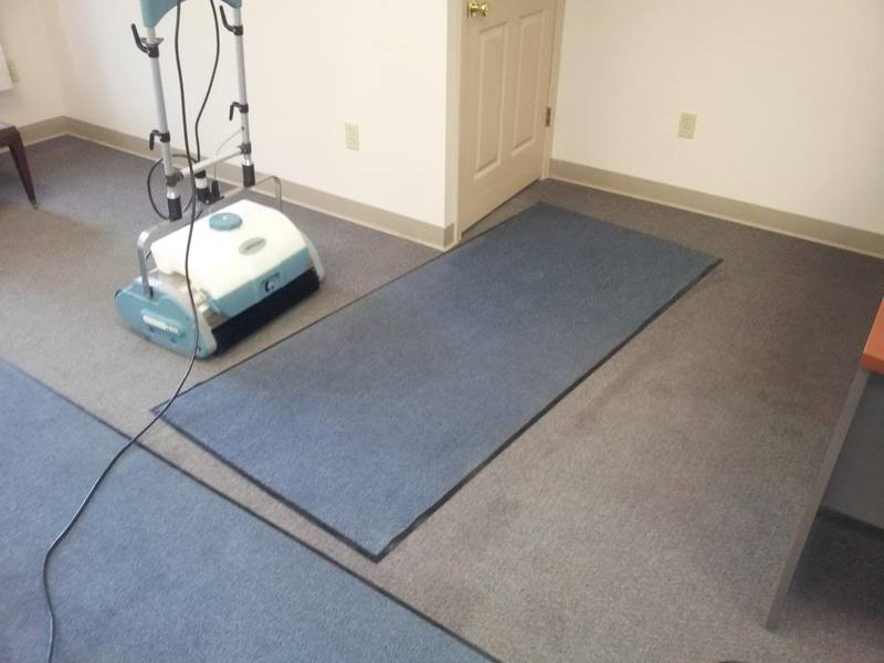

here are some pic's.

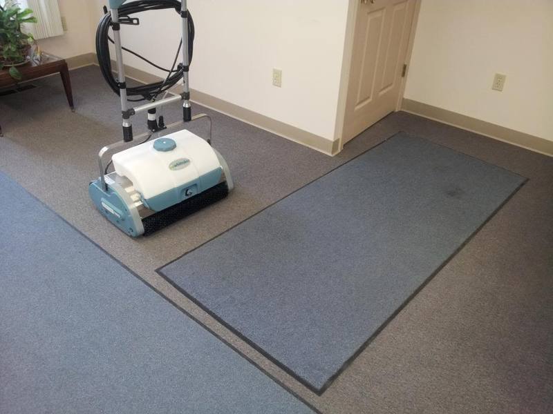

before pic of a mat with a spot:
after pic of clean mats and spot mostly gone:
i wasn't happy with seeing some of the spot still. i thought it was something my Cimex could clean up with ease, so i fired up the Cimex. well i'll be, the Cimex didn't do any better of a job at removing that spot:

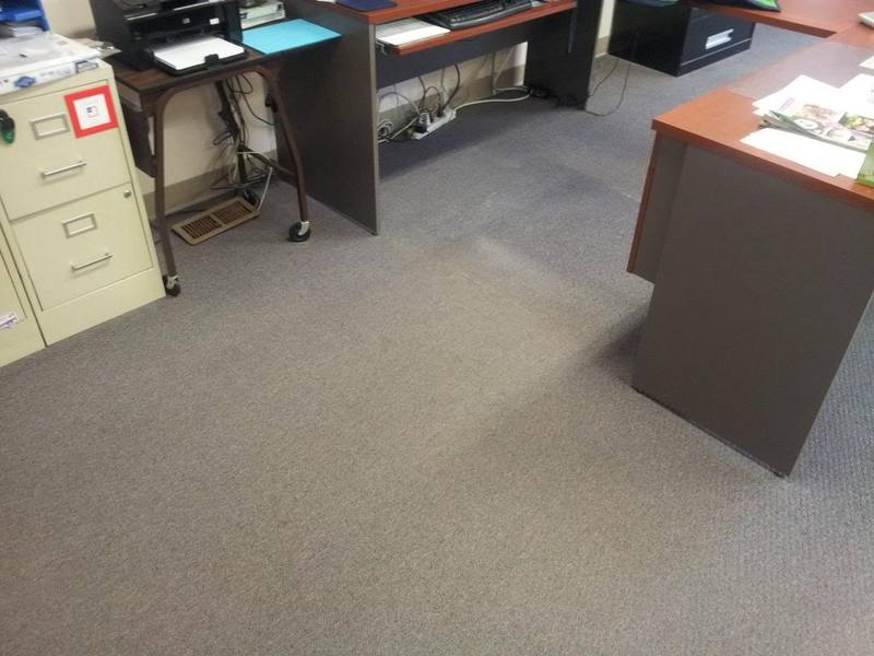

chair mat transition area before:
chair mat transition area after, it looked great:

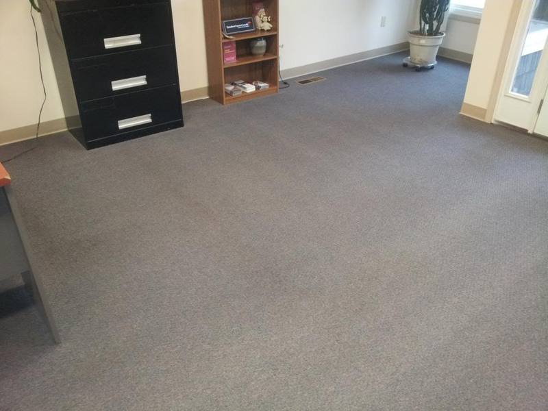

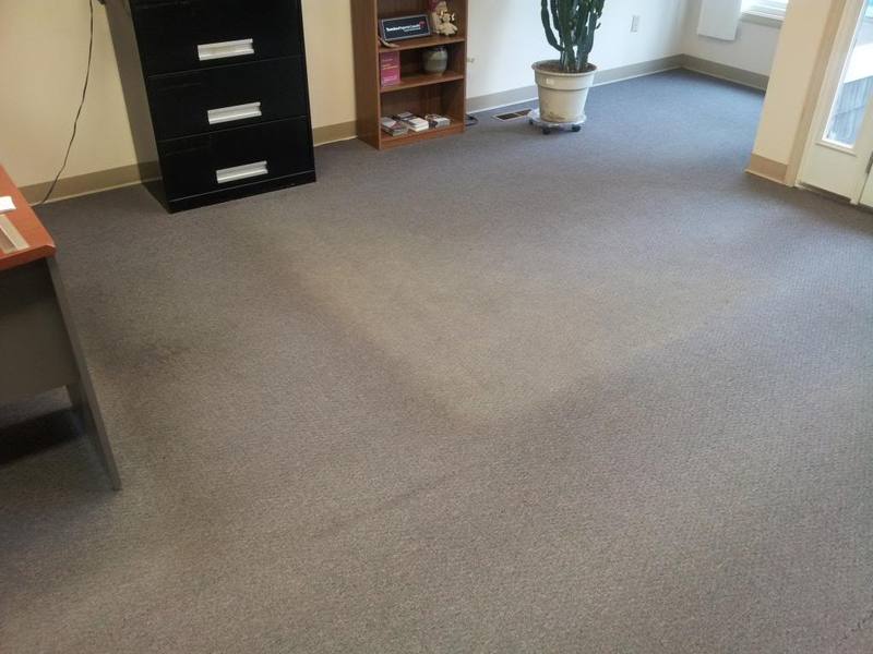

"waiting area" before:
"waiting area" after:

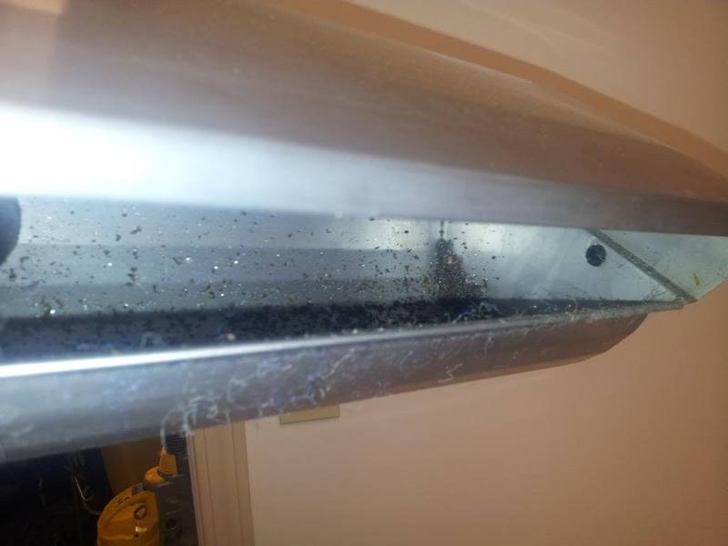

renovator tray after i finished (i thought it woulda had more in it, i guess my Dyson does a decent job of pre-vac'ing after all):

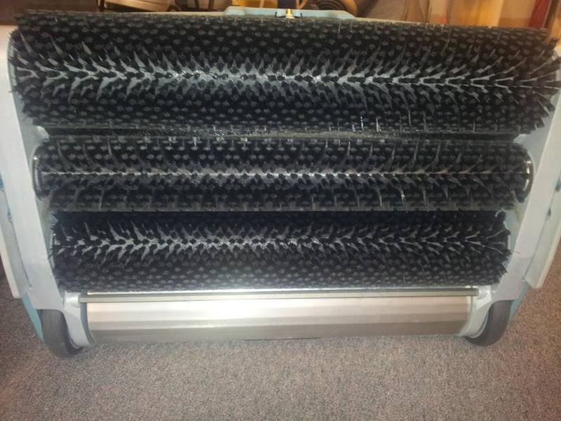

the 3 brush rolls after i finished. still as clean as new:
when i was done i was pretty excited. i called my contact there on Thursday and she was very pleased and thought it looked as good or better than in the past.
