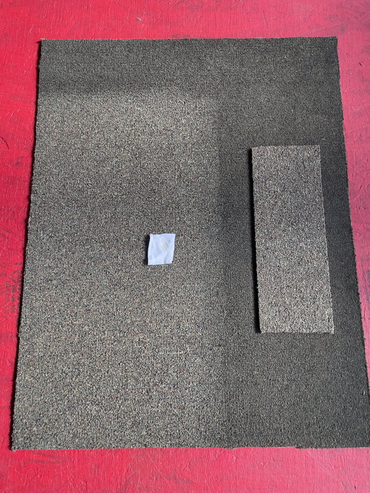

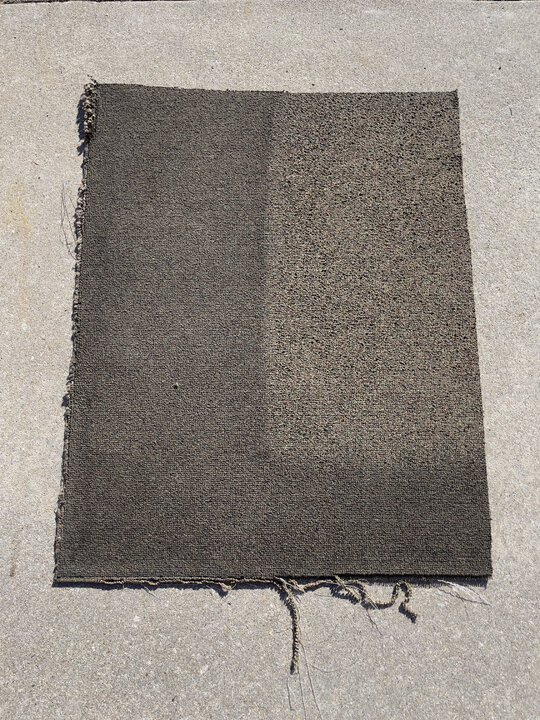

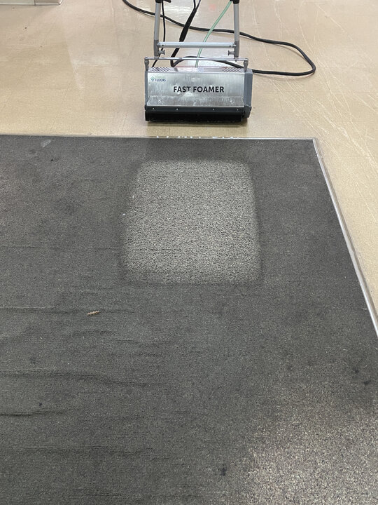

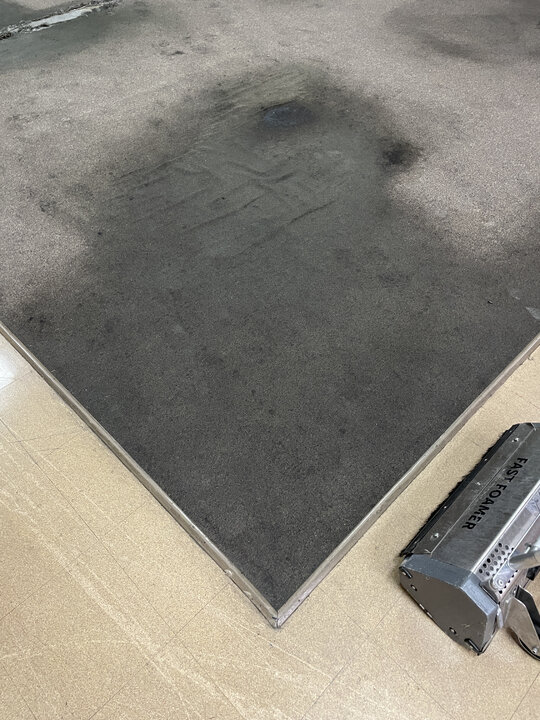

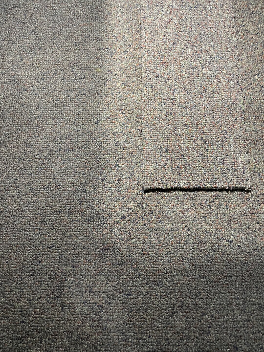

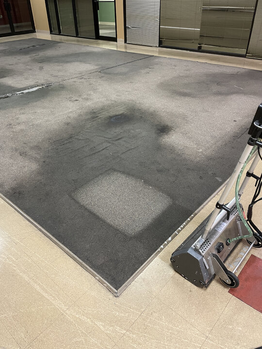

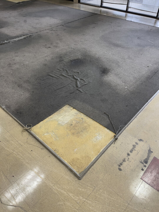

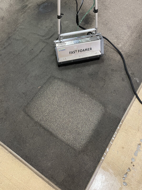

Please don't! This is not going to end well for you. Let's break this down. You have no experience with the Fast Foamer and no idea how it works and if it would be applicable as you are obviously not qualified to be speaking on this. I'm not here to destroy, but understand how I work. I will come at you with peace and willing to share all my knowledge to you or anyone who wishes to better themselves and the industry. Before I start. When I say "wrong", it's not 100% wrong because you have not been taught properly. I was taught properly and it still took me years to master it. So, I'm not attacking you. Even I can be "wrong". There is "wrong" as in appropriate, proper and adequate. "Wrong" as ineffective or inefficient.
1. Vacuuming. There is no reason to use a vacuum that aggressively on a wool carpet. Regardless of your perceived soil load. The vacuum isn't supposed to work on mechanical agitation. Yes, there is some, however it works by using two unique air flows. One created by the brush roll spinning at about 4k RPM. This RPM creates a vibration that separates the micro particulate 10 microns or less, typically about 2.5 microns which are primarily responsible for make carpet look "dirty". Couple that with a soluble aka binding agent aka the "sticky stuff". The brush roll creates a low pressure zone that pulls these micro particulate separating it from the fiber, suspending and "entraining" it into another low pressure air flow created by the vac motor. It's called "entrainment". Get use to that word because I've expanded on the science of cleaning particularly leading with physics fluids and the introduction of "mechanical entrainment" which creates an "Entrainment Trifecta" AIR (vacuuming) > MECHANICAL (CRB MACHINE, the brushes act as a QUASI-FLUID) > WATER (water rinse extraction). Vacuuming isn't "dry soil removal", it is "loose dry soil removal", Oh! I guess the cat is out of the bag, I've revised the principles, well not revised, expanded really and created the "principles of soil removal" for commercial textile floor coverings.
2. Regarding Cimex. This is where you done ****** up! I'm not even going to speak on this as it is insanity. These methods are prohibited by the manufacturer's. So, one question. Why would you want any additional liability? And I'll leave it there.
When it comes to wool, the only approved "mechanical agitaiton & mechanical extraction" is the CRB machine. Get use to "mechanical entrainment" aka "mechanical extraction". The CRB machine performs dual function (simultaneously) as a mechanical entrainment system. Agitaiton, this is chemical distribution and soil disruption. Second, mechanical extraction of "heavy, coarse" dry soils that are "entangled, trapped and embedded" within the "effective pile". Oh, vacuuming covers all dry soils on the wear surface, however it's primarily for "fine, lightweight" dry soils which accounts for approx. 40-50%. Understand, I'm giving you what most have never seen yet. Shit on it and it's on you not me, LOL! But if you don't learn from this, someone will, even me! I'm not coming at you, I'm coming after the foundation that got you to this point.
The brush denier is designated by the color white/ clear typically, softest .17mm bristle thickness. Yes, wool will shed "some" or a "lot" if you compare it a BCF.
I'm bored and hope I've shared enough for not only you to get right, but others as well. I'm raising the bar! WE can do better. I want the best for anyone in this business. I feel pain like no other and the reckoning is here! I can make you the best cleaner or the worst. It's up to you with what I've provided you. Again, I'm not attacking you or trying to be little you. This me, however my promise is to continue to work on my communication skills. So, please be patient.
See the attached photos and tell me and everyone how the "Fast foamer would not work in this application".
Mikey P said a lot of you guys are friends and go back and forth and this is just a tight community, so don't be offended. LOL! Sounds like my kind of sandbox!😈
If you want to measure dicks, LOL. One example: We can clean a 5 story bldg over 70K sqft plus upholstery yada yada three Fast Foamers over a weekend (Sat & Sun) with time to spare. This system truly cleans. Rotary is dead kid and I'll keep kicking it. They knew rotary was bad in the 80's. Let that sink in. Why do they want you using it? Start asking questions. Wakey, Wakey sleepy head. Rotary is NOT an ENTRAINMENT SYSTEM! "They" have either intentionally suppressed the CRB technology "mechanical entrainment" or just didn't recognize it, either way. There is no going back to sleep! My work is copyrighted and will be out soon! Didn't you know... There is a MANDATE!🤣🤣🤣
I GOT SO MUCH CONTENT! THIS INDUSTRY IS GOING TO SEE A MAJOR SHIFT! RELAX AND BREATH IT IN. WE GOT THIS! Disclaimer: WRE and TM's aren't going anywhere. I've broken it all down, but rotary is the past!
View attachment 130404 View attachment 130405 View attachment 130407 View attachment 130408 View attachment 130409 View attachment 130410 View attachment 130411 View attachment 130412 View attachment 130413
