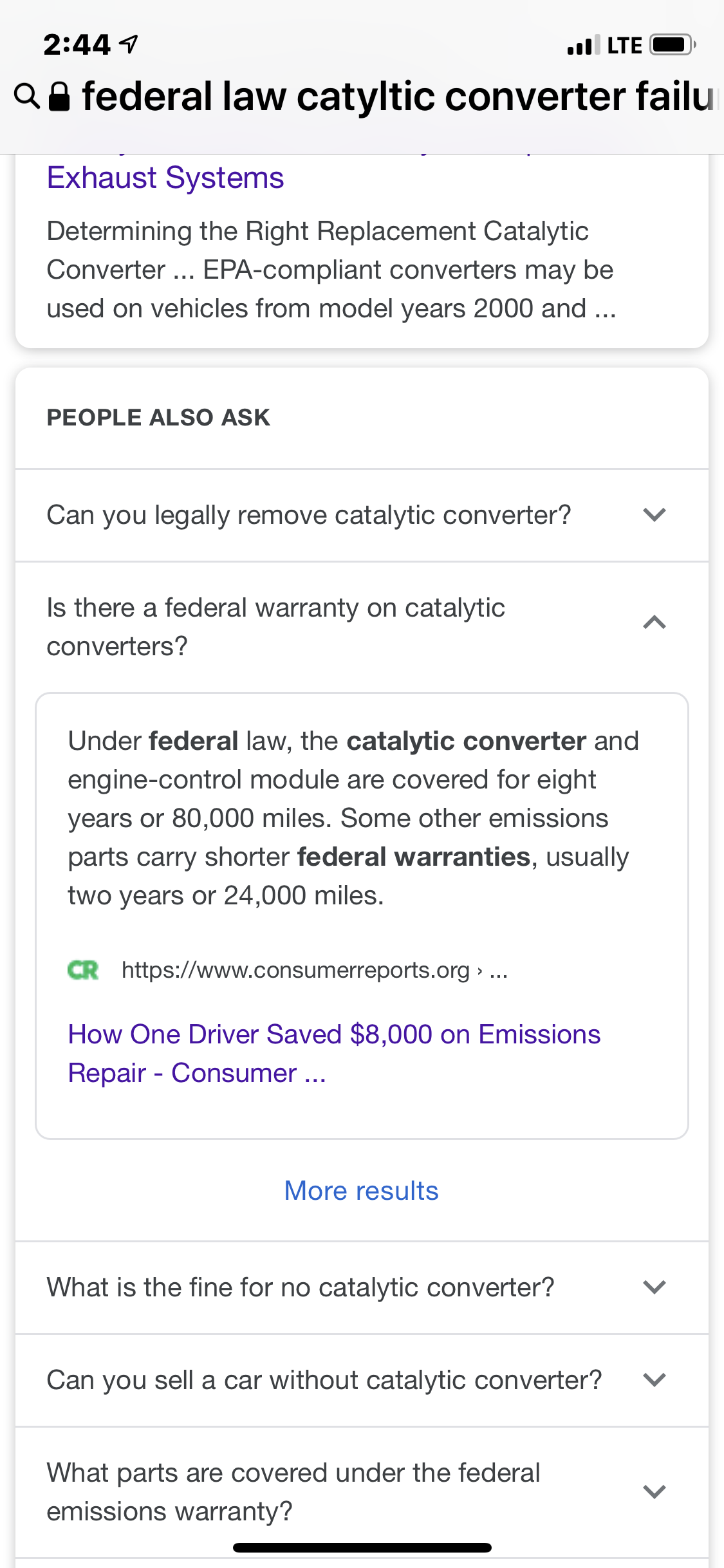

11,530
Lastly there’s still a good possibility I’ll have problems with the catalytic converter pray it ain’t so!
11,530
Man Sam. This is turning into a soap opera.
Well the cat hasn’t failed, and it ran great yesterday, but it takes time for the computer flag a bad cat.
It’s a watch and see moment right now.

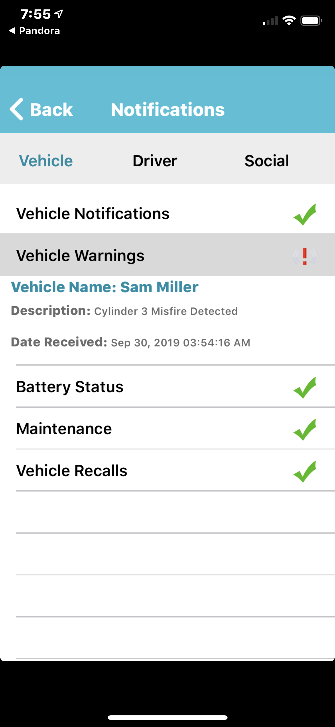

11,530
Originally it was cylinder #5 misfire now it’s #3 misfire
That’s the code my Vyncs gps device came up with
