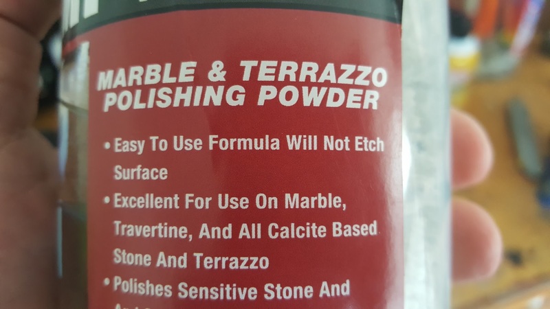

FYI emp is definitely not non-acidic. It contains oxalic acid, like just about every other polishing powder. Most polishing powders will work this way, fold a microfiber or teri towel into a couple of layers around your finger, moisten it, dip in the powder and rub aggressively into the surface like a paste.
actual non acidic compounds take a very long time to polish or require a tremendous amount of pressure/friction to polish. Like using pure tin oxide on granite, it's a much more physically involved process than something like MB-20
Feb 5, 2013
527
cameron demille
Mike,
it has acid in it, and it will etch, although not as easily as other powders. It's in the way it's made. This is similar to MB-22. It is made a specific way to drastically reduce etch splatters.
There are fine powders, grainy powders and gritty powders, pastes as well. The grit or grain you feel in them is the acid. If it's a fine powder with little to no texture, the acid is powder instead of crystals, it's been pulverized. This is all oxalic acid.
The finer the grain, the hotter the powder. The larger the grain, the "less acidic" the powder is, or at least it just appears that way. This is because finer granules dissolve much faster in water, making the overall solution hot. The larger crystals take a lot longer to dissolve, making the overall solution less hot. This doesn't necessarily mean there is more or less acid. You can have something like MB-22 with large acid chunks that is a very mild powder have more physical acid content than something like our Dynamite 5X, which seems very hot, because it dissolves immediately in the water, instantly giving you an active solution.
The other factor too, is how much acid there is in the powder. You can adjust the aggressiveness of powders by the acid content, and the size of the acid crystal.
If the EMP didn't etch, it wouldn't polish like it does.
MB-22 is the original "chunk" powder. I have a picture of the raw powder here: http://www.easystonecare.com/MB-22-Marble-Terrazzo-Polishing-Compound-p/mb-22.htm
MB-22 used to be actually much more chunky than that, but it has since been made a little finer.
Feb 5, 2013
527
cameron demille
nothing like that at all. it's fine to use. it says non etching because of the way it is formulated. mb-22 and emp are similar, in that they don't etch when they splatter into surrounding areas. they might, on some very delicate stones like onyx or negro marquina, but in general they won't.
it goes back to the large crystals not diluting in the water very well. so when they get stuck under the pad they are there to polish, but when the solution splatters it's not that aggressive
all powders that Polish are acidic and will etch to a certain extent, that's part of how they work. non acidic polishing powders are Bullshit and should be thrown in the trash. except a few oxide powders, but you need to know exactly what you're doing with them and that's another conversation
if emp works for you and you like it, there's nothing wrong with using it.
