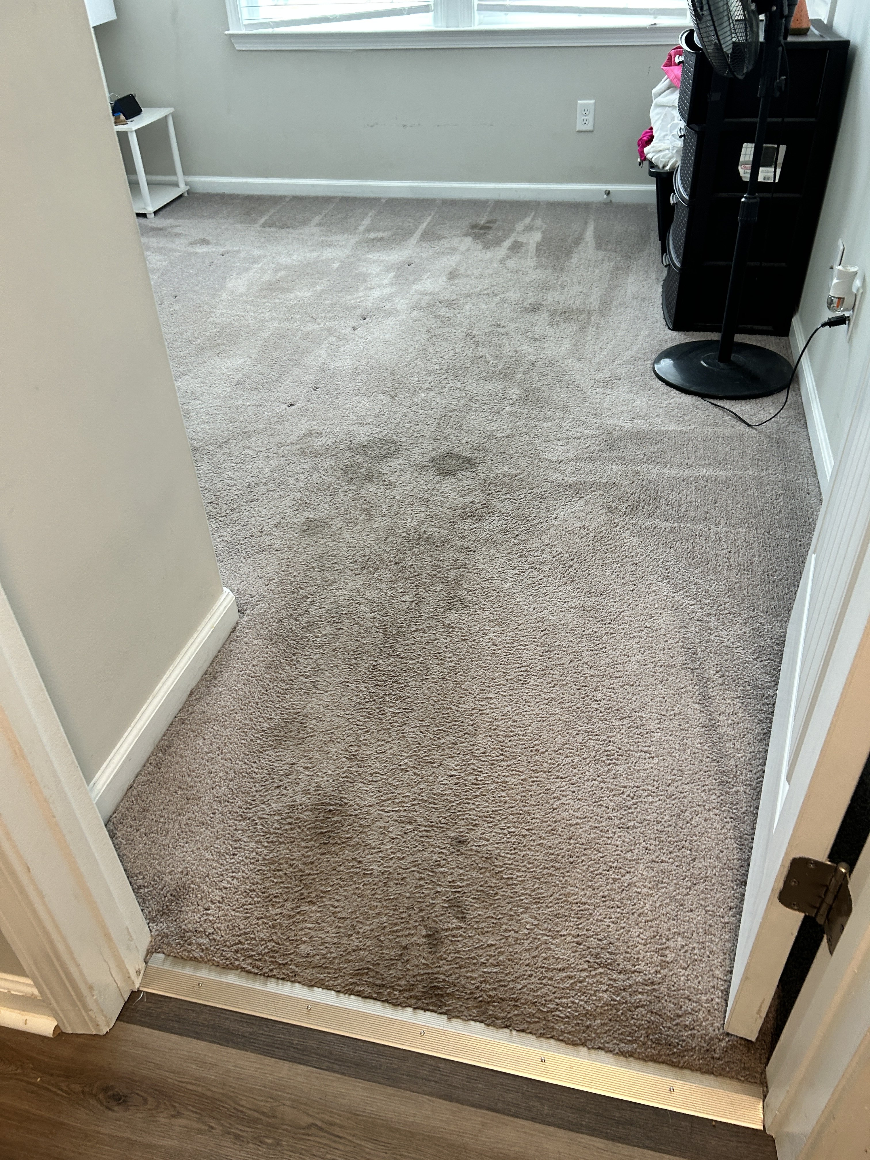

Today I had a repeat client that has an old dog. I usually clean for them at least 2 times a year. They have poly carpet, beige in color. I always give them one of my pet spotters, but they ran out in-between cleanings and opted for some hardware store pet spotter and you can definitely tell where it was used because it was resoiling like crazy.
It was my only job on the books today so I thought I would do some testing.
The first thing I did was mix up some TOPS PadCap Pro at 2 ounces to 2.5 gal. and applied to all areas, CRB, then go over with a bonnet, and the results were noticeable, but minimal.
I then mixed up some Silver Solution at 5 ounces per gallon and added 1 packet of Obliterate (Chlorine Dioxide) I was hopeful for this because I know Silver Solution has a lower PH and I think acidic is ideal for urine. I then ran a new bonnet and went over everything. I believe the Chlorine Dioxide knocked down the yellowing, but it was still noticeable.
I then grabbed my T-Rex from the van with a brush head used 300 psi and high heat and went over all the areas. This made a considerable difference.
Lastly, I grabbed a couple more bonnets and went over everything using a high volume peroxide based product and I was very pleased with the results, and the carpet was almost dry.
I left one small area untouched and tried to go over it with a pad and the products that I used in the first steps and I really didn't have much luck getting it to look like the other areas. I switched between micro, micro with stripes, cotton, and cotton with green stripes.
I know a lot of people on here will say they won't do jobs like this, but this is a repeat client. They are aware of the situation. They love their pet and are willing to deal with this until the pet passes, and will replace at that time. I'm offering them a solution, they are educated on the situation, and find value in it.
This was around 800 sq ft and I charge .75 a sq ft.
I'm not ruling out the low moisture yet though. I do however think that HWE combined with post bonneting with a peroxide based product is a good combo.

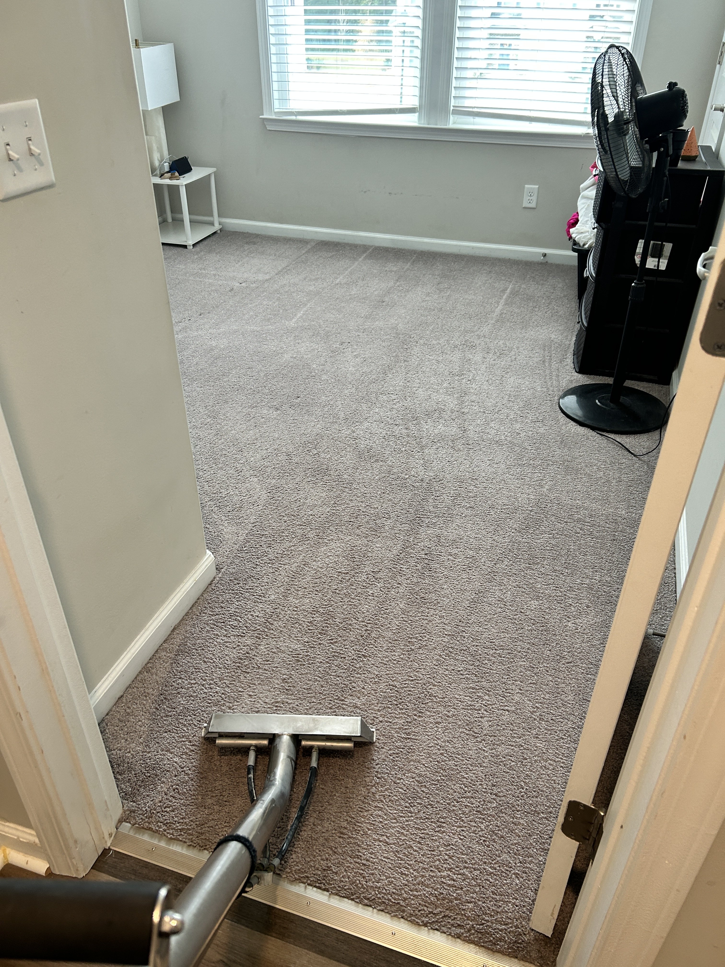

My urine removal process. I don’t have a device that measures urine so I don’t to crazy with the process.
1. Vacuum. A shark vacuum is very easy to clean. I can do it with the whip hose from my truck mount. It dries on the way to the next job.
2. Set truck mount to lowest psi and highest heat. Chemical feed on 3-4. Dry Slury HWE only. No expensive pre treatments that work only 50%of the time.
Rotovac in.
IMG_0763.jpeg3. Wand out with same truck mount setting.
1 wet/4 dry (2 complete dry strokes front to back).
This job was a 3 bedroom only townhome. Took 1 hour 12 minutes from arrival to departure. I charged $215.

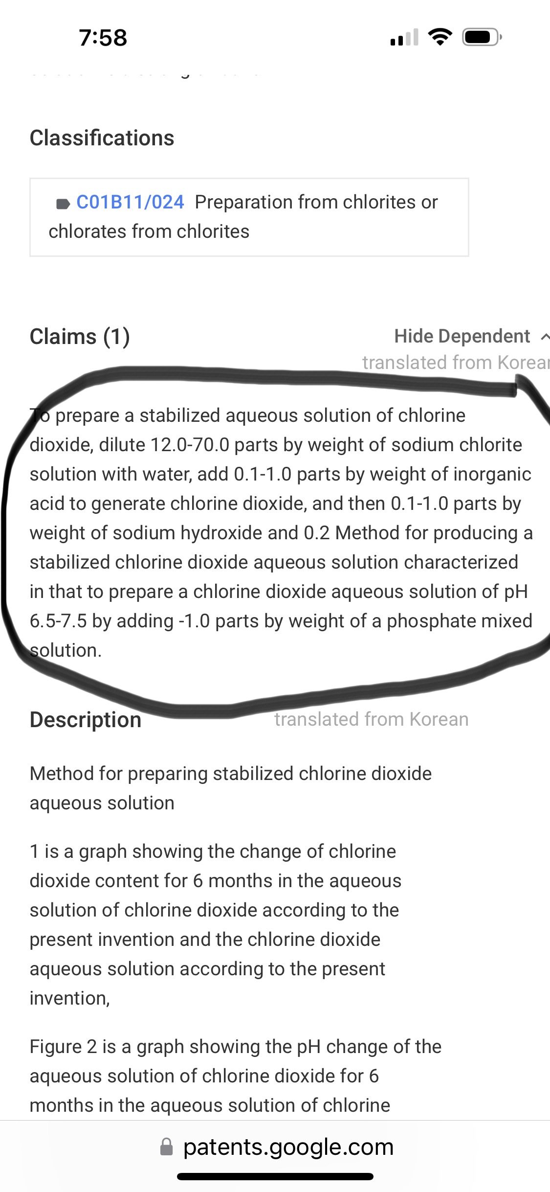

Be careful mixing sodium chlorite (CLO2 products) with peroxide. The duo can cause nasty bleaching.
Also, sodium chlorite doesn’t actually convert to a mild CLO2 until it’s acidic and it doesn’t take much.
For urine deposits, I mix sodium chlorite with PCP and add a pinch of Prochem acid rinse to barely get the solution to the acidic side.
That solution annihilates urine.
The sellers of the so-called “stabilized CLO2” products don’t mention this because they don’t want people going too crazy on the acid side. The problem is those products are absolutely not CLO2 unless acidic.
You could also mix your CLO2 product with Silver Solution since SS is just acidic enough to convert the sodium chlorite to CLO2.
