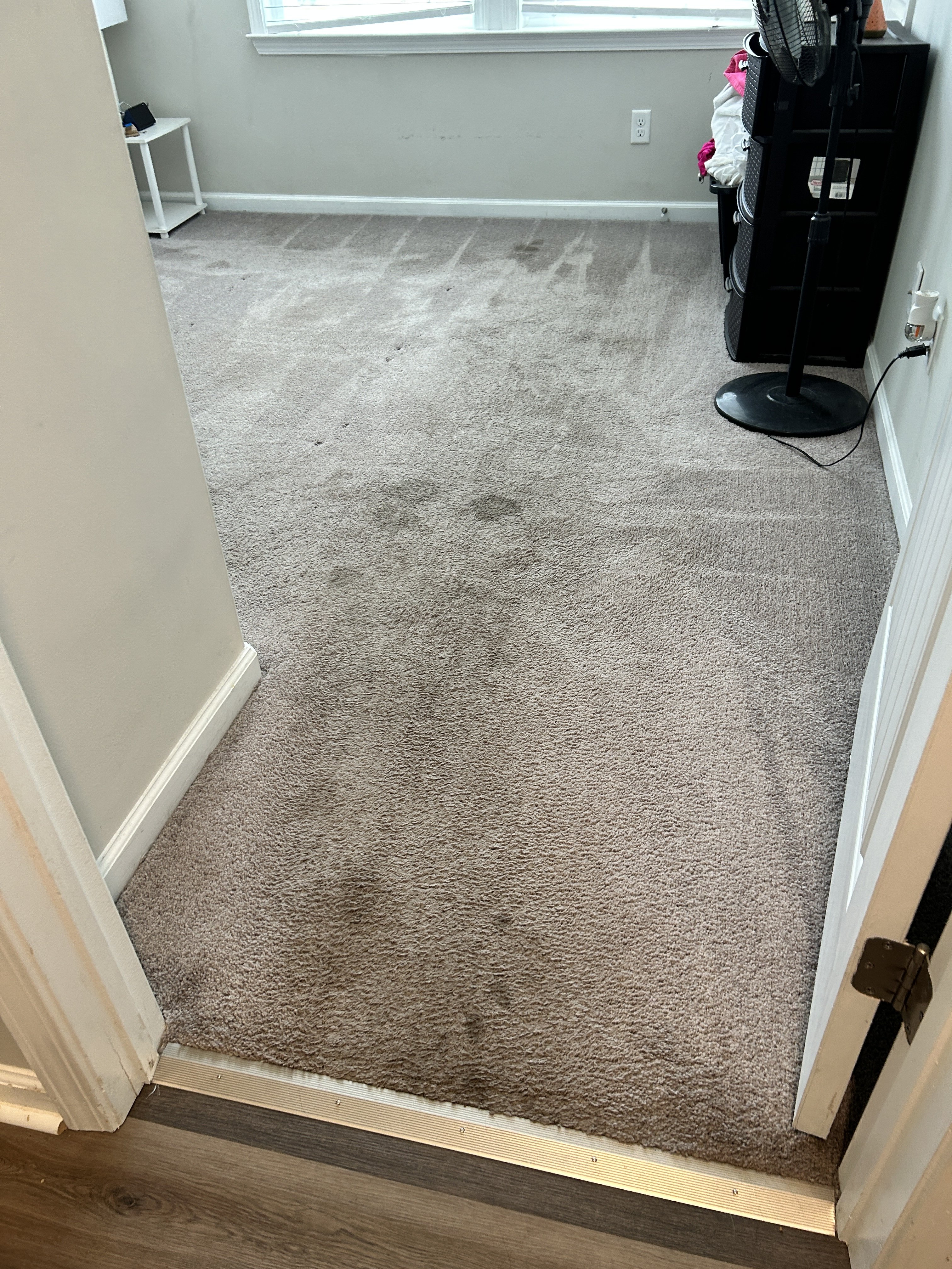

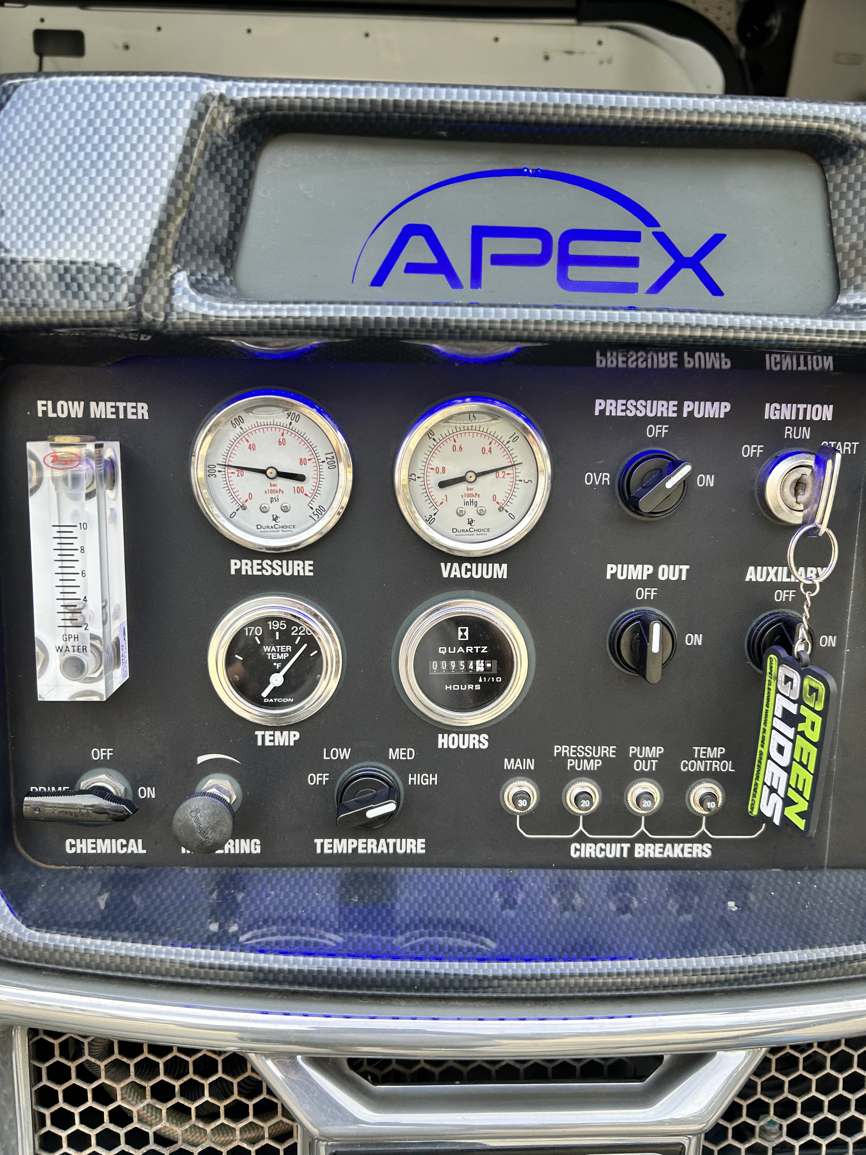

My urine removal process. I don’t have a device that measures urine so I don’t to crazy with the process.
1. Vacuum. A shark vacuum is very easy to clean. I can do it with the whip hose from my truck mount. It dries on the way to the next job.
2. Set truck mount to lowest psi and highest heat. Chemical feed on 3-4. Dry Slury HWE only. No expensive pre treatments that work only 50%of the time.

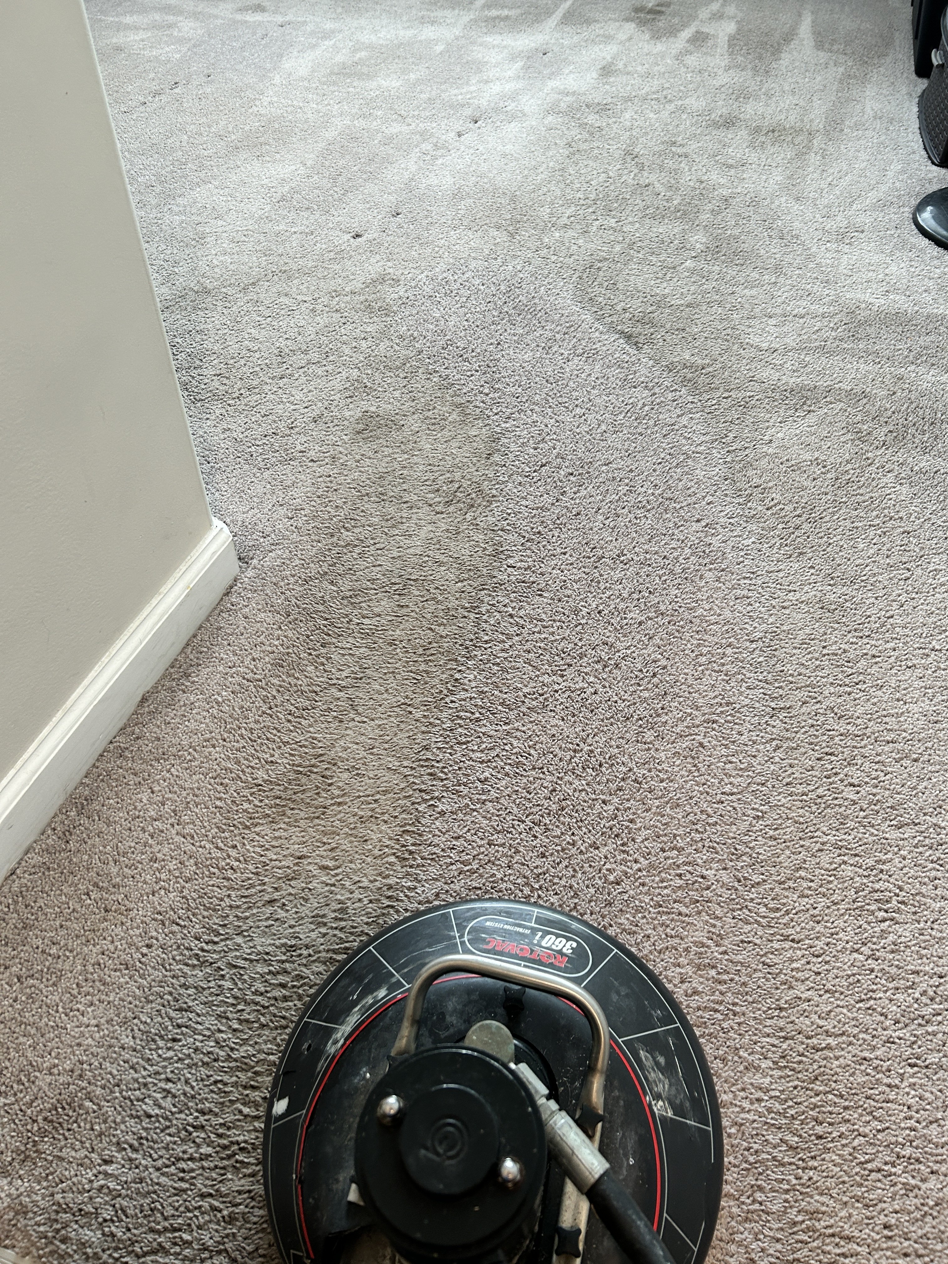

Rotovac in.

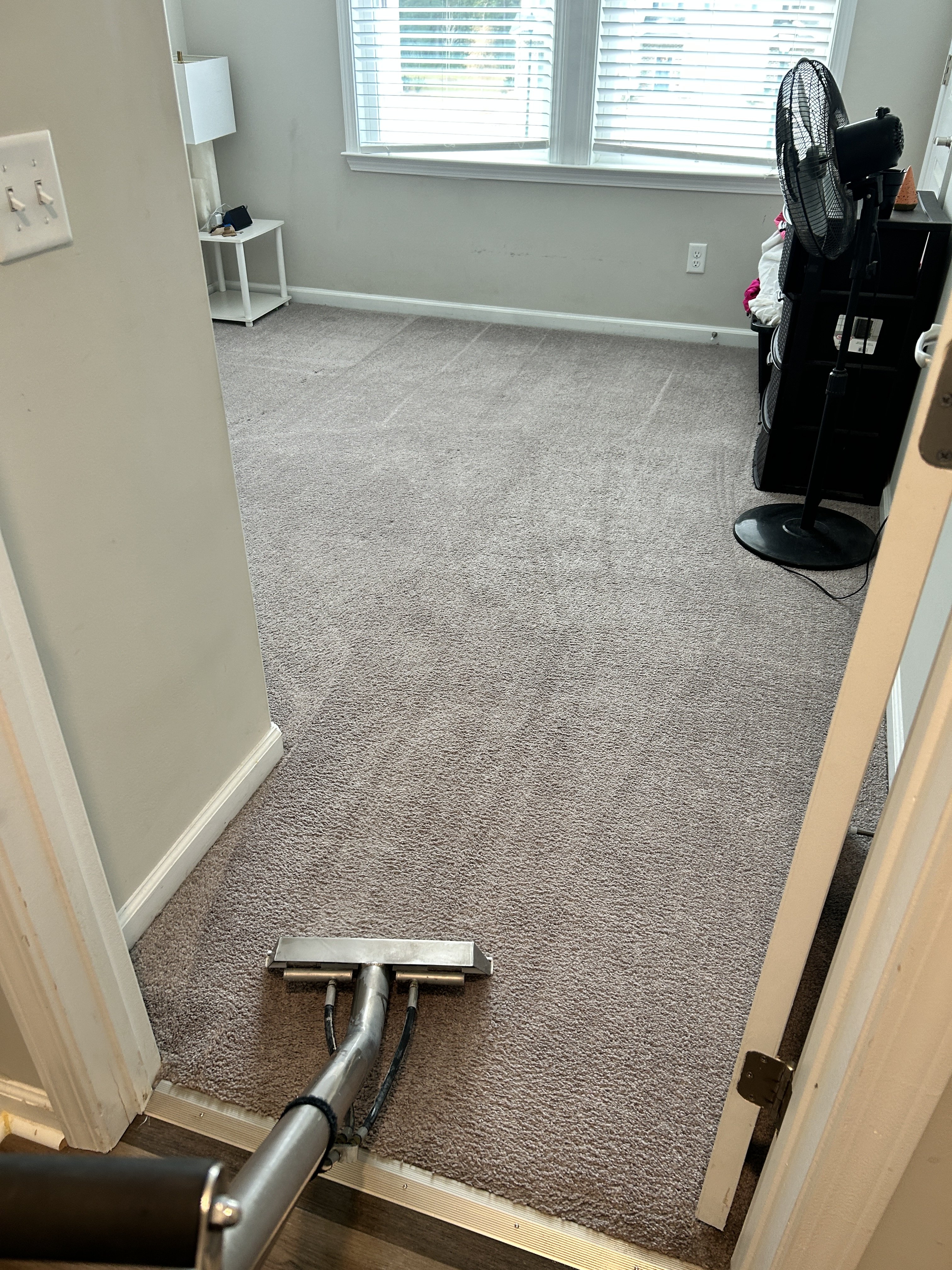

View attachment 1252883. Wand out with same truck mount setting.
1 wet/4 dry (2 complete dry strokes front to back).
This job was a 3 bedroom only townhome. Took 1 hour 12 minutes from arrival to departure. I charged $215.
When you say Rotovac in, are you only using it to brush in, or are you doing extraction with it? What made you go with Dry Slurry? I've always been under the assumption that urine needs to be treated with an acid.
