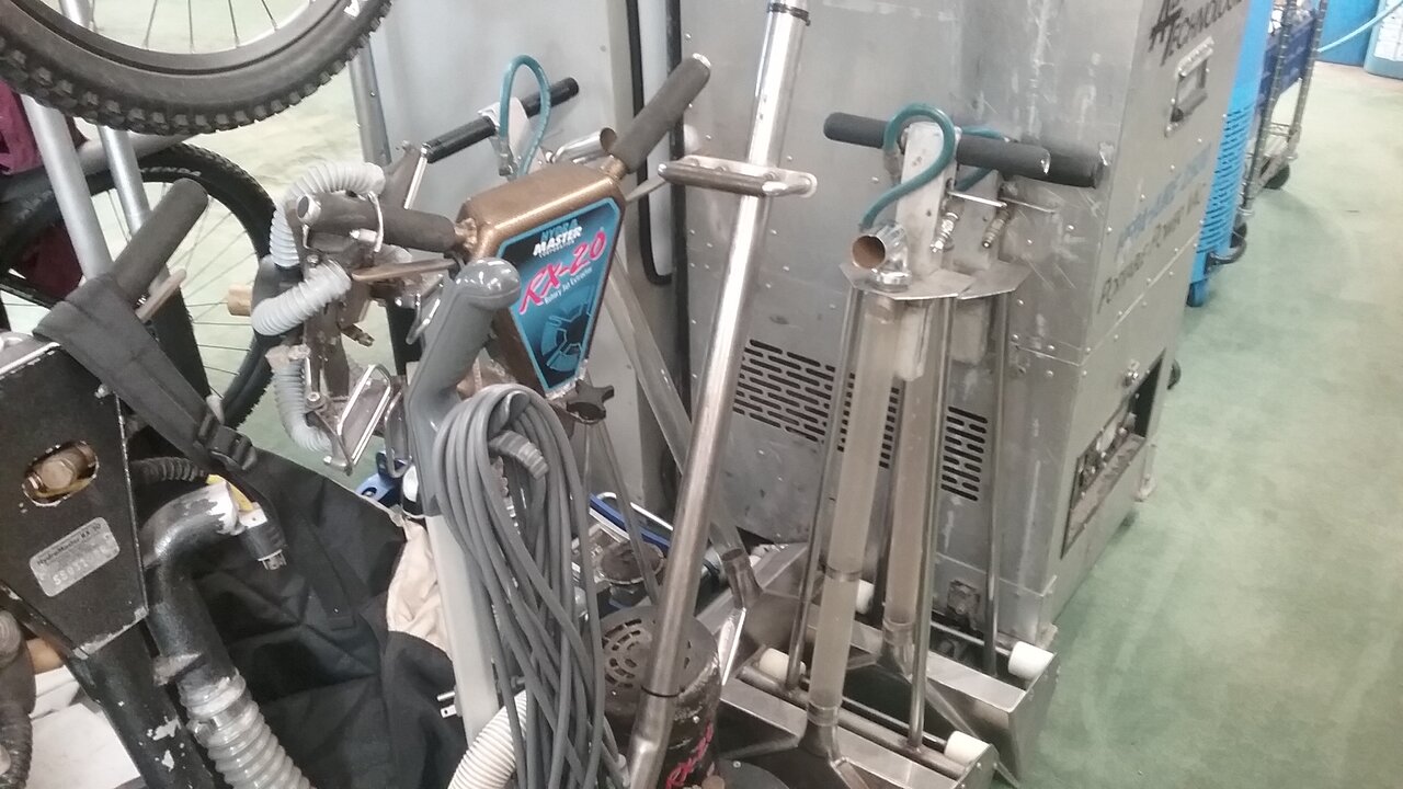

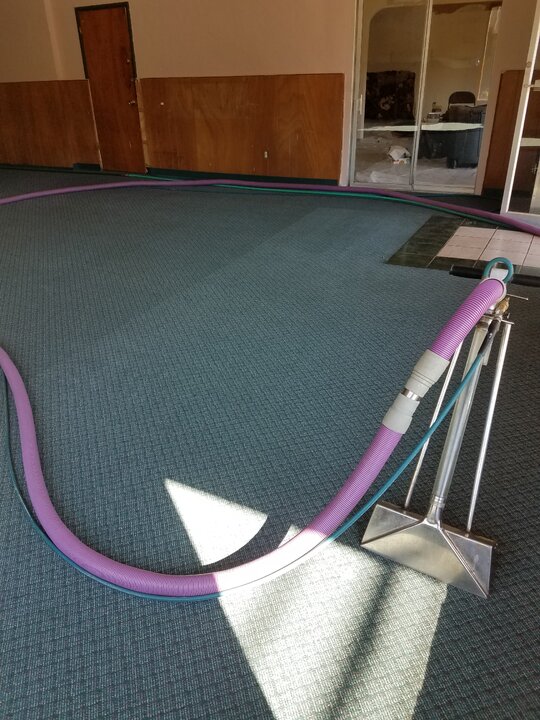

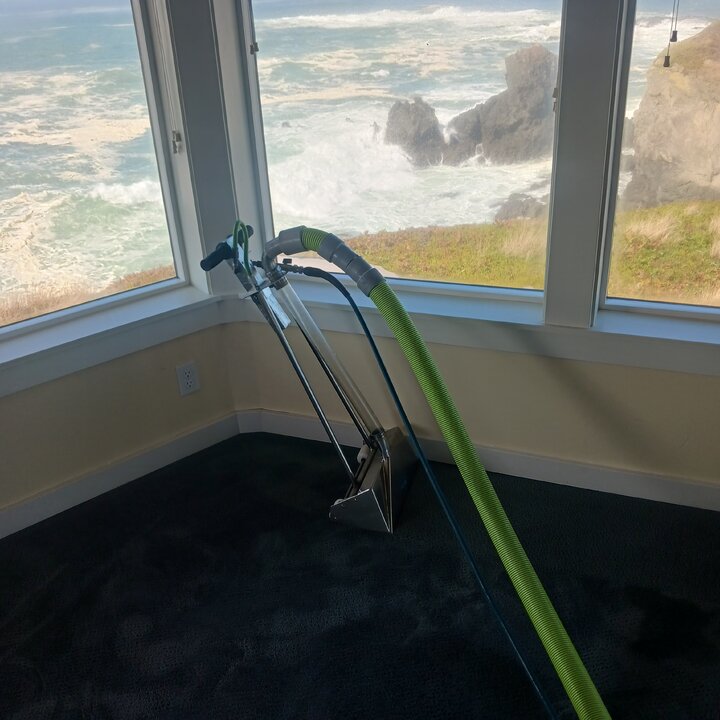

Those things look sweet Dwain-o. Are there any good modern makes of drag wands?
Not to my knowledge. Ive used drag wands since my beginning. The 16" (middle one) is the tool used on every job . Because it's way lighter, the 12" (front) is what i use one area rugs and in tiny homes,5th wheels and large rvs Because its more maneuverable. The big 24" has the same weight as the 16 but 2more jets. To tell the truth i just got it in a deal i found on Facebook and don't really have must experience with it.and theres a company in Utah that goes around the country cleaning Mormon churches and uses them exclusively. Im trying to find them and see if there intrested in buying the one i have. I first clean with a rotary then rinse and dry with a drag wand one of the nice things about themis they go right to the edges and corners (no edging) also they dry really well so well that if you were to stop and continue spraying they will pickup virtually all the water they put down . And the 2' clear tube gives you a easy clear view to monitor your progress i own several of the 16" but only one each of the 12&24
20170507_152227.jpg 20180618_172747.jpg 20180618_174242.jpg 20180327_013229.jpg 20180327_020709.jpg 20171118_084625.jpg

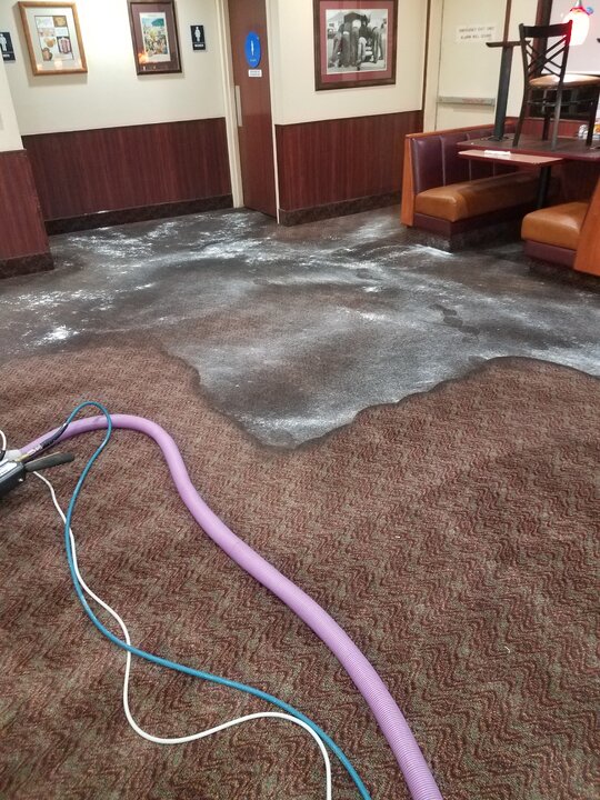

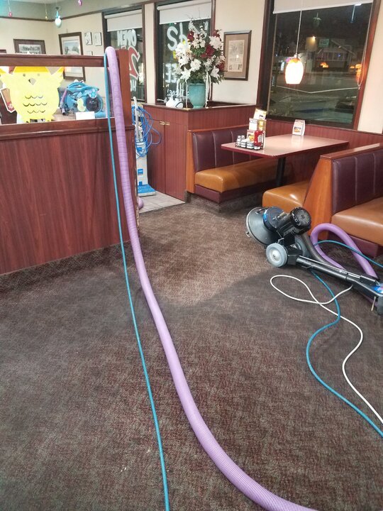

How long does it take to clean that restaurant?
That was a larger Dennys that only got cleaned when corporate got down on them. It took about4½hours with a wait for them to close one side and open the other they were open 24hrs. Its probability the worst ive done. The last person that did it left so much soap that i went thru a whole small bucket of defoamer
20180326_223026.jpg 20180327_005337.jpg 20180327_002312.jpg 20180326_230300.jpg 20180326_231731.jpg

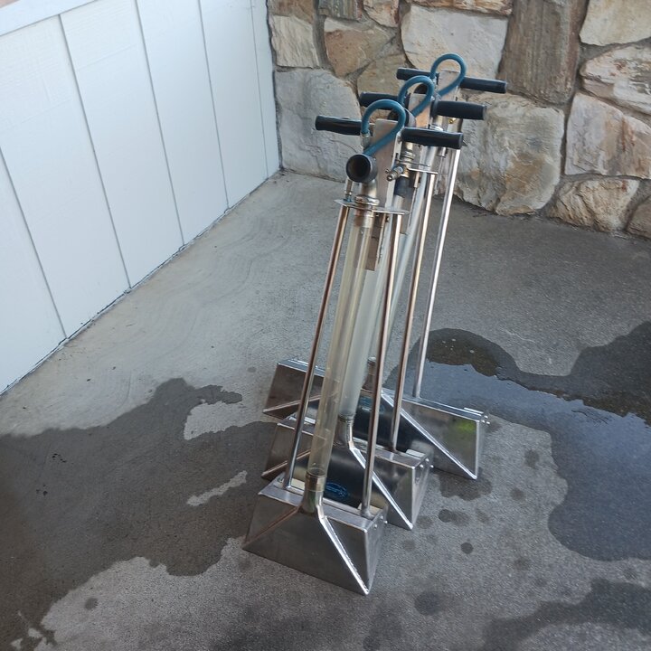

I don't just clean with the drag wand. I first lay down prespray then with my machine injecting emulsifier i throughly clean and dry the carpet with an rx20. After that i switch the machine to a acid rinse and completely redo the carpet with a drag wand. So i first clean n dry then i rinse n dry. "Two timen Dwaino cleans every carpet two times". Area rugs get only dragged because the rotary just wads um up but i drag um twice generally speaking most of the time in two different directions
20230902_110614.jpg 20230902_113914.jpg 20230926_112346.jpg 20230926_113804.jpg 20240106_122223.jpg 20240106_124323.jpg

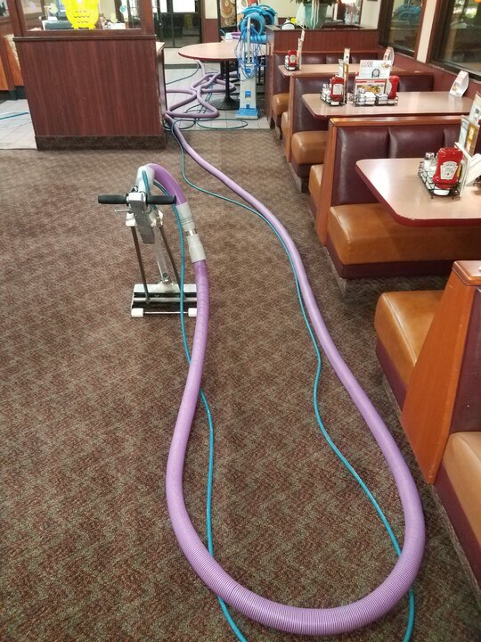

Diana and I used to do a couple of Olive Gardens. We did their kitchens. Some senior centers were worse, but they were bad especially at 11.
12,834
When I spent so much of my life traveling from New England to Wisconsin to the Carolinas showing truck mounts, most of my demonstrations were done at restaurants after closing.
It was great for my health and my pocketbook!
Why?
Once you go into the kitchen of most restaurants, you will not want eat in one again. I eat at home, take food with me when I travel, and dine out only when I absolulely have to on business trips.

Sometimes my wand locks down on cut pile carpeting, but most of the time it doesn't. Just yesterday I was cleaning a cut pile carpet and the wand was locking down and very heavy to pull. I'm not sure what to do in those situations. The carpet had much more moisture left on it after my dry passes than usual.
I'm using a hole glide on an Evo 13" wand. It has some grooves going out to the side. They are worn down a bit, would carving them out deeper help prevent lockdown? Should I have a different glide to swap out in those situations? Would turning down the rpms on my machine to lower the vacuum power help prevent lockdown? I was running it at 1400 rpms with 100 feet of vacuum hose, which is at "medium" power in my CDS 4.8, maybe I should turn down the sauce on shorter hose runs.
I'd rather not wrestle against my wand and only end up with wetter carpet after my efforts. Any tips?
View attachment 133873View attachment 133874
