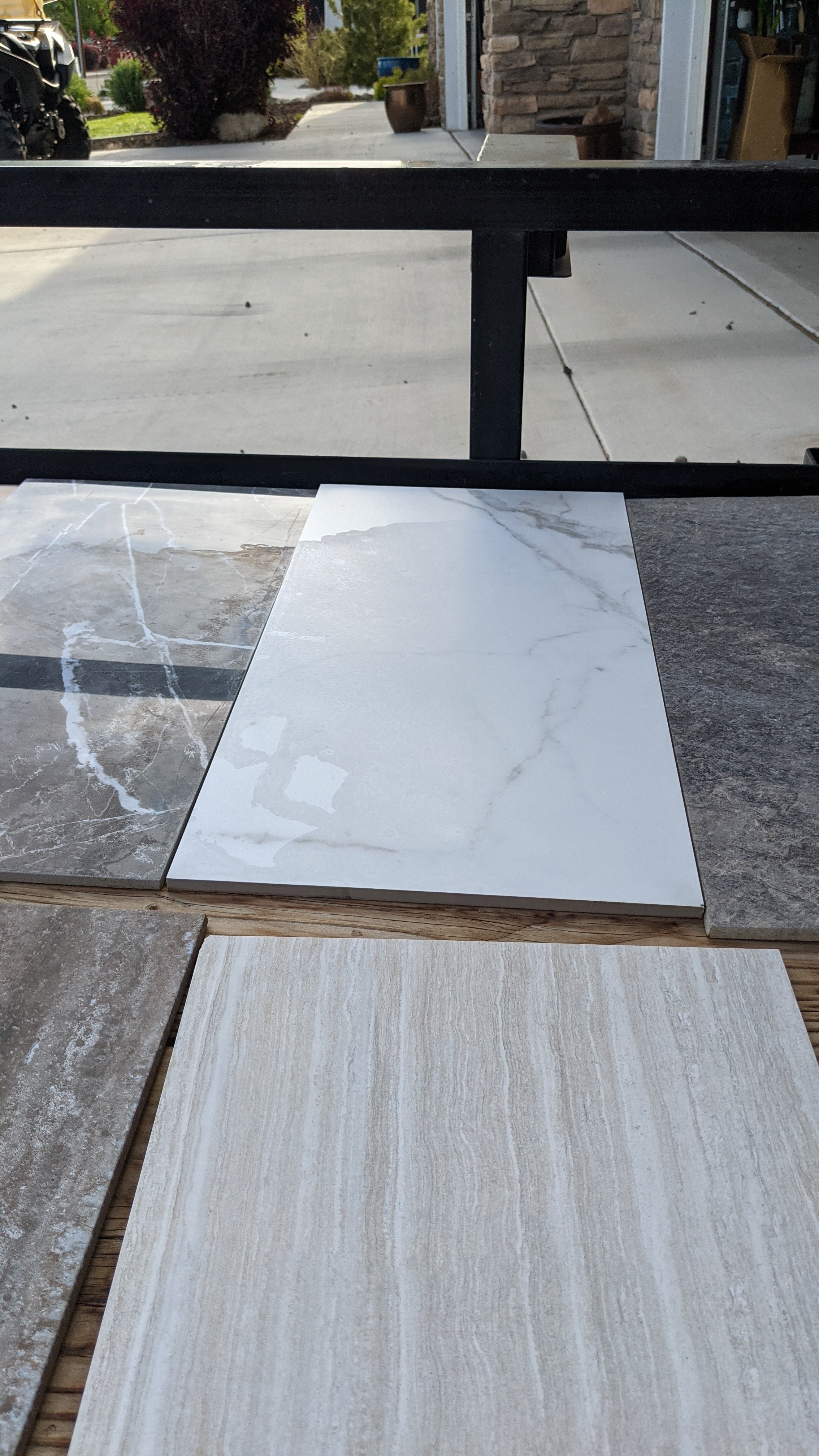

Okay I think I finally found some tiles to test some products on these were all soaked in a high pH powder overnight and then water wrench then acid rents then more water rinsed and all this remains..
Two different liquids did not cause any issues on these tiles and really didn't even need rinsing when they dried.. PXL_20210529_012415616.jpgPXL_20210529_012423479.jpgPXL_20210529_012434573.jpgPXL_20210529_012443761.jpgPXL_20210529_012459141.jpgPXL_20210529_012512995.jpg

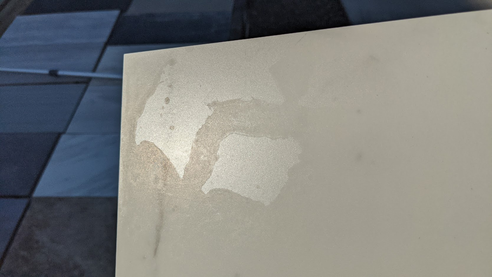

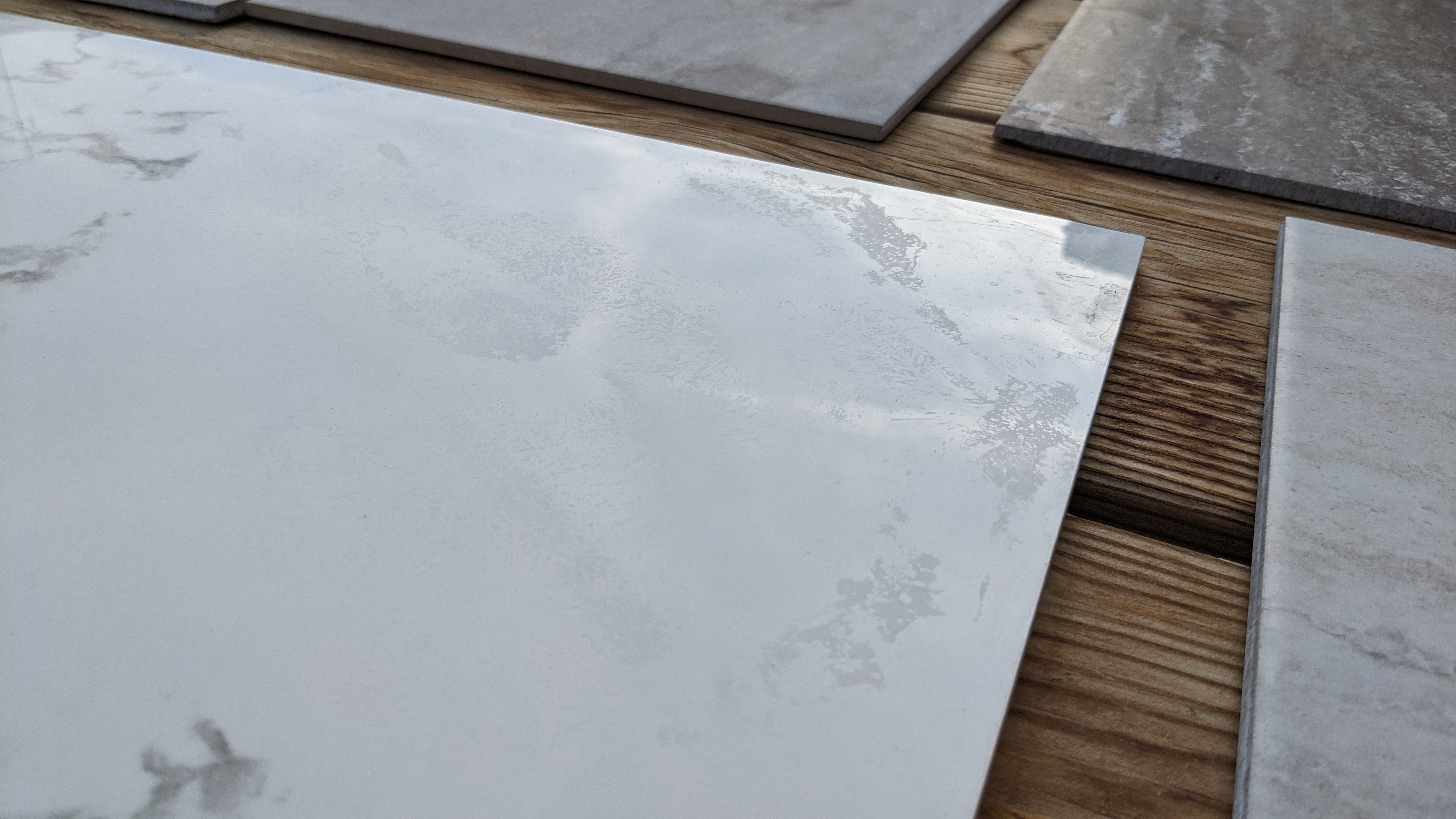

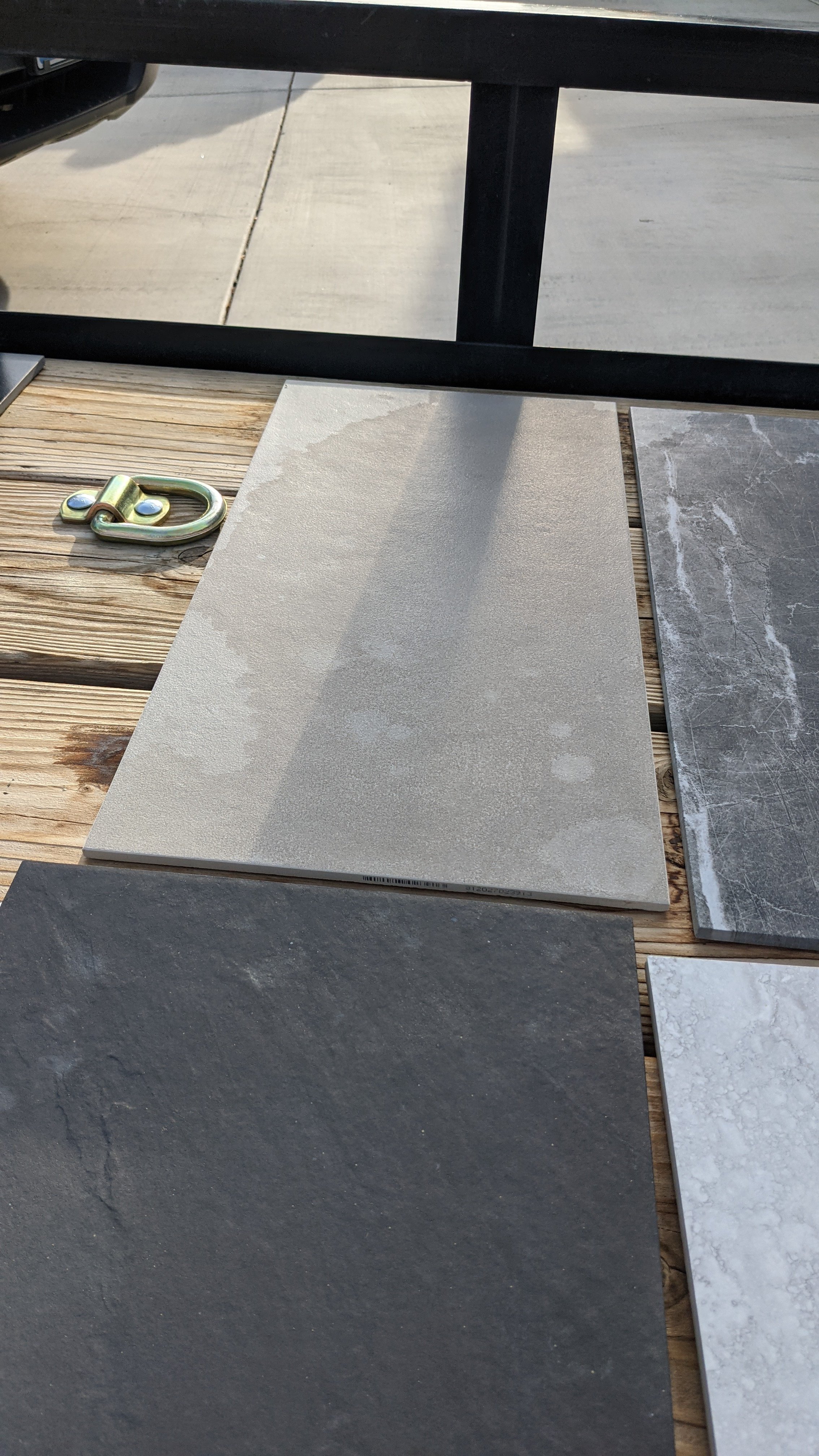

What Mark and I are realizing is the more applications of a powdered high ph cleaner we put on SOME OF these "new" porcelains, the more damage occurs, at various levels.
Much like LVP, we're thinking the wear layers that exist over the photograph vary in durability. Between what ever damage the home or business owner is doing and then us with our Super Dooper Grout Master Blasters, these modern age faux porcelains just can't take it.
Here is some examples of damage that if it were even across the whole tile and floor, no one would ever notice..
Testing continues, with correction and prevention steps coming as well.

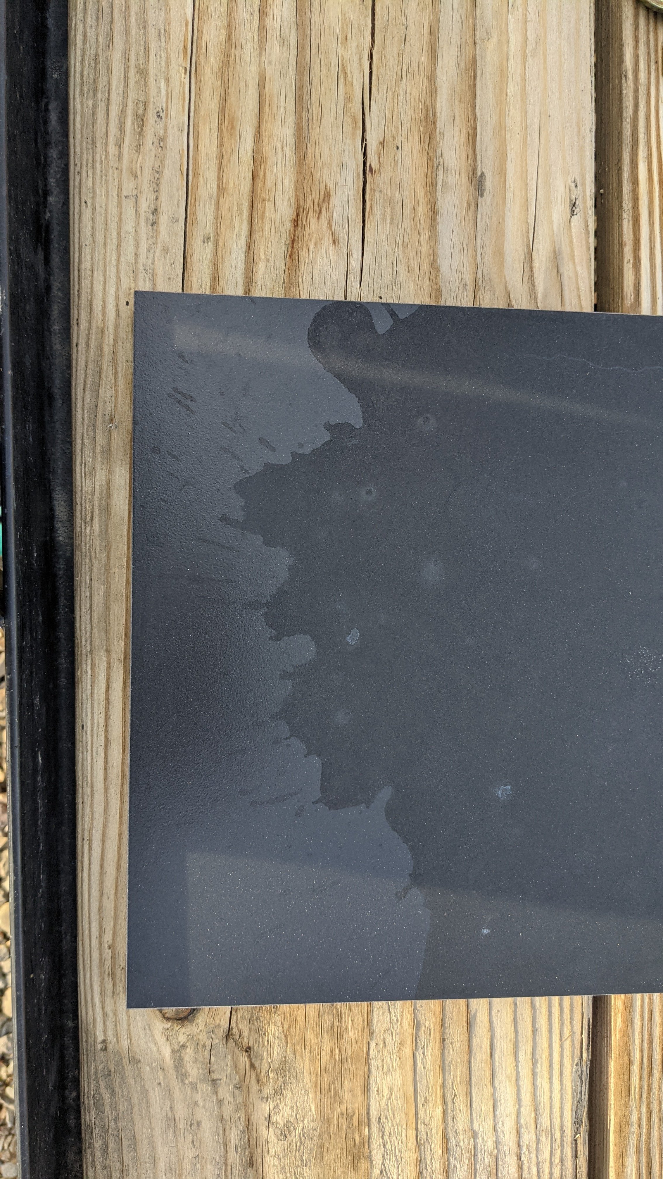

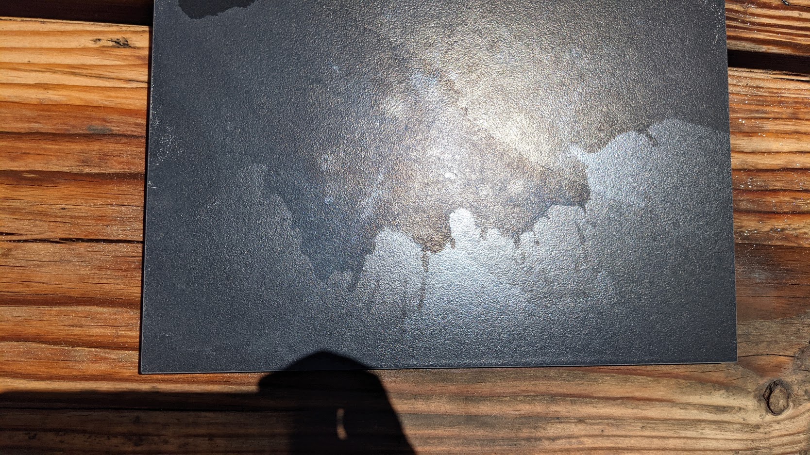

The black tile shows the damage the best in photos.
This pic shows damage from two different high pH powders
The more I mess with them, the easier it gets to damage the top coat.
