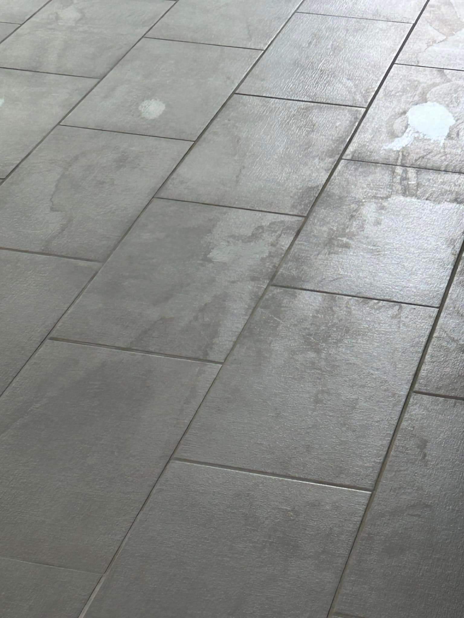

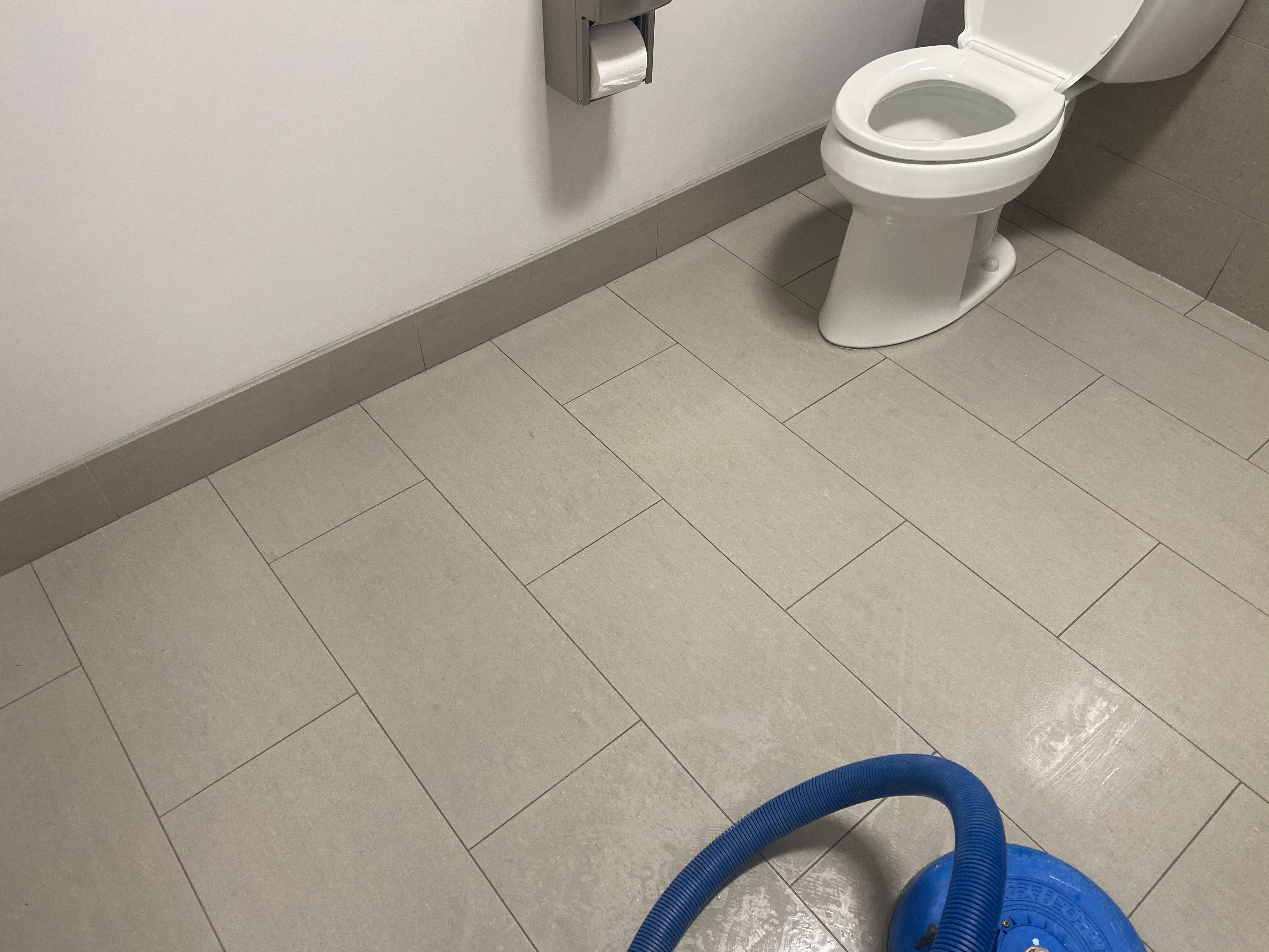

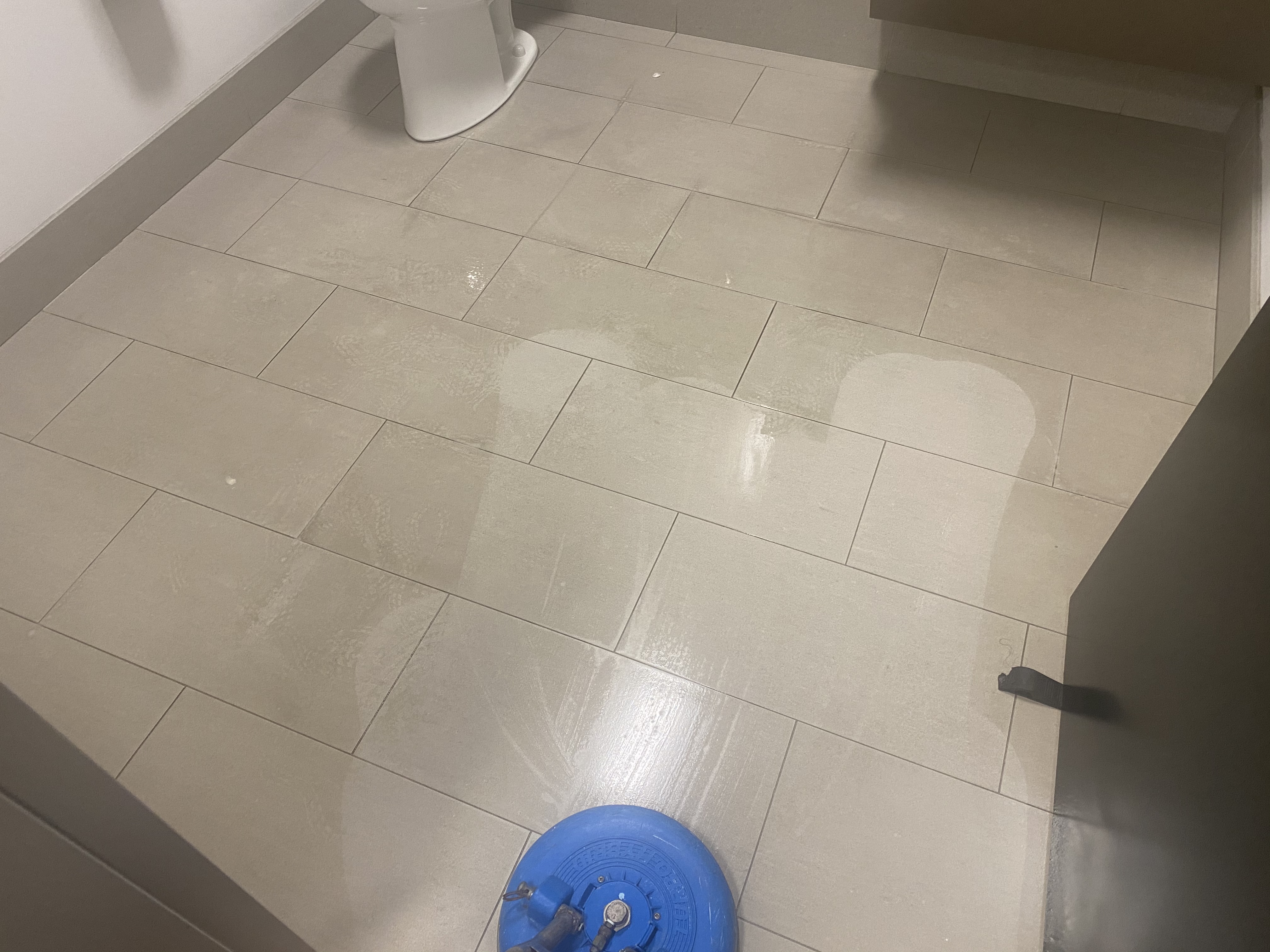

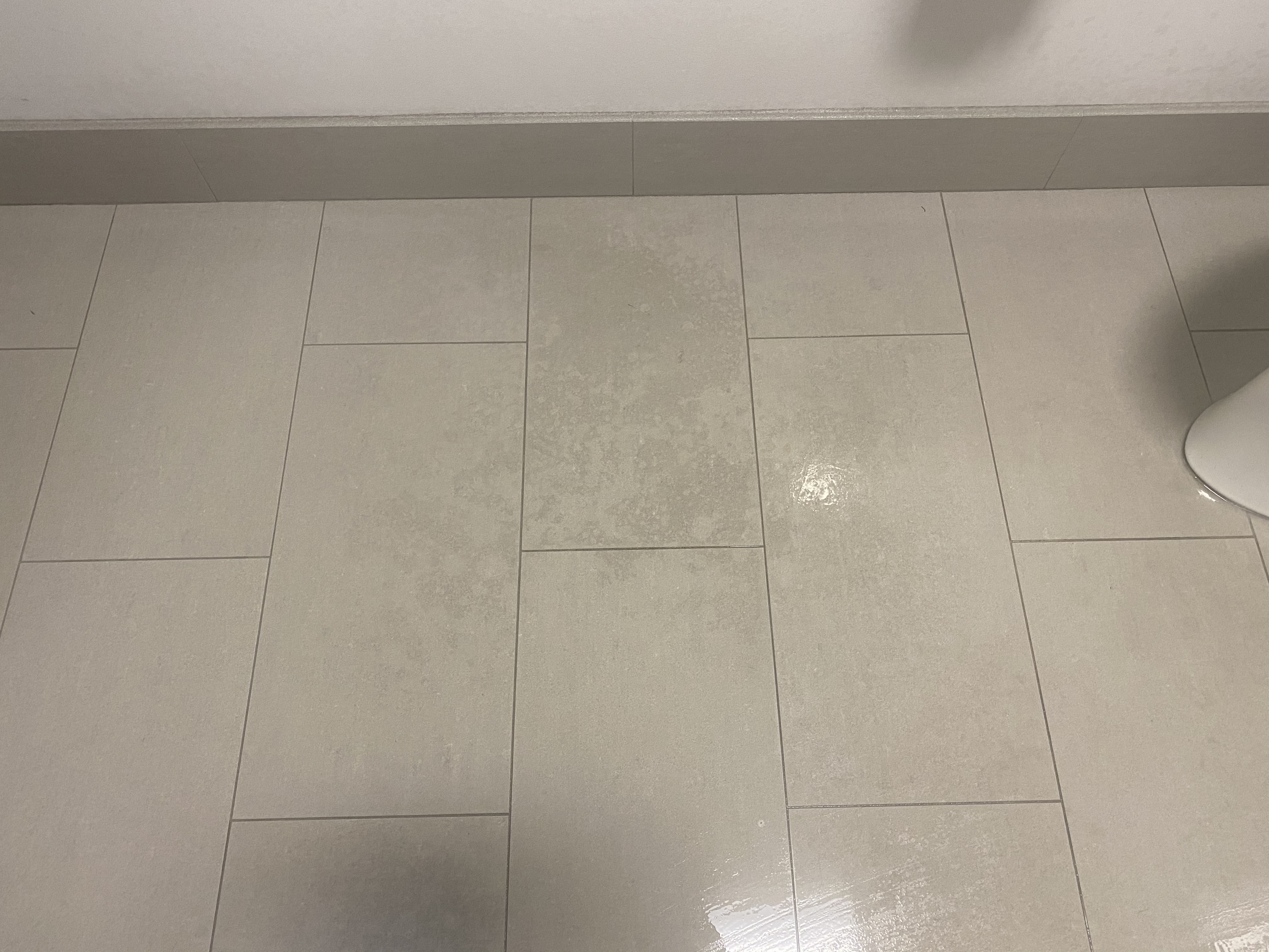

This was a commercial office with the same issue. The cleaning crew used something to clean and left spots all over. As you can see the cleaning was turning out great until I noticed the spots. I tested a portion with a neutral cleaner and it lifted up. You can see it most by the toilet.
7E2D09E3-1EB0-4891-ACD9-9639FB25787B.jpeg 5F299486-D0EF-4A8D-ACC1-6057123C8883.jpeg 0D7FFAB0-BE60-49AD-BB97-45DCAA4125F4.jpeg
