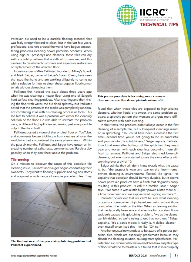

The professional cleaner needs to explain to the customer prior to cleaning the reality of their faulty flooring.https://mikeysboard.com/threads/the...ke-pailliotet-mark-saiger.298401/post-4765474
You can safely assume that any and all of the wood and stone look "porcelain" tiles and planks made within the last five years can easily be damaged by what we'll call "chemical burn" (splotchy, Rorschach like spots), heavy foot traffic, office chair wheels and sharp objects, etc.
In order to make the photograph of whatever the tile is attempting to mimic, the top protective glaze is applied as thin as possible to provide realism. The durability of this glaze is very poor.
In some cases an additional protective coating is applied to protect the glaze in the shipping process, this layer is easily damaged and can often be removed with just isopropyl alcohol.
Chemical burn typically happens in traffic lanes and pivot areas, where the glaze is already worn, so be sure to inspect prior to estimating/cleaning for pre existing damage caused by the homeowner or prior professional cleanings.
All semblance of what traditional (real) porcelain should act like, such as highly scratch and chip resistant as well as staining and wear resistance has been lost on these new faux porcelain products. Explaining this to your customers is crucial.

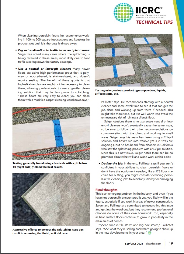

When cleaning stick with liquid cleaning agents in the 4 to 8 range on the pH scale. Remember, the tile itself cleans up with just a neutral cleaner, a light scrubbing or dwell time and a 300-400 psi rinse. You goal is to get the grout as clean as possible WITHOUT harming the glaze. Many modern installs will have been installed with polymer fortified grout which cleans up very easily, without extreme chemistry or PSI.
Work in small areas no larger than 300 feet at a time and DO NOT let your cleaning agents dry before rinsing.
Run an "all fiber rinse" type product through your truckmount at all times.
Do not use the plastic ring option on your spinner tool or any other tool that can potentially scratch the tile, including a Teflon glided carpet wand
Use a flat mop or bonnet to remove all standing water after cleaning.

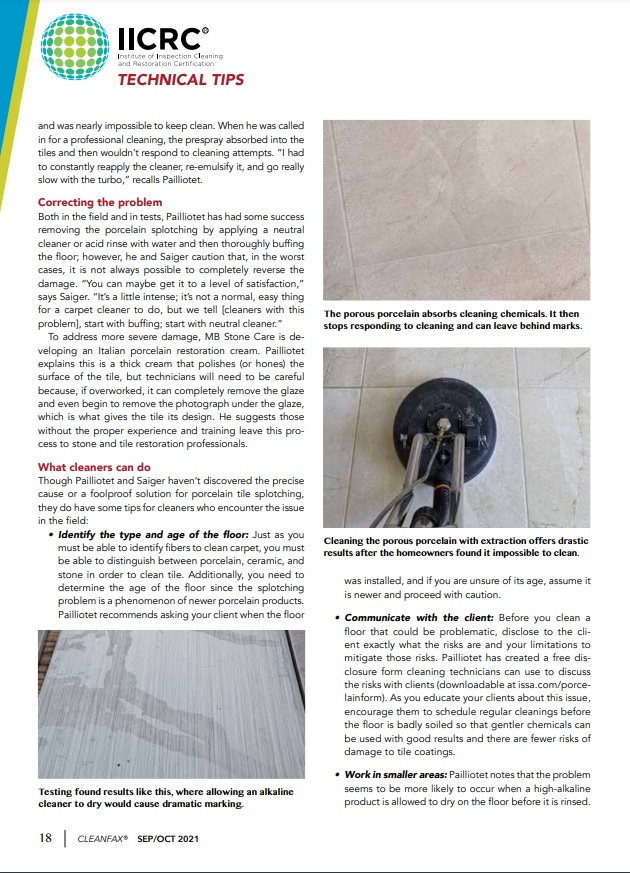

I did some testing on tiles that Ive severely tortured as well as on some that Ive just started to "eat through" the glaze today
Findings:
On some of the mat finish older/worn tiles I had to use componant#1 to even out the chemical burn, so it's not just for scratches.
#2 work quick and easy on new burns, especially on high polish tiles.
Reactions: Jim Pemberton
116,053
getting back to the fix...
Small burns can be fixed by hand with a fiber pad punch out and in lite cases, just a MF towel, and the cream (#2).
It's important to work #2 as little as possible and to keep it wet when scrubbing. Much like stone restoration, check you progress often.
If overworked, an un-natural polish effect can happen with #3, but unlike stone, you can not reverse this polish/shine.
If VERY over-worked by going to heavy and hard and letting the cream dry, you can reach and start to remove the photograph.
As for cream #1:
It does need to be worked wet to dry in order to remove(lite) scratches and extreme chemical burn
It too can be over worked and caused damage, so work "lite" with a hand held polisher or by hand with a punch out vs a 100# pound floor machine.
I have not had the need to use #3 yet.

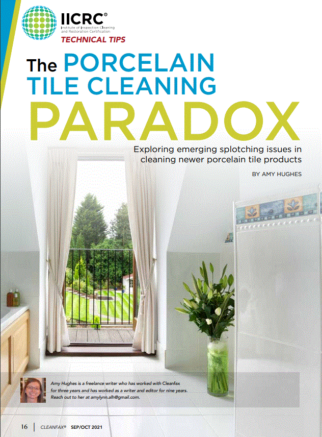

The Saiger/Pailliotet interview...
I have closely read the above article 2 times. On page 18, third paragraph, it mentions the porcelain restoration cream can remove the glaze and the photograph under the glaze. I am sure that would be possible, however, is not this issue found only in polished porcelain tile and not glazed or full bodied porcelain tile?
Also we know that around 75% of new carpet is polyester and around 25% is nylon. Do we know the percentages of full bodied porcelain, glazed porcelain and polished porcelain tile? We know it is recent so is it 1 out 0f 8 (?) new floors, and non existent before 2018. So with the longevity of porcelain tiles we may run into this phenomenon 1 out of 30 (?) floors with new homes built in the last three years being the most likely danger zones.
On page 18, fifth paragraph do you identify polished porcelain through its porosity or absorption of water? Will it abrade or scratch more readily? At this point age but are there any other identifications? IPA rubbed over tile may remove weak finish? Any way it is an intriguing topic at least to me as there appears to be a lot more to learn on the topic. Good start!!
116,053
yep, if worked too long wet to dry and with too aggressive a pad.
Most blemishes issues can be fixed BY HAND with just a white pad and the cream. A 175 would be used for efficiency
I doubt anyone outside of China would know that true number..
I would say 8 out of 10 wood or stone look porcelain planks are junk
yes, far more easily.
unfortunately there is no quick chemical test as it typically takes many exposures to our Sodium metasilicate and percarbonate to damage the glaze
I have not seen this 1st hand. I would guess IPA is removing the protective coatings that are applied to protect tiles during shipping
Reactions: Tom Forsythe
